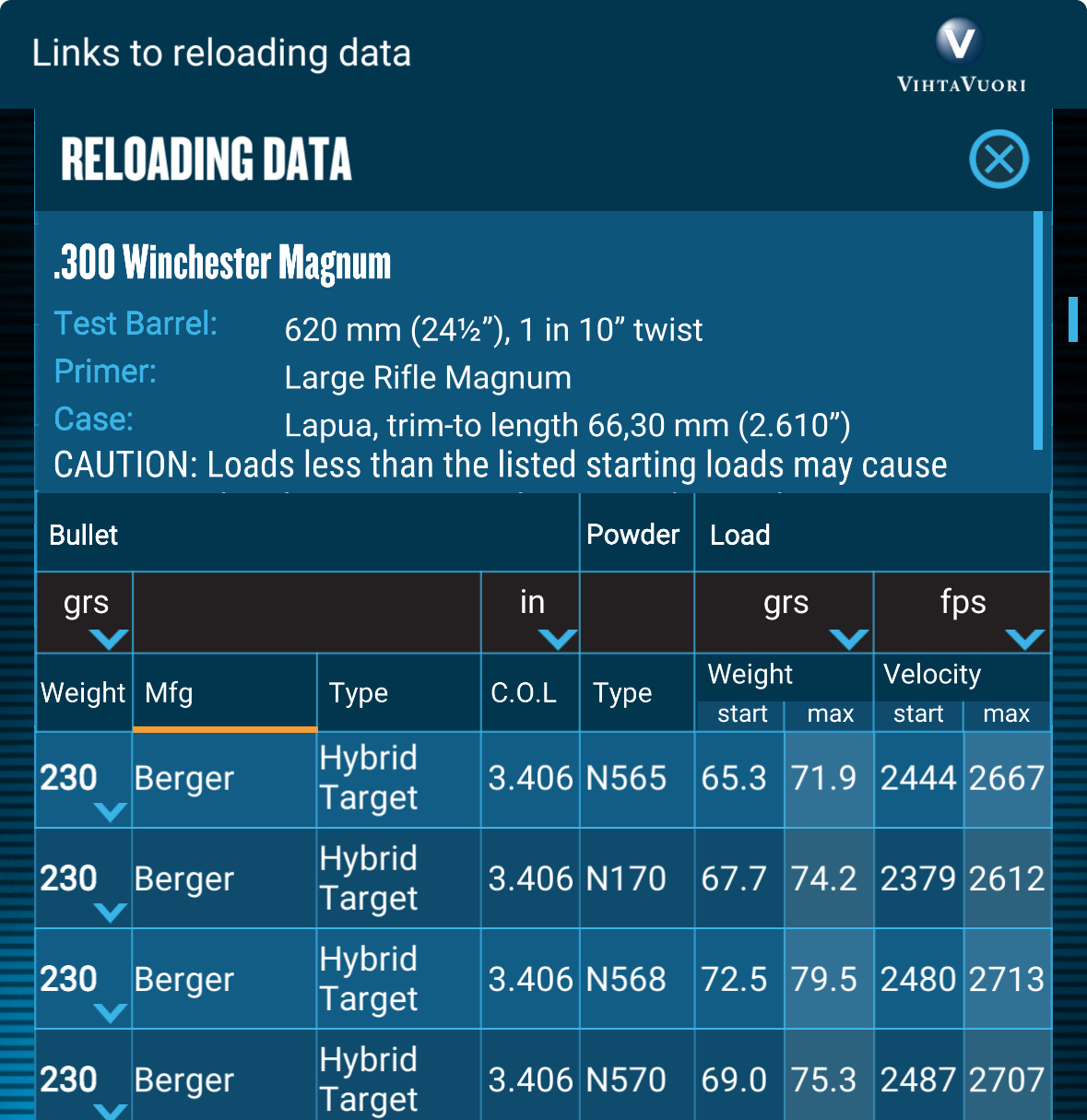

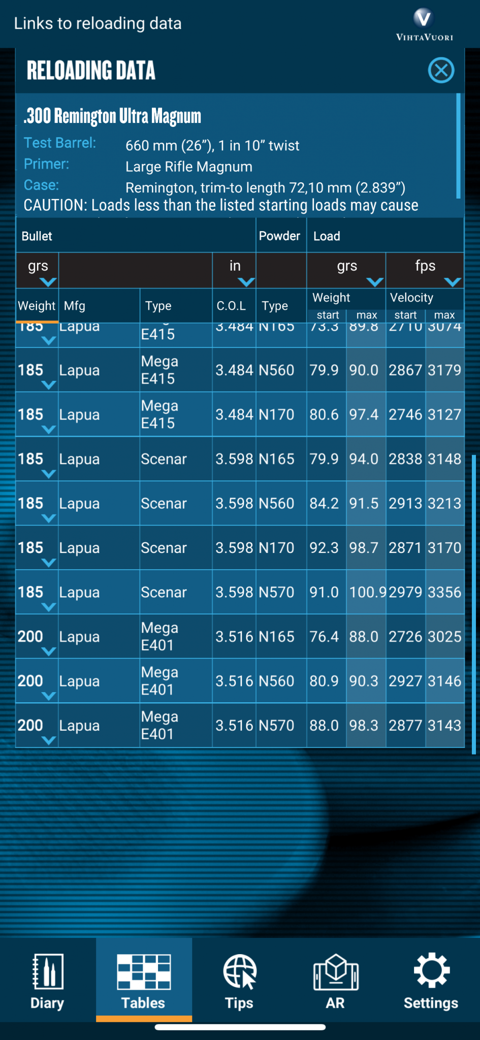

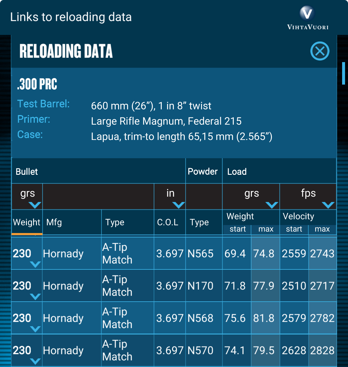

Here’s what VV has in their app. Berger and VV are both capstone companies so if you call they’ll probably give you 230 Berger data for all 3.
