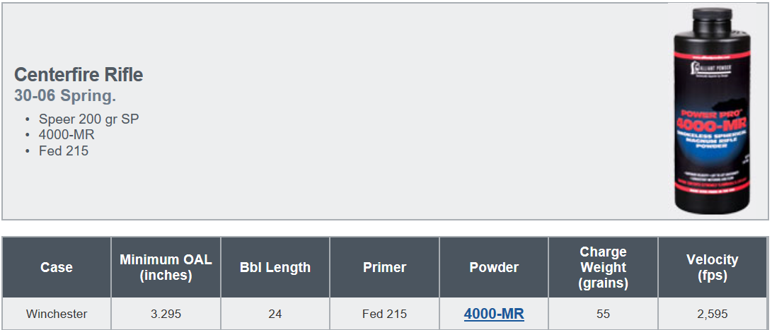

    Anyone messed around with 4000MR? I know that 2000MR meters like water in my dispensers. My speed of seating bullets is the limiting factor when reloading 308.
    I will probably give H4350, H4831sc, and 4000MR a chance when I get the rifle barreled.
    Currently Alliant is showing this for 4000MR and their data is notoriously conservative.

    Hands down 4000MR. I've used it with Hornady 200 gr. ELD-X with excellent results, producing .5 MOA and 2781 FPS out of a 26" barrel. My rifle did not shoot 210 Bergers well with this powder, for those I had good results with H4350 but with velocities in the mid-2500s.
