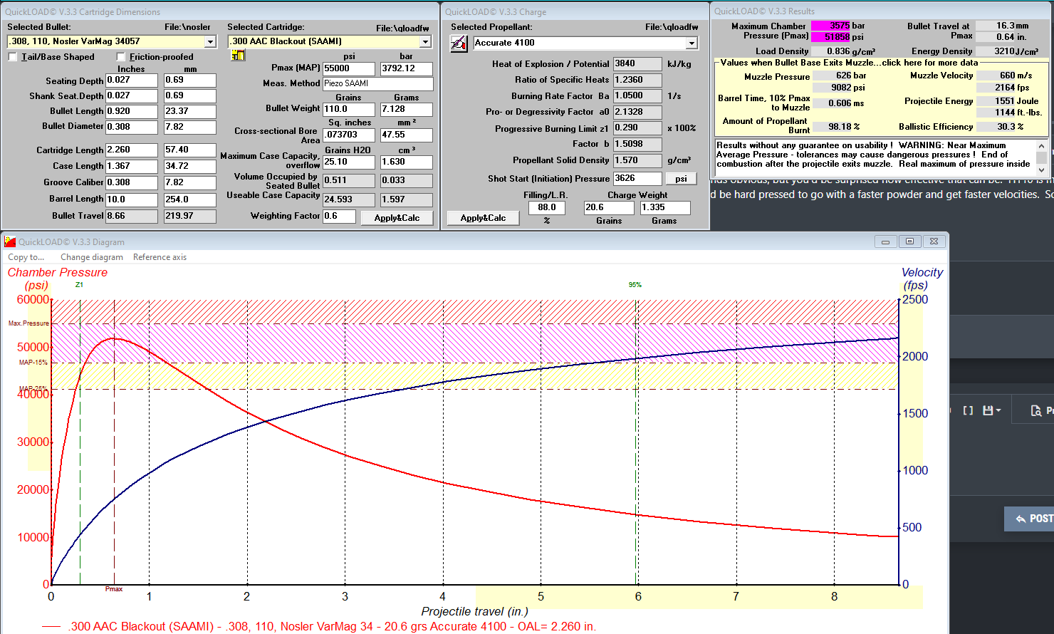

QL has the H110 burn rate factor as 0.8000 but to make the QL velocity match the measured speeds I need to up this to 0.95. This may be due to H110s temperature sensitivity, recently its been 95-100F.
Using burn rate of 0.95 QL shows that with 110gr projectile I can use 17.5gr of H110 while staying barely below 50k PSI. This produces ~1750fps at muzzle.

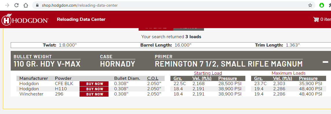

Hodgdon's online load data shows 18.4 as a starting load.

I ran the QL numbers for 4100 and CFE Blk powders mentioned in this thread. 4100 produces speeds very similar to H110. CFE Blk shows >50% unburnt powder from a 5.5" barrel so it looks like a good candidate for longer tubes.
Lil'Gun looks interesting, QL shows that very high 1800s are possible from a 5.5" barrel using the Hornady 110gr bullet and 21.8 gr of powder. I found Lil'Gun available online and now I have some coming. It's still not the same as the Hornady mystery powder but improvement over H110.

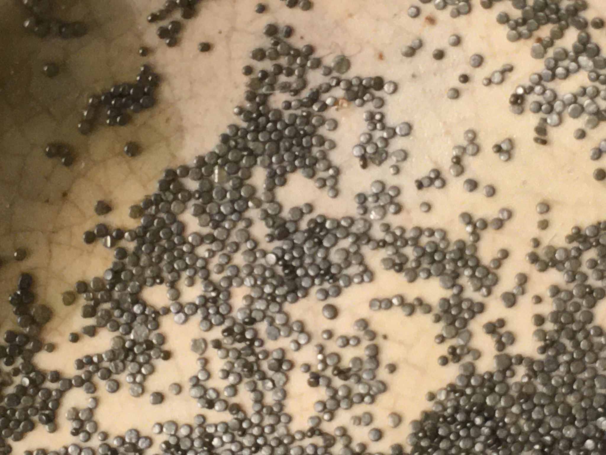

Picture of the powder in Hornady Black load attached. This looks like miniature silver coins.
Could not find a visual match in Forensics Science Center's powder database
What the …..forensic science database had no idea

However Enforcer looks very different from the powder in Hornady loads.
