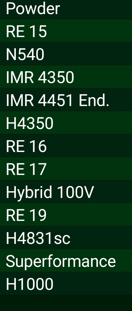

Here are some general powder choices IMR 4451 Enduron, H4350, IMR 4350, Shooters World SW4350, Reloder 16, Reloder 17, Reloder 23, Reloder 26
Also......
This is from the Sierra Manual for their 150 SMK in 6.5 Creedmoor
