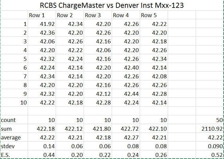

If you follow the OCW technique, you are supposed to find a powder charge that delivers the same group size and point of impact even if the charge varies plus ot minus 0.1 to 0.15 grains. I tested loads on my Chargemaster. I had it measure 50 charges then I weighed it on a scale with 0.02 grain resolution (Denver Instrument). Graphic attached.

Good info Thanks so much!
