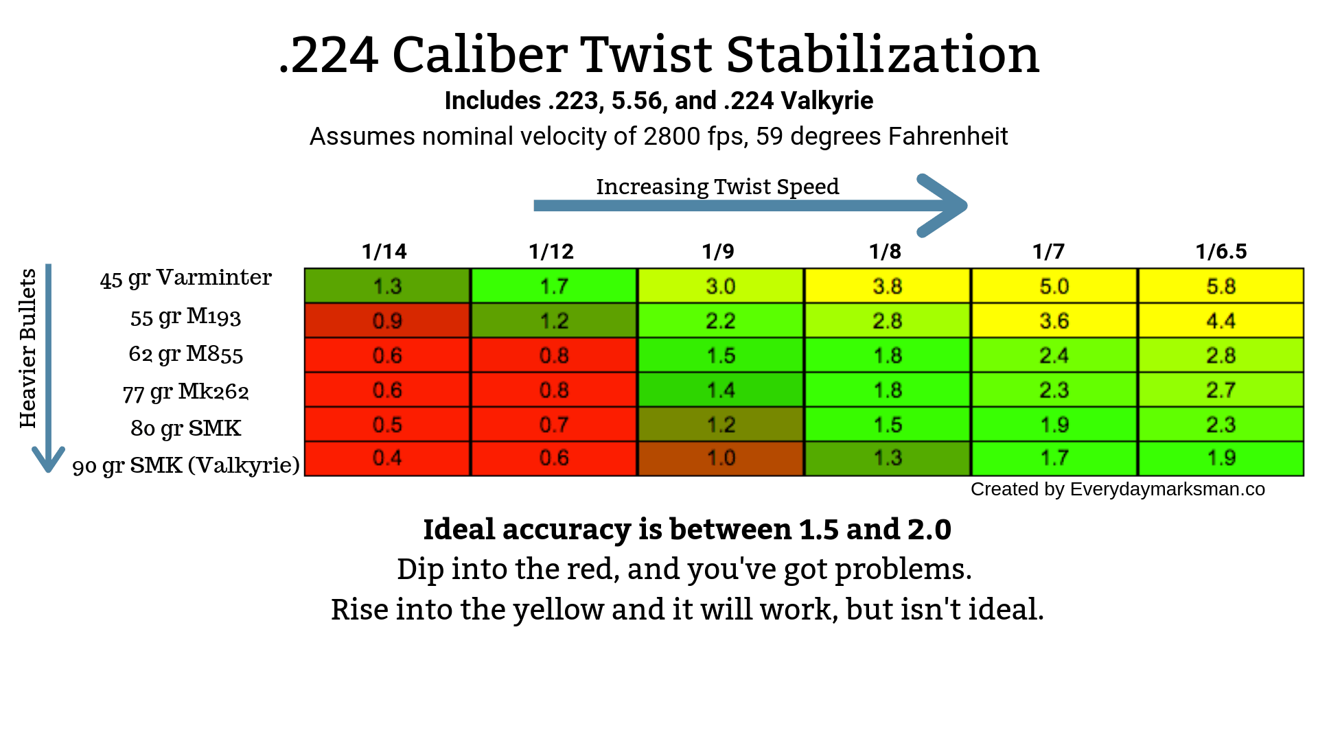

You are probably have a fast twist rate barrel that likes higher weight bullets.
I get same results from Wolf Gold in every one of my rifles. It's more of a high volume carbine class type of ammo. I don't really have any consistent 1 moa or better factory ammo that you don't pay for-mostly MK262 type 77gr stuff and some 69gr stuff like Australian Outback, Magtech, Hornady Black etc.
My 1:8 rig likes the 75gr wolf gold or the PPU 75gr match.

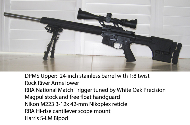

I have a precision "Franken" AR-15 (built by a friend) with a 24" 1:8 bull barrel. I can get sub-MOA groups with it with factory ammo. But, the ammo costs more than your 50 cents / rd threshold. My AR likes Federal Gold Medal Match SMK 77-gr ammo.

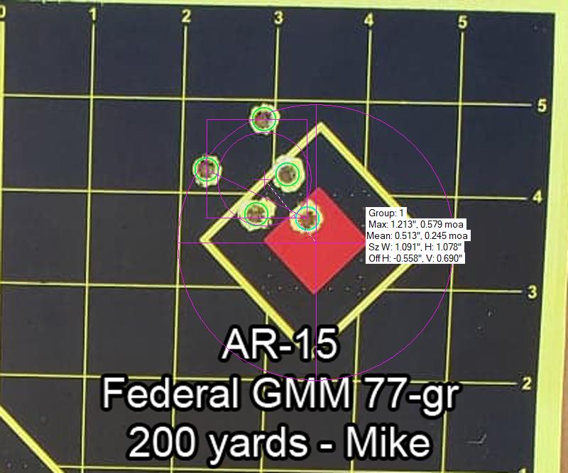

Here's a recent (last month) sub-1/2 MOA group by my daughter at 200 yards with my AR and factory Federal GMM 77-gr
Same day by me:

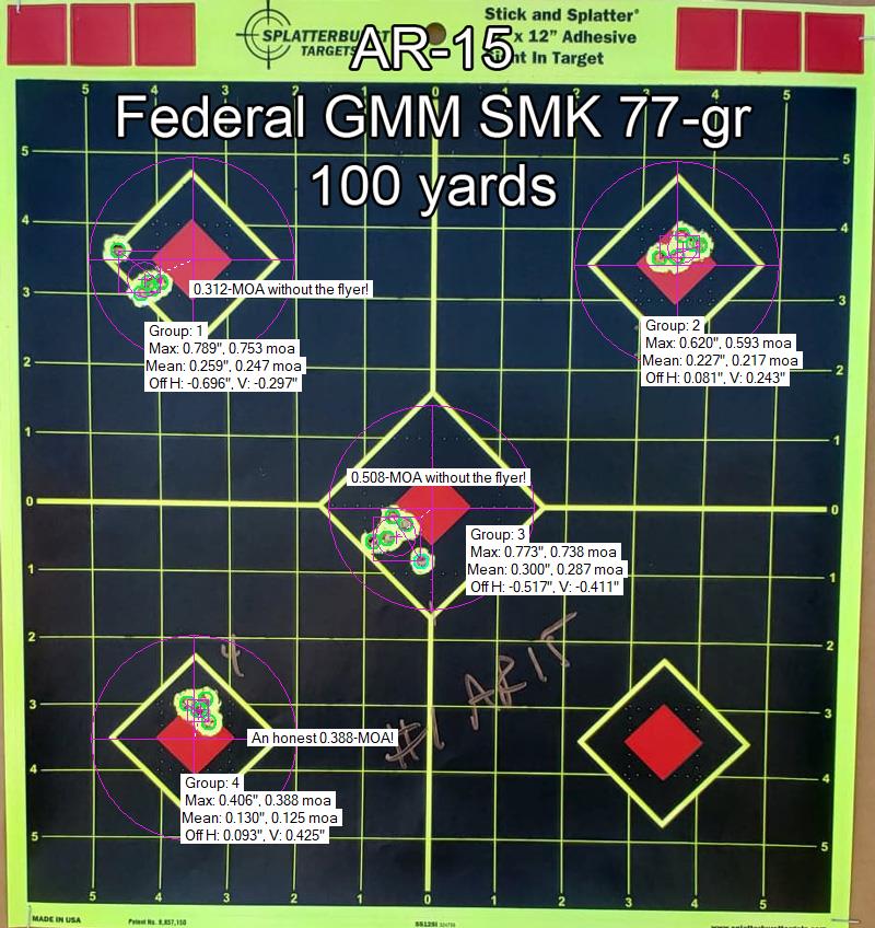

Here's a 100 yard target. Four 5-shot groups, all sub-MOA. One of them was an honest 0.388-MOA!
I don't think you're asking too much of factory ammo. Just too cheap! ;)
Get yourself some of this ammo, if you have a twist rate fast enough to stabilize it... 1:8 or 1:7.
You’re tight, it’s 1:8. Thanks for the diagram, I’ll try some heavier bullets
Same day by me:

Thats all good but you forgot to mention the part about fast twist barrels shooting light bullets great. Just gotta stop using shitty light bullets then blaming the twist.
My DD and Fn barrels mentioned above are 1/7. Another upper I have is 1/7 and shoots Fiocchi 55 fmj under 1 MOA. My other AR is 1/9 and shoots better yet with Hornady 55 steel match ammo but I don’t think they make that anymore

Also wanted to note I like how the graph above says assuming a nominal velocity of 2800 fps. Yet lists M193 which has a nominal velocity of just north of 3200 fps. Just say'in.

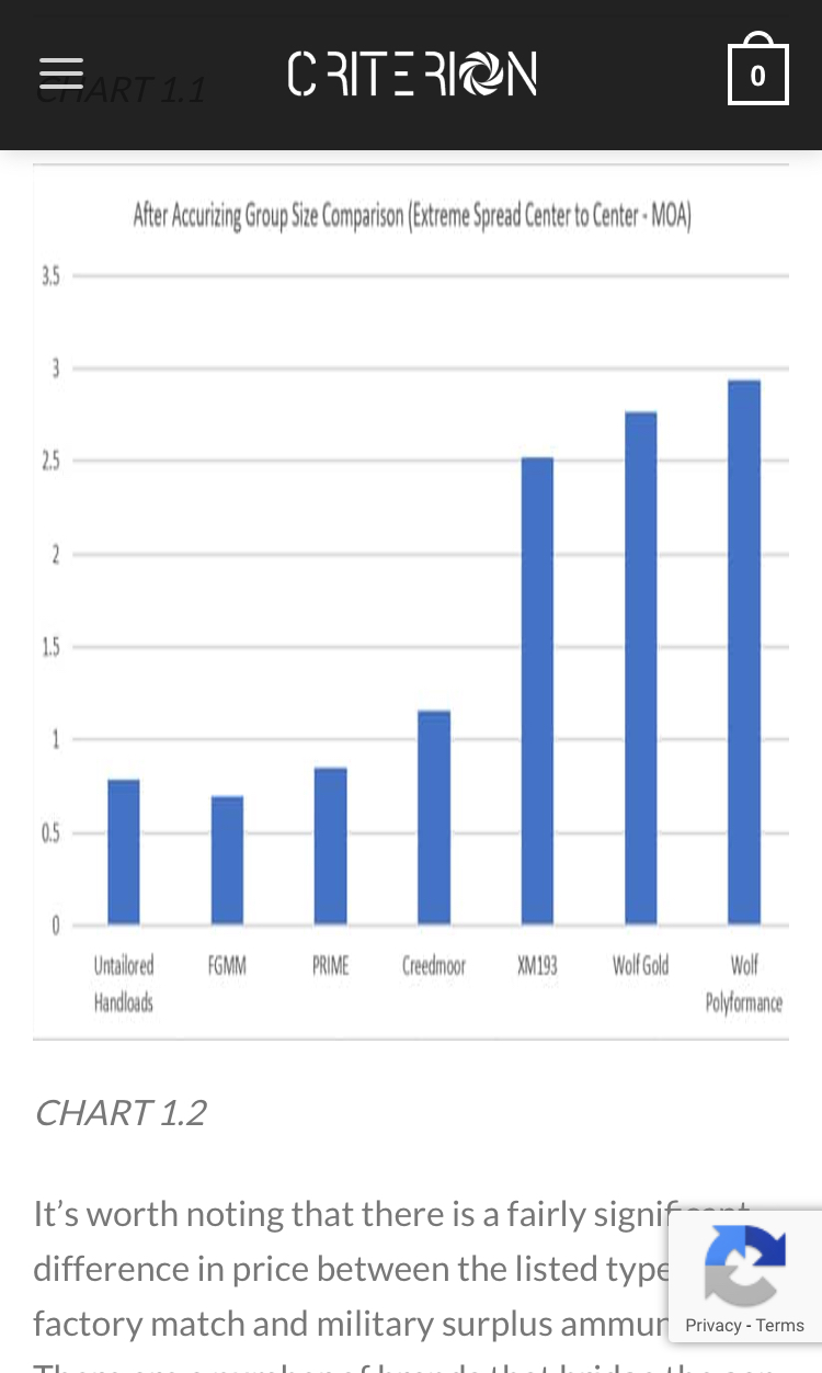

Criterion did some tests on various rounds, and Wolf Gold ended up grouping at 2.5-2.75 MOA.
^ I think that’s a fair article and mirrors my own experience.
