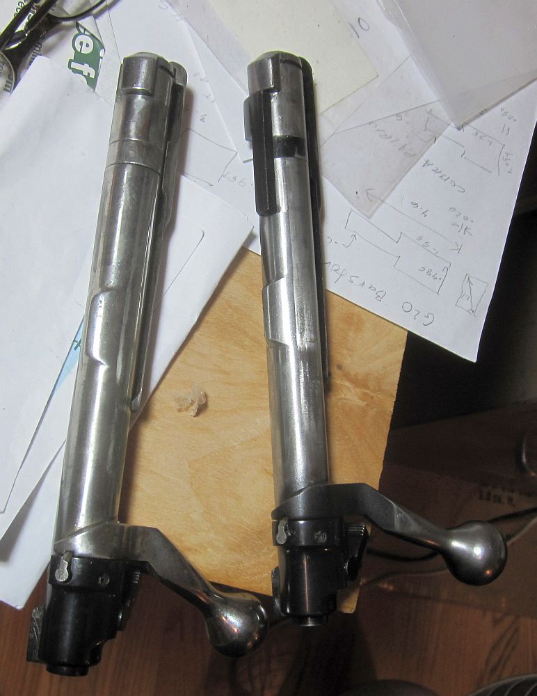

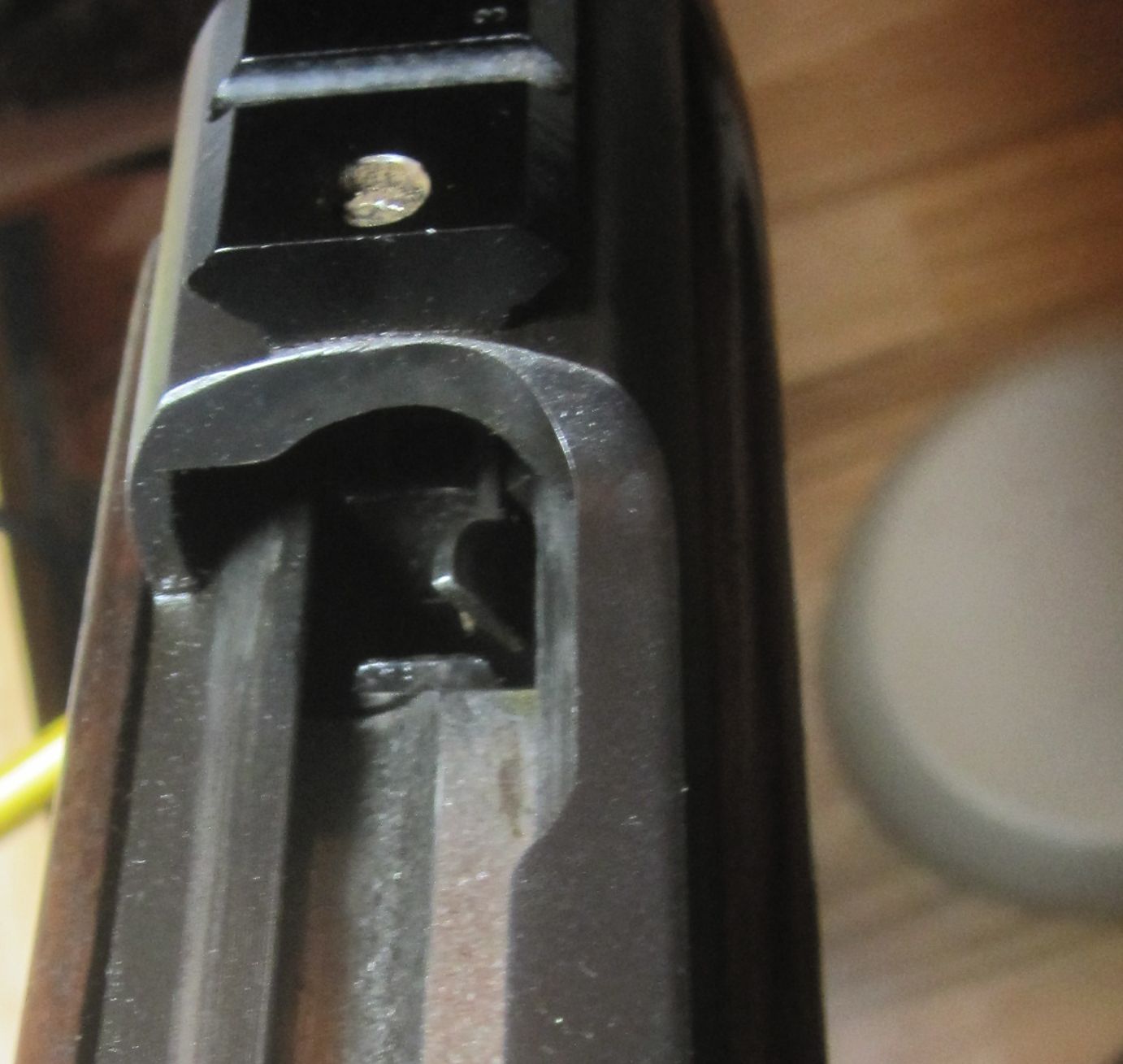

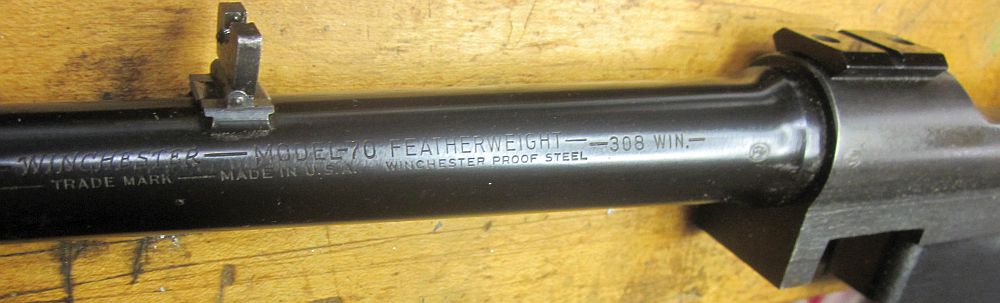

I have a pre 64 in 270 and one in 308.
The 308 has the magazine blocked off to be shorter.
There is a spacer on the bolt.
There is longer ejector.
M70 1953 1-5-2012.jpg1953 M70 Featherweight 308 left  has spacer, 1956 M70 Featherweight 30-06 right, does not 1-8-20.jpg1953 M70 Featherweight 308  has spacer at back of magazine and  long forward leaning ejector 1-8.jpg
