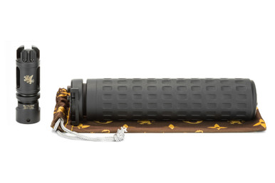

if youre considering Griffin....
Reactions: NWnewguy
