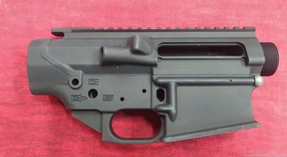

A matching set of Diamondback receivers is less than $300.

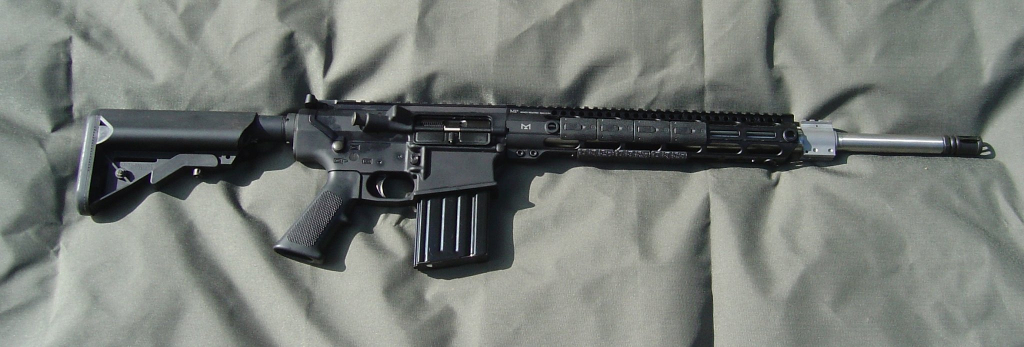

I built my son's Camp Perry rifle one-piece-at-a-time:
