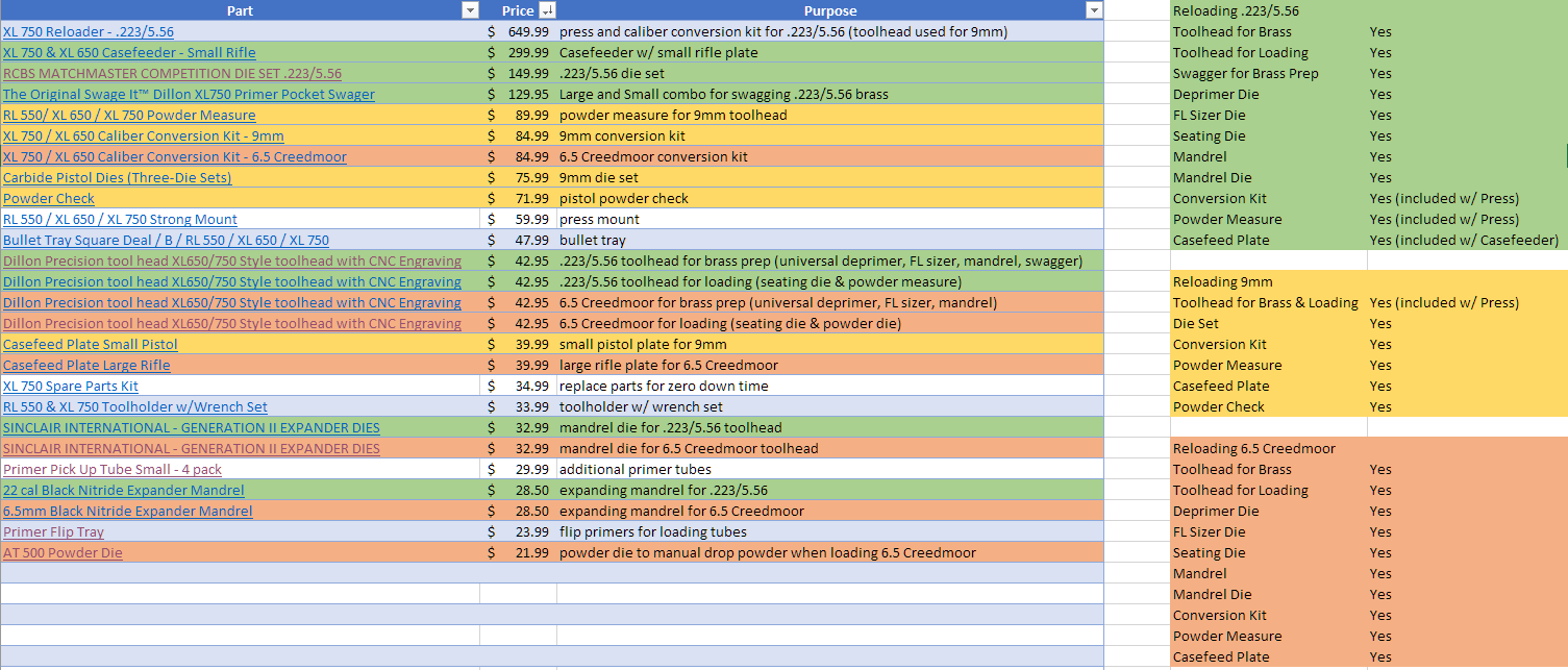

Am I missing anything to reloading 6.5 Creedmoor, .223/5.56 & 9MM?
I already have 6.5 Creedmoor Dies & Universal Deprimer for both tool heads.
I plan on getting the Roller Handle from Inline down the road. The strong mount is Inline's mount just sold on Dillion's website too.
I currently use the Lee universal decapper so I'll get replacement rods/pins to go with it.
I would recommend getting the mount system from Inline and getting his quick change system, especially if you have two presses or plan on getting a second press at some point. You can also get quick change systems for all sorts of other stuff that work on the same mount, like a vice, case trimmer, etc.
Also, you have two powder measures listed, the press comes with one if i'm right. I'm assuming you were gonna use the powder measures for 9mm and bulk/comp .223?
The roller handle is a great investment lol, substantially better than the standard ball handle.

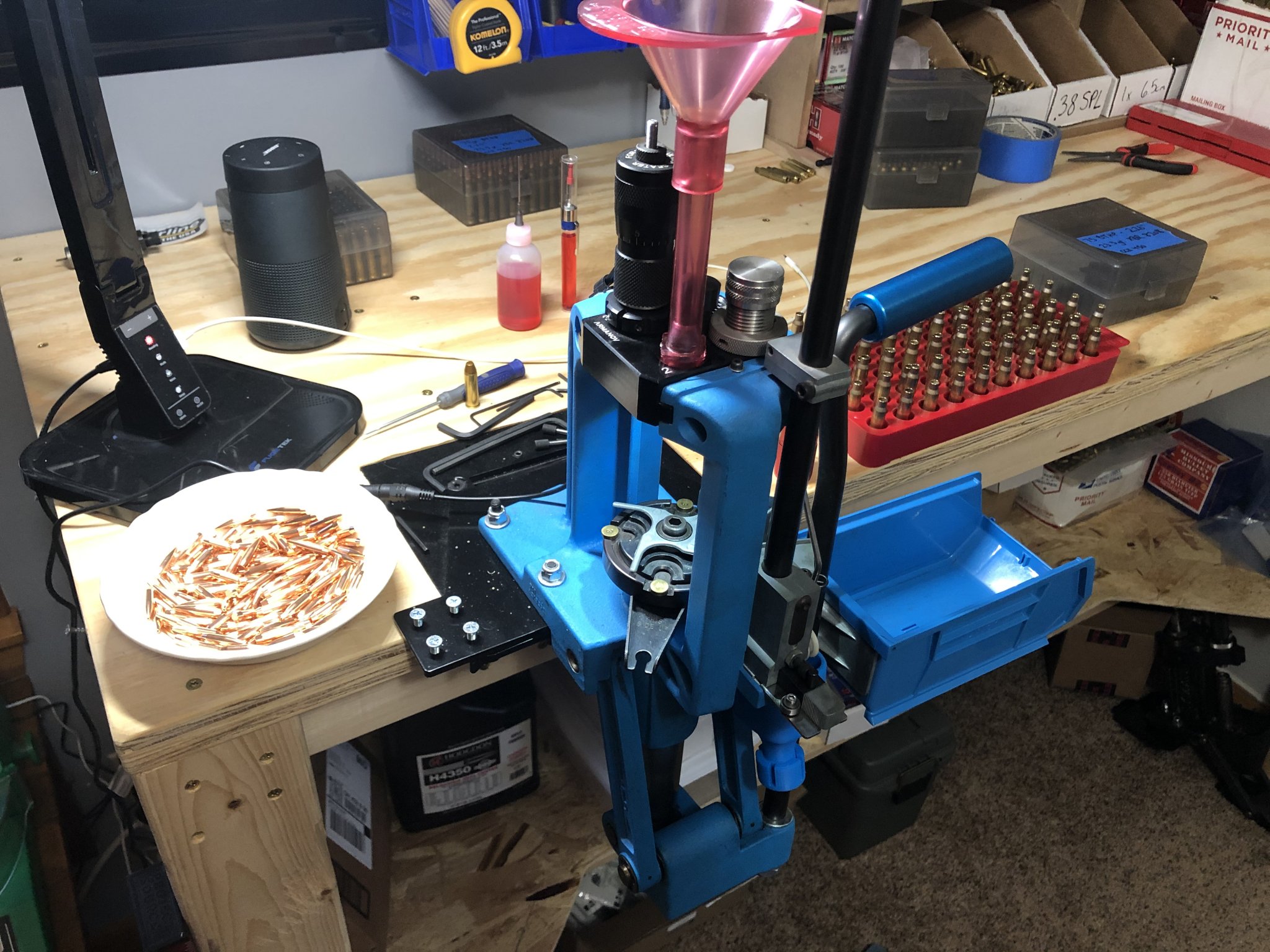

Heres my setup with a two die system on my 550 for precision .223/6.5cm....

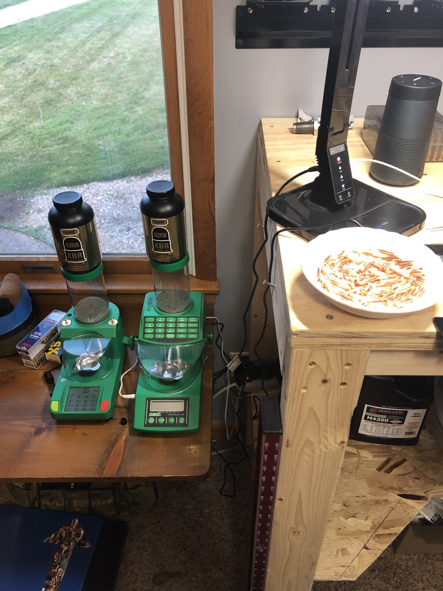

@Gustav7 one powder measure is for .223 and the other is for 9mm. For any precision loads, I will hand drop on the press. Which it looks like you don't even use a die for?
You mandrel while seating vs. when doing brass prep?
No I don't. I already had the MTM funnel kit which was super cheap. I shaved off the corners on the last piece that attaches to it, and it slides down into the die hole on the toolhead perfectly, but is stopped by the 4" drop tube piece. 75% of the time the shell comes right up and lifts it up straight. Sometimes I have to readjust it, but either way, I leave the ram at the top, grab my pan and hold the funnel and drop the powder. I don't get any bridging of powder obviously with this method and it seems to work great for me. Leaving the ram at the top also helps stabilize the neck of the case on the mandrel and "seems" to give me more consistent neck tension... it definitely doesn't hurt.
I've read a few different places about variations in brass spring back. Right now, I use the mandrel on the prep toolhead AND the seating toolhead. On the prep toolhead I'm running pretty quick, and then the brass sits for a long time. This could allow brass spring back to effect different cases differently, so then I use the mandrel 10sec before seating as well and this seems to give very consistent neck tension and doesn't allow enough time for any lagged brass springback.
Just my take on it all. The dual chargemasters work great. The Chargemaster Lite is factory and runs great, the Chargemaster 1500 i've messed with settings ALOT and have gotten it to throw very fast, and very consistent with XBR 8208 and H4350.

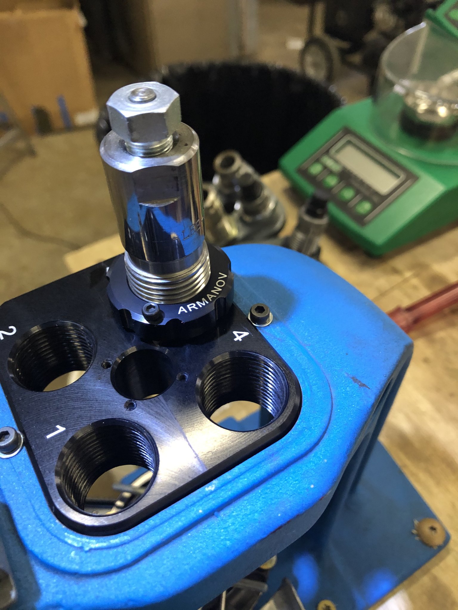

@Gustav7 and you don't "float" anything either? Have you noticed any significant runout not using a floating tool head or orings?
It’s clamped and floated. I’m using Armanov clamped tool heads with floated dies. They’re made very similar to the Whidden/Uniquetek floating/clamped, but you can float any of the 4 die positions.
So what I do is, leave the tool head loose, run my normal process until there’s a case in the two positions that are being used. Seat my bullet and leave the ram at the top, and lock the tool head into place. Then the tool head is locked into the same position each time with cases in each die, but each die (in this case the seating die) is floated so it can center and adjust itself as needed. I don’t measure runout but seating depth consistency is really good so far. I’ve only done a few hundred rounds with this method.
I attached a picture of the armanov tool head. Much cheaper than the Whidden/Uniquetek combo, and I like it so far. As to whether it actually makes a difference, not sure yet. I do plan on making a few hundred rounds this way then a few hundred the standard way and see what difference there is

@Gustav7 thanks for sharing! Let me know what you find out. I'll look into those toolheads.
Ya no problem. If you have any more questions or wanna video chat to see the process or something just PM me.
I'm not sold on the toolheads yet. I can see where they may benefit ... IF ... the normal setup is not producing consistent results on target. Its the same discussion between a powder measure and something like an AD120 setup... sometimes it makes the difference, and sometimes it doesn't.
