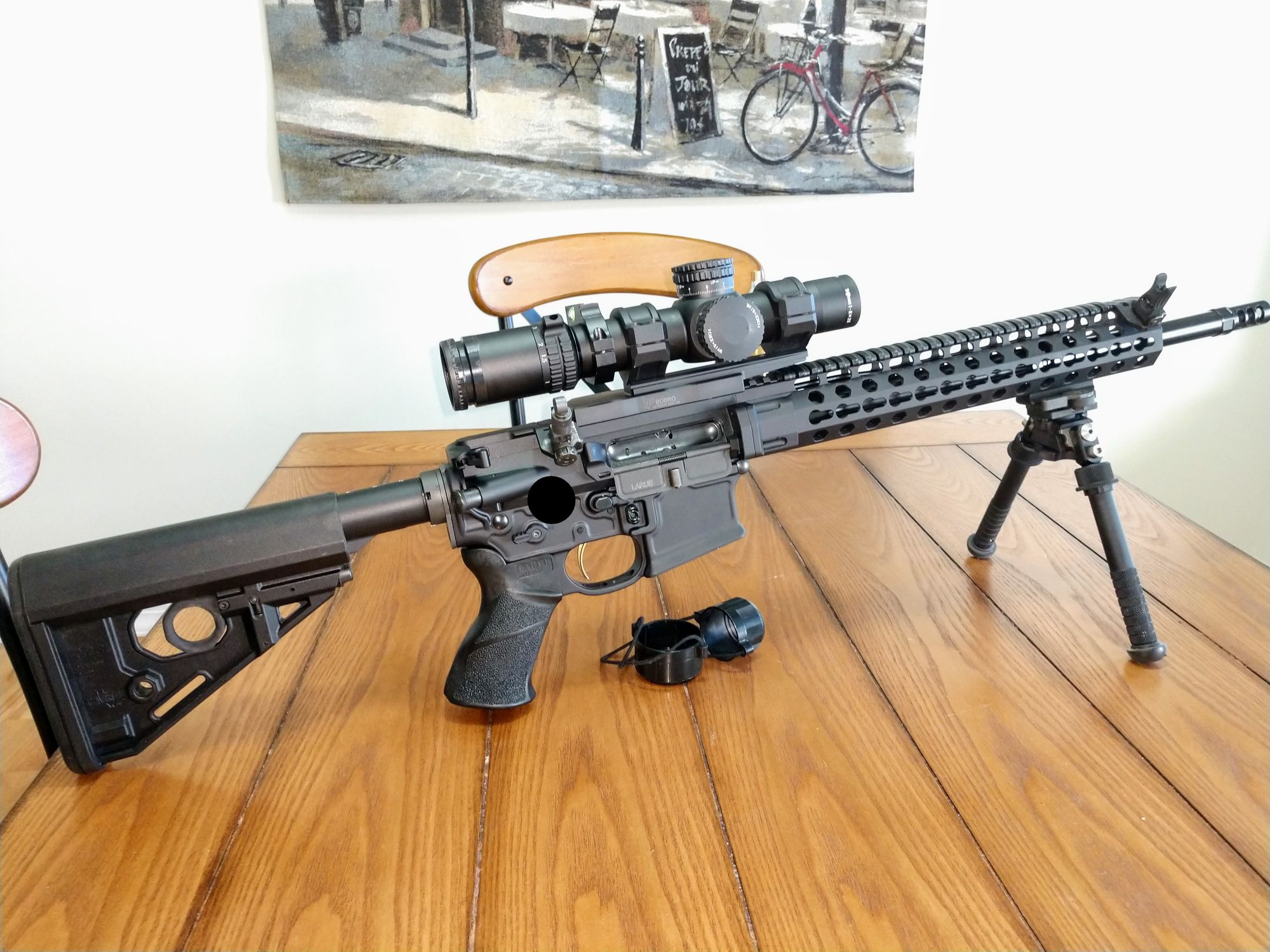

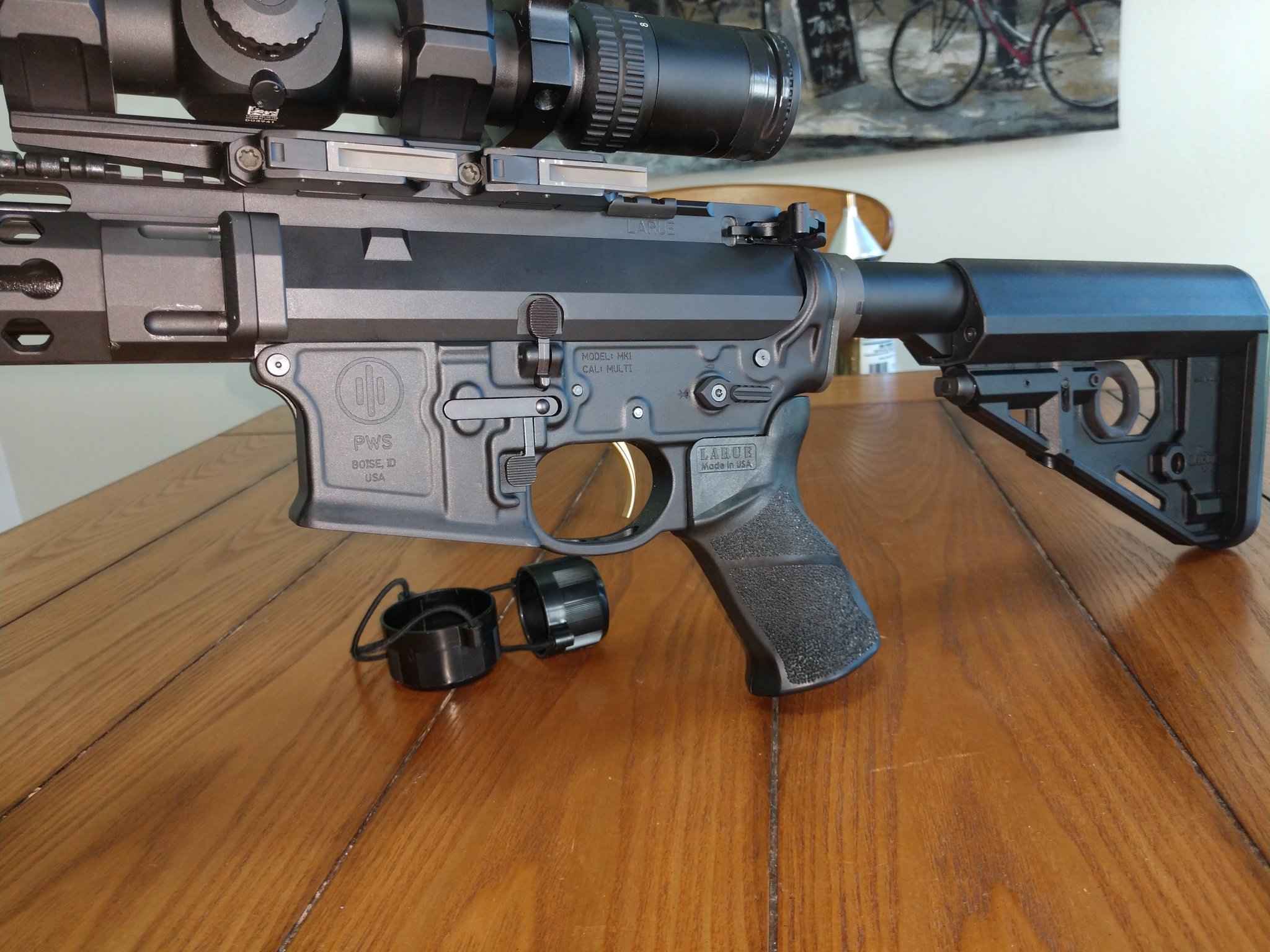

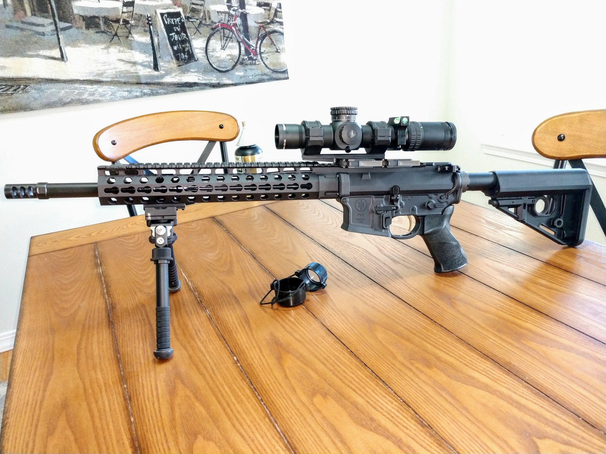

    Full Custom Recce Rifle.
    This is how I've built my most accurate recce rifle to date. It's a true .25 - .5 MOA Rifle.
    The LaRue Upper Receiver/ Handguard system will accommodate anything from 14.5"-20" barrel with rifle length gas and a Max .875 AGB (SET SCREW ONLY)
    so the below specs can easily be used to build an outstanding DMR Rifle.

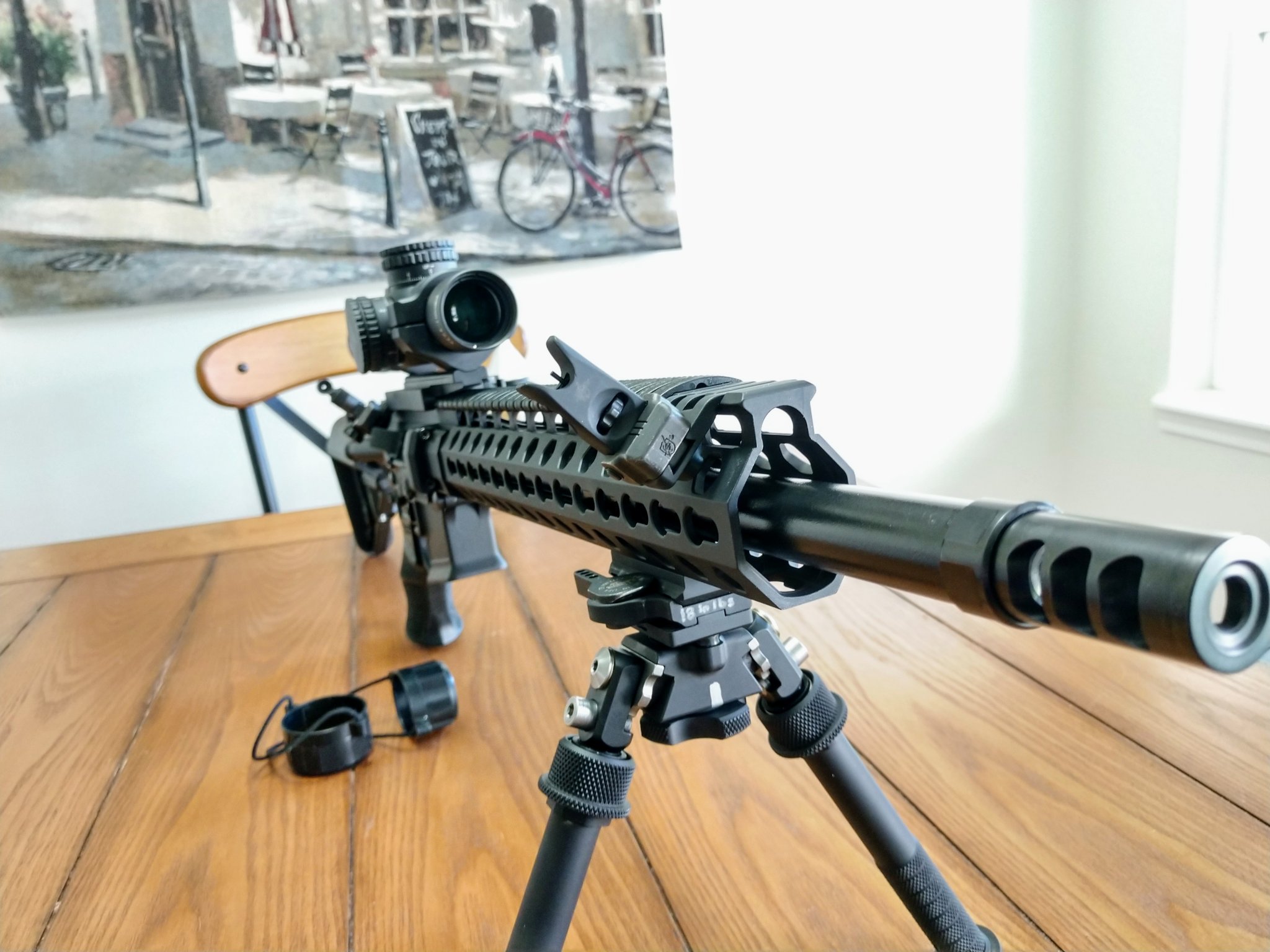

    Custom Hybrid Contour 16" Krieger Barrel fluted, 1-7.7 Wyde Chamber, 9/16 Threaded, and headspaced by Compass Lake to a JP enhanced Bolt. Before the barrel extension that I provided was threaded onto the barrel it was polished to a mirror finish, feeds without scratching brass or projectiles.
    In the past year and a half with all the builds I've done this Barrel contour has produced the best Barrel harmonics, and with the 9/16x24 threads it keeps the heat distribution even.
    Fully Adjustable Mid Length gas system.
    American Precision Arms muzzle brake.(very effective and easy to install)

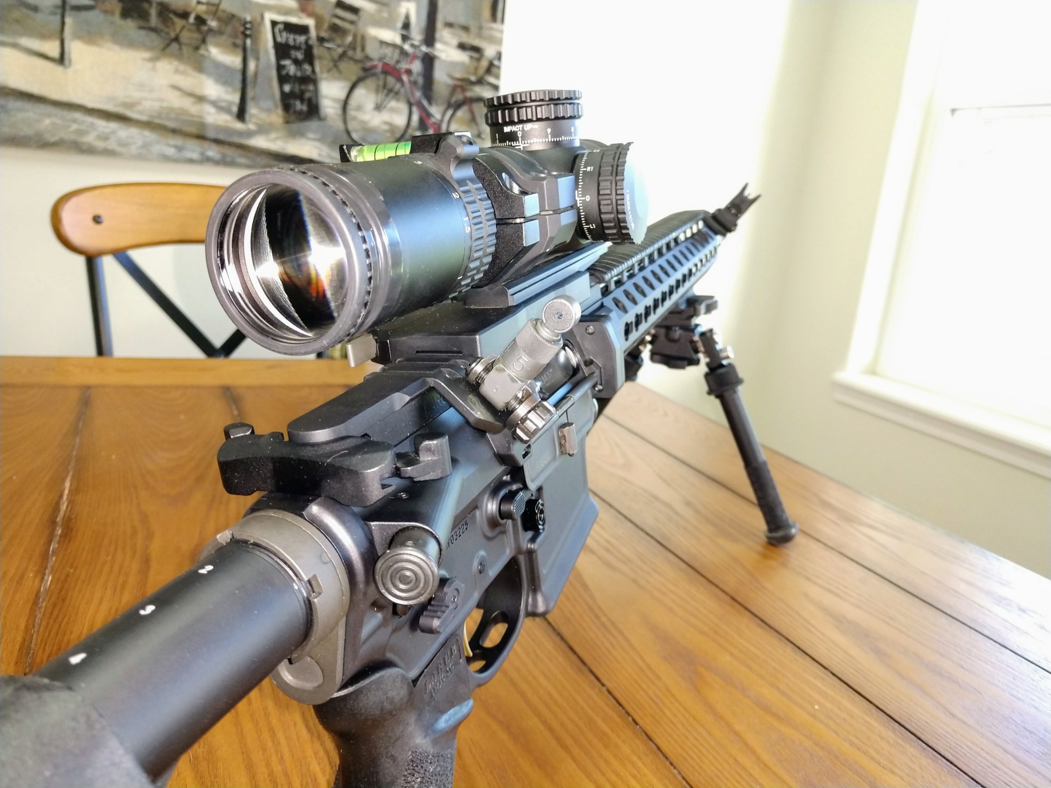

    Complete JP LMOS BCG and SCS Tuned to this Rifle. (Has second SCS (H2) if someone chooses to run suppressed)
    KAC 45° Off Set BUIS
    Larue Upper Receiver and handguard. Upper receiver face was trued properly on a lathe with dial indicators, same as you would true a 700 action, and was properly bedded. (I specifically chose the Larue setup because it's an honest free floating system, nothing touches the barrel or barrel nut not even the handguard)
    PWS Full Ambi Lower (the reason I chose this lowers because it's almost identical to the KAC SR15 Ambi lower)
    Tuned AR Gold Trigger set 1LBS 13oz
    Trijicon Accupower 1-8x MIL with BoBro QD Mount.

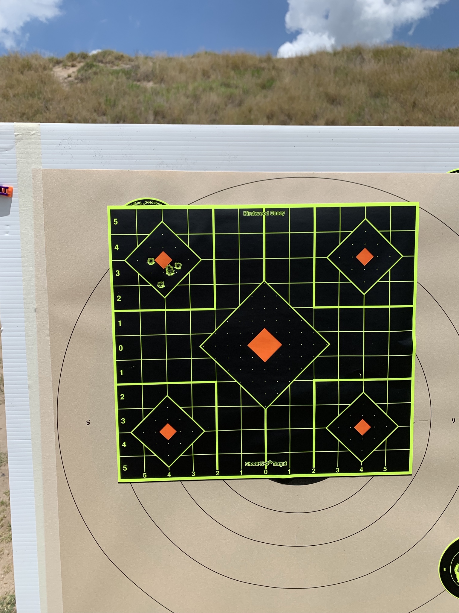

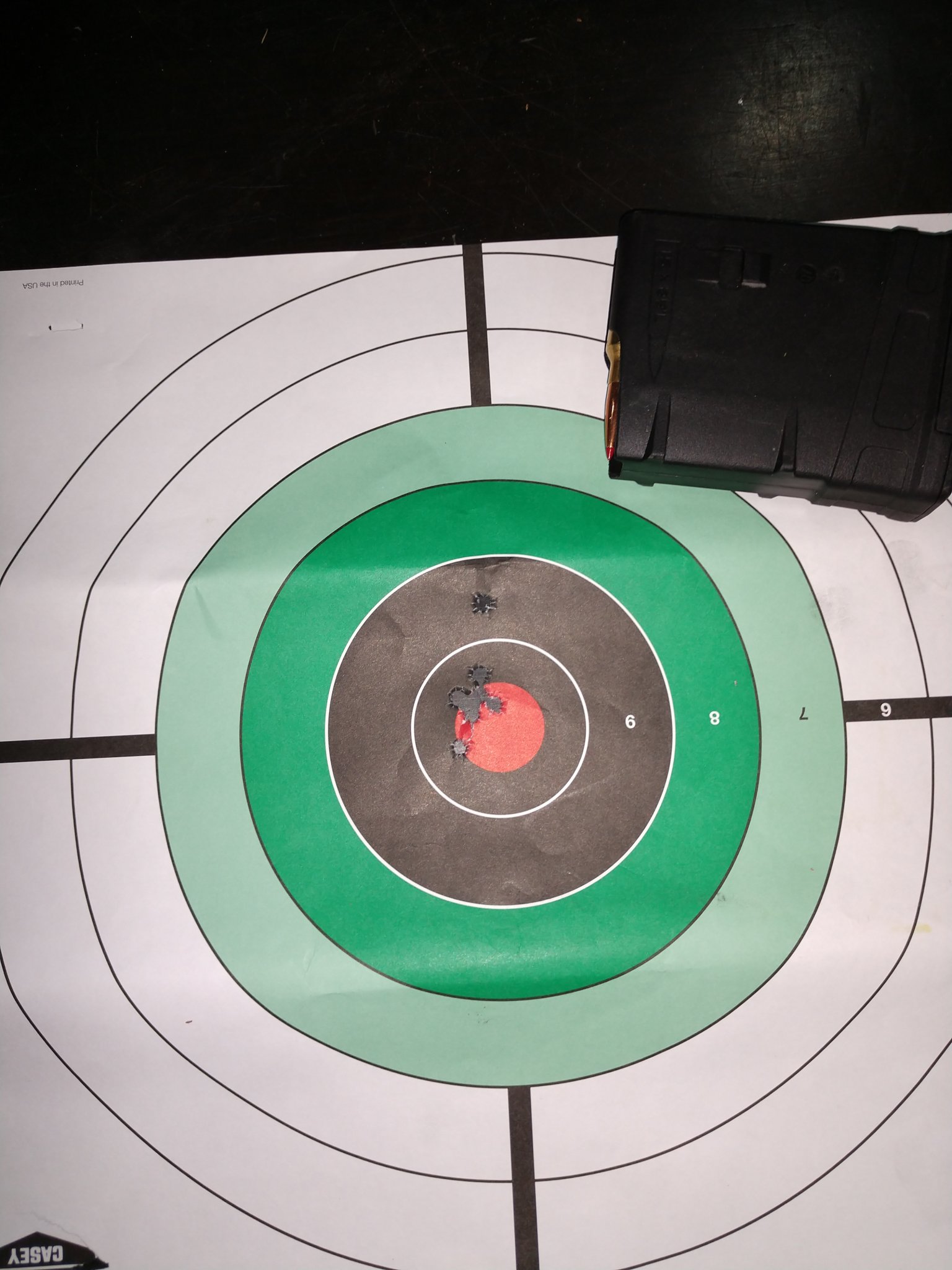

    This 10rd 100yrd Group was shot after I completed proper barrel break-in Gas/Buffer adjustment, and Scope/BUIS zeroing at 100yrds. Only 65rds of Black Hills 77gr Match down the tube. Pretty phenomenal group considering I couldn't even see my point of aim while shooting with the X8 Triji, and the center crosshair completely covers the bullseye.

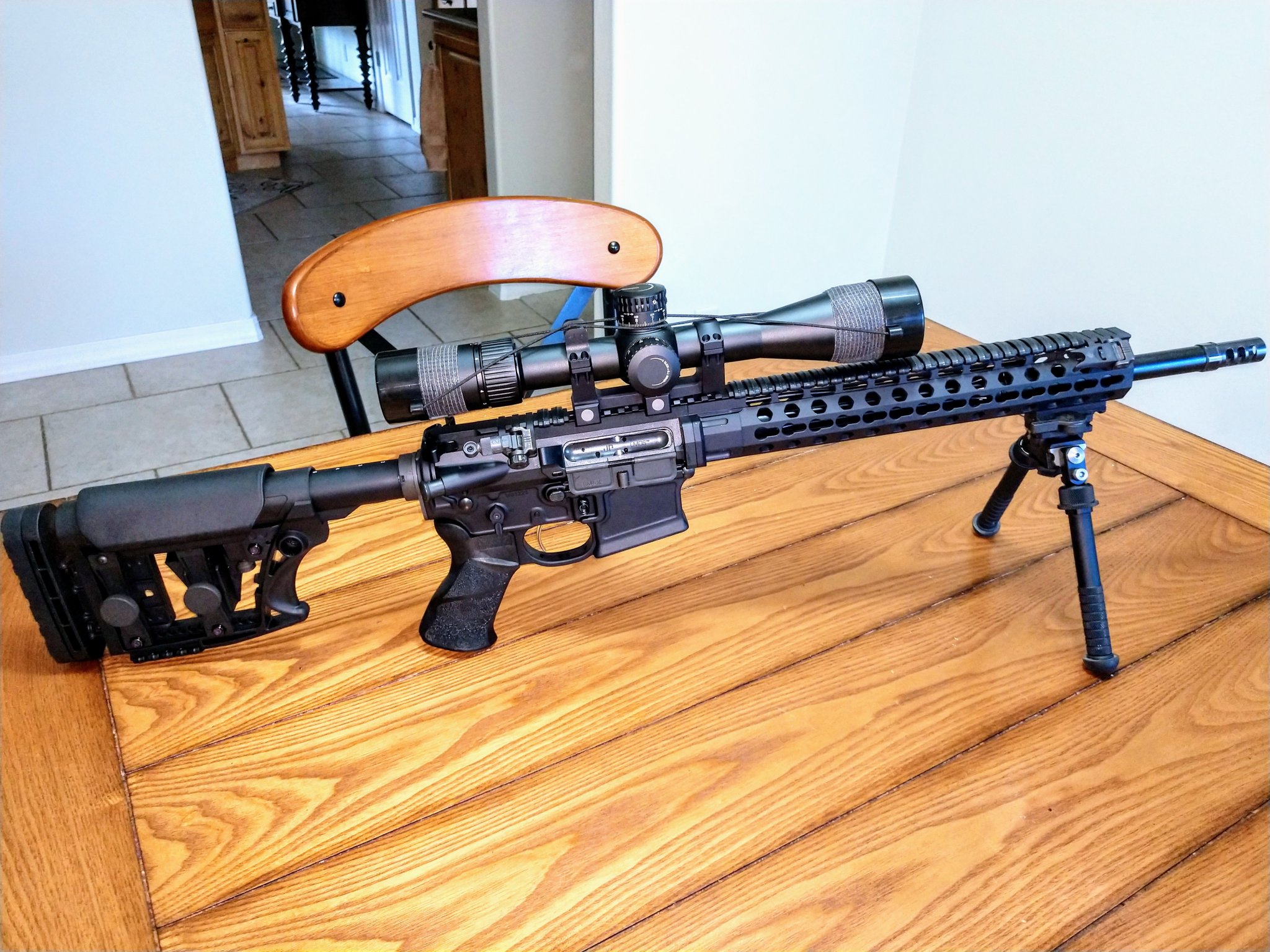

    Only changes that I will make if I decide to keep this is the addition of a Luth MBA-3 Carbine Stock, for full comfort adjustability, and I'm going to replace the 1-8 Trijicon accupower with a Leupold Mark 5 3.6-18, since there's only like a 1oz difference in weight and with a better power magnification I'll be able to truly print some Bugholes.

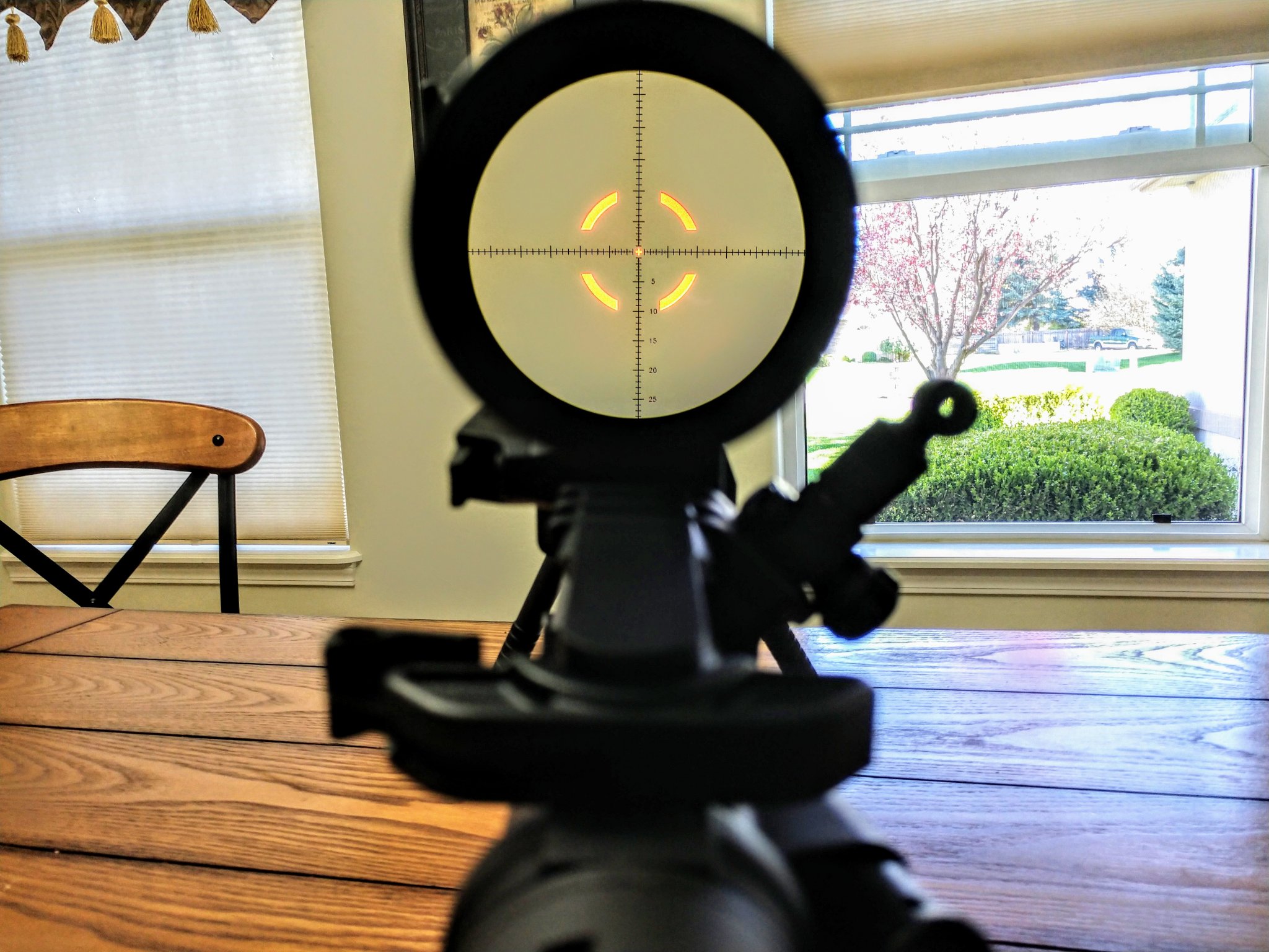

    That’s one of the worst optics to shoot for groups with given the size of the reticle. I’m interested in how it really shoots with the Mark 5.

    Yes it is quite difficult to shoot for groups with that scope that's why I was so pleased even with the two flyers. During the break-in and tuning phase I did use a vortex HD GEN 1 5-20 with a BoBro mount, for two 5 shot groups that's how I know it is guaranteed to shoot .25 - .5 MOA. Unfortunately I did not take any pictures of those groups because the Triji was the Optics of choice for this build and I had zero it, but both were one ragged hole groups. If this doesn't find a new home I will do a 6x5 for you guys.

    The F1 ATACR 1-8 was definitely my first choice, but just couldn't justify the price. The Triji is built like a tank, great glass and works well for Steel and Biped Varmints if needed.
    The crosshairs are like 2" thick though lol. I have one on a scar17

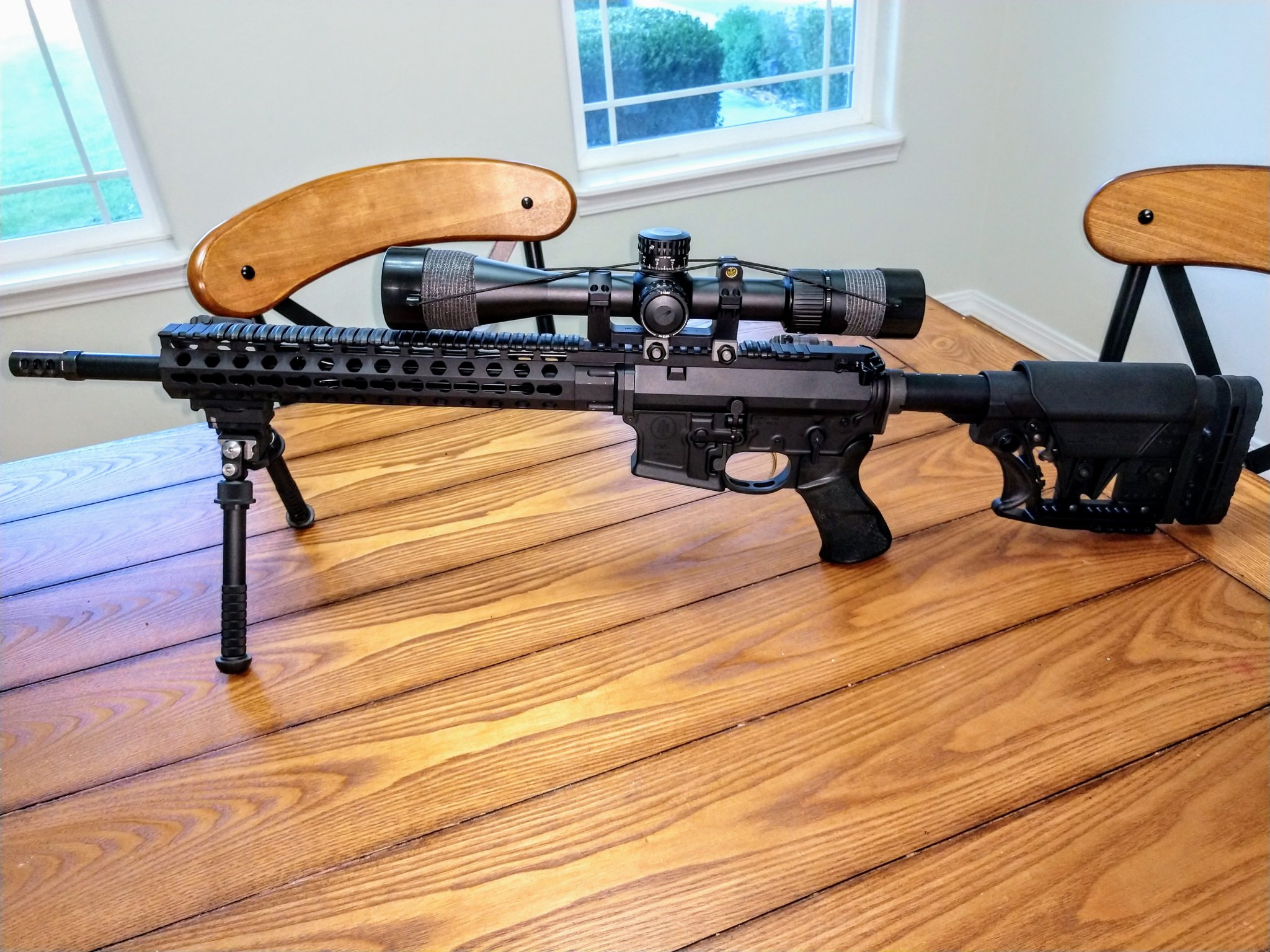

    My Recce rifle is one of the first rifles I ever built and to this day if not the most, one of the most accurate AR's Ive ever built or shot. Its a straight hammer with 77smk. It sports a 16" WOA 1:7 barrel. First barrel ever purchased from WOA. Its got easily 6000rd on it and its still just as accurate as the day I built it.
    No special heavy walled, reinforced upper. Just a forged Aero upper and lower. No upper receiver face lapping/truing, no bedding. Didnt do any of that back then.
    Aero Upper/Lower
    Young Manufactoring BCG
    BCM CH
    Timney AR Competition 3lb single stage trigger
    Troy Handguard
    Syrac Adjustable gas block
    Magpul UBR stock
    ADM AD-Recon 30mm QD Mount

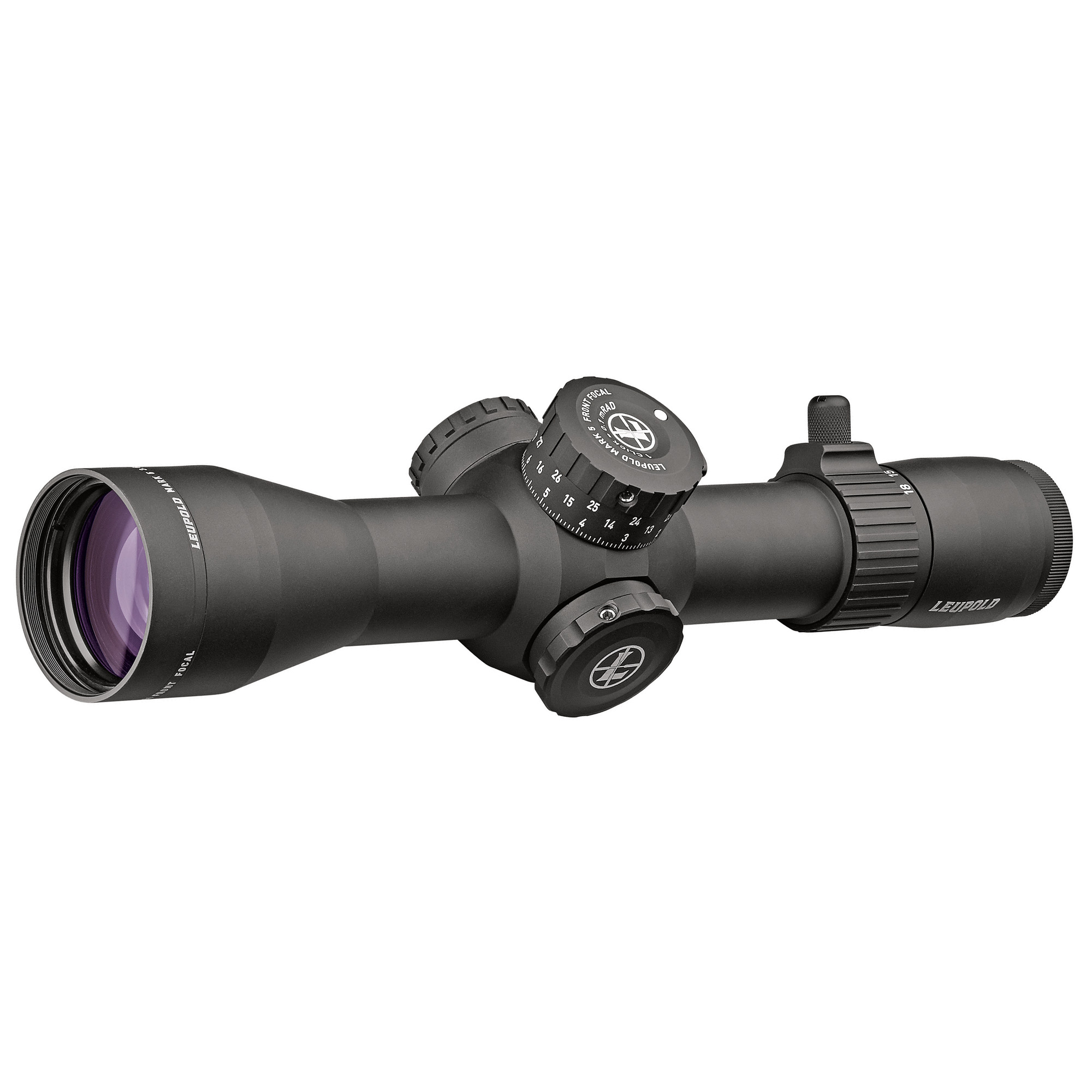

    Leupold Mark 4 MR/T 1.5-5 CM-R2 Reticle
    PMC X-tac 62gr Green Tip 100yds
    IMI 77gr OTM Razor-Core 500yds w/5x Optic submoa
    Hornady 75gr Superformance @ 100yds

    Its producing consistent .25 moa agg 5x5?? or it shot a .25moa group? I would say thats the most accurate AR Ive seen if its producing .25 agg
    No I Haven't shot 6x5 yet, I've only shot a total of 65 rounds for break-in zeroing sights, and tuning. I've shot 3 Groups totally (1) 10rd which is pictured above, that was damn near shot blindly. And I shot (2) 5rd groups with a Vortex Razor HD1 5-20 and 100 yards that were both ragged holes, definitely under .5 most likely between .250 - .340 MOA. I told the gentleman above that I would do a 6x5 if I decide to keep this. I just don't want to put anymore rounds down range if somebody decides to adopt this beauty.
    Keep in mind that's not with landloads, just BH Blue box 77gr.
    Out of all the 16-inch builds I've done I think a lot of this accuracy is contributed to the true free floating system and the custom contour Krieger Barrel Frank and I came up with.
