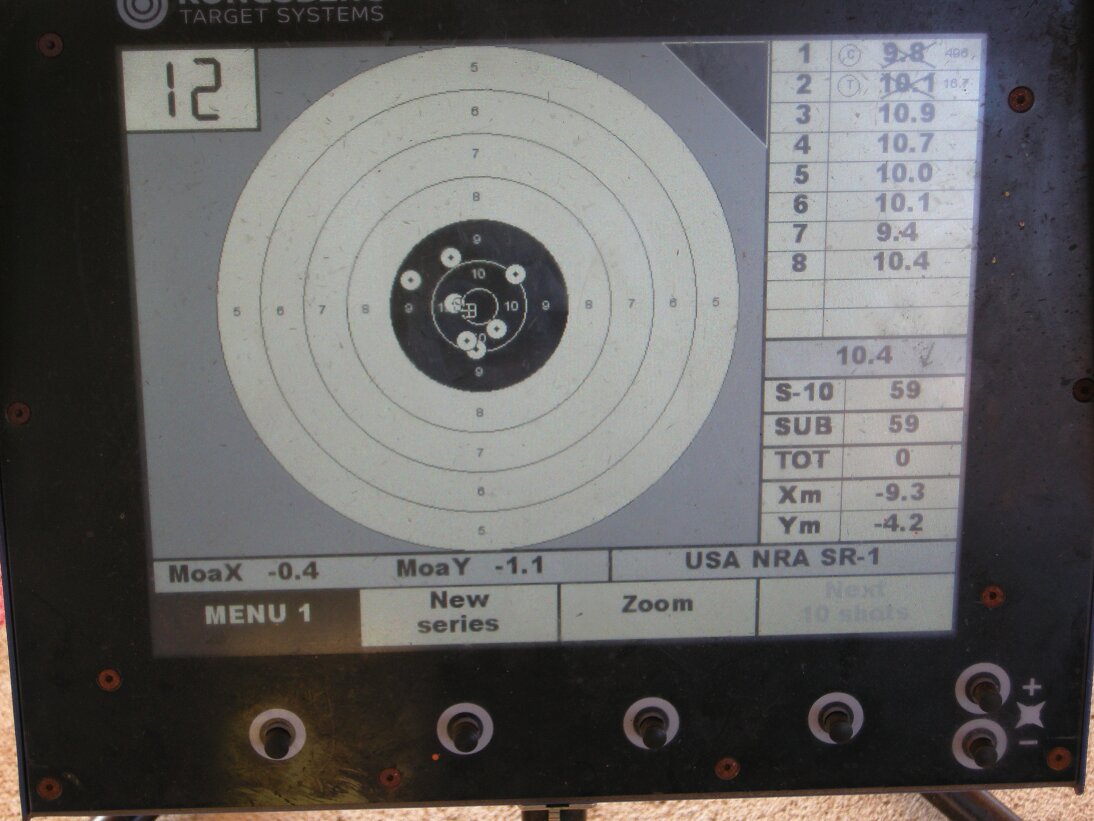

In SR XTC, a good one can hold the 10 ring with a high X count at 300 yards. That means it shoots 10 rounds from prone-sling with a mandatory reload that is shot with 2 in the first clip, then 8 rounds, in under 70 seconds.
There is a brief cool off during the scoring, and then a second string is shot. This is worth mentioning since the barrel is still hot and the sure signs of a worn out gun will show the group open up during these stages. Many folks assume a gun will show wear at 600 but it is the rapid stages that open up first due to the heat during rapid strings.

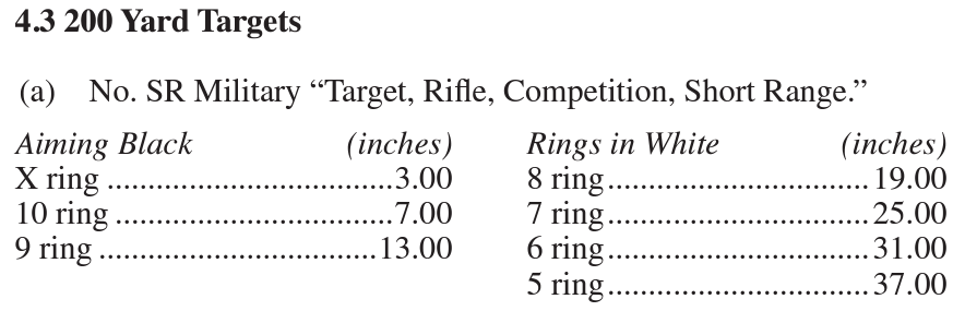

So how big are the score rings that I am describing? I will show you the 300 yard targets that I am saying separate the good guns from the typical ones here, then add in the 200 yard target used in the CMP games where all the guns are in theory supposed to meet rules that do not allow match prep but will allow what I will call sorting parts and re-barreled guns.
Here are the 300 yard rings. A very good example can hold the 10 ring from prone sling with a good driver using "standard" ammo.
Here are the 200 yard rings used in CMP games. You will see "clean" scores in CMP Games when folks have a good sample and good loads.
If you translate the target to the 100 yard MOA level, just divide by 2 and you will see the X ring is roughly 1.5 MOA and the 10 ring is roughly 3.5 MOA.

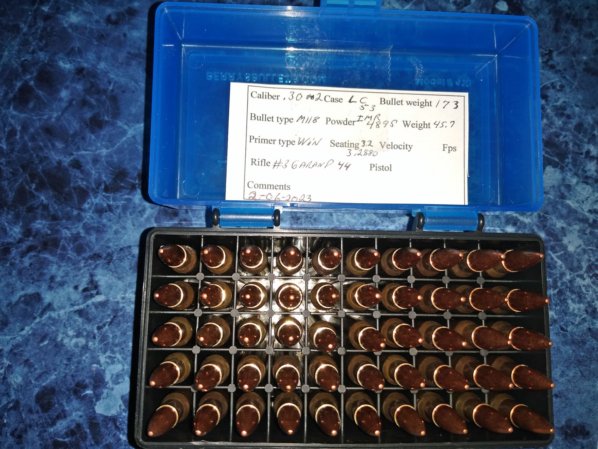

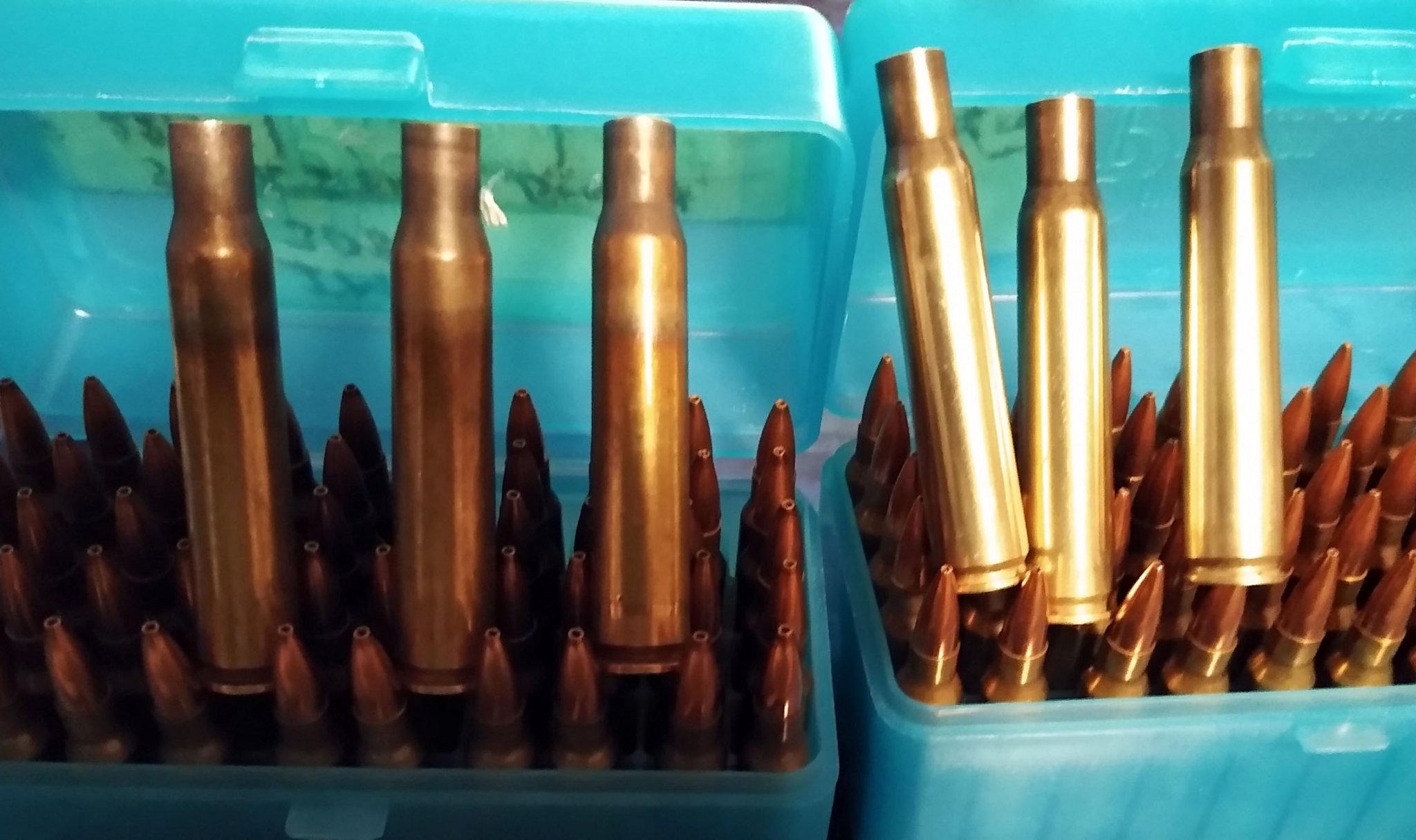

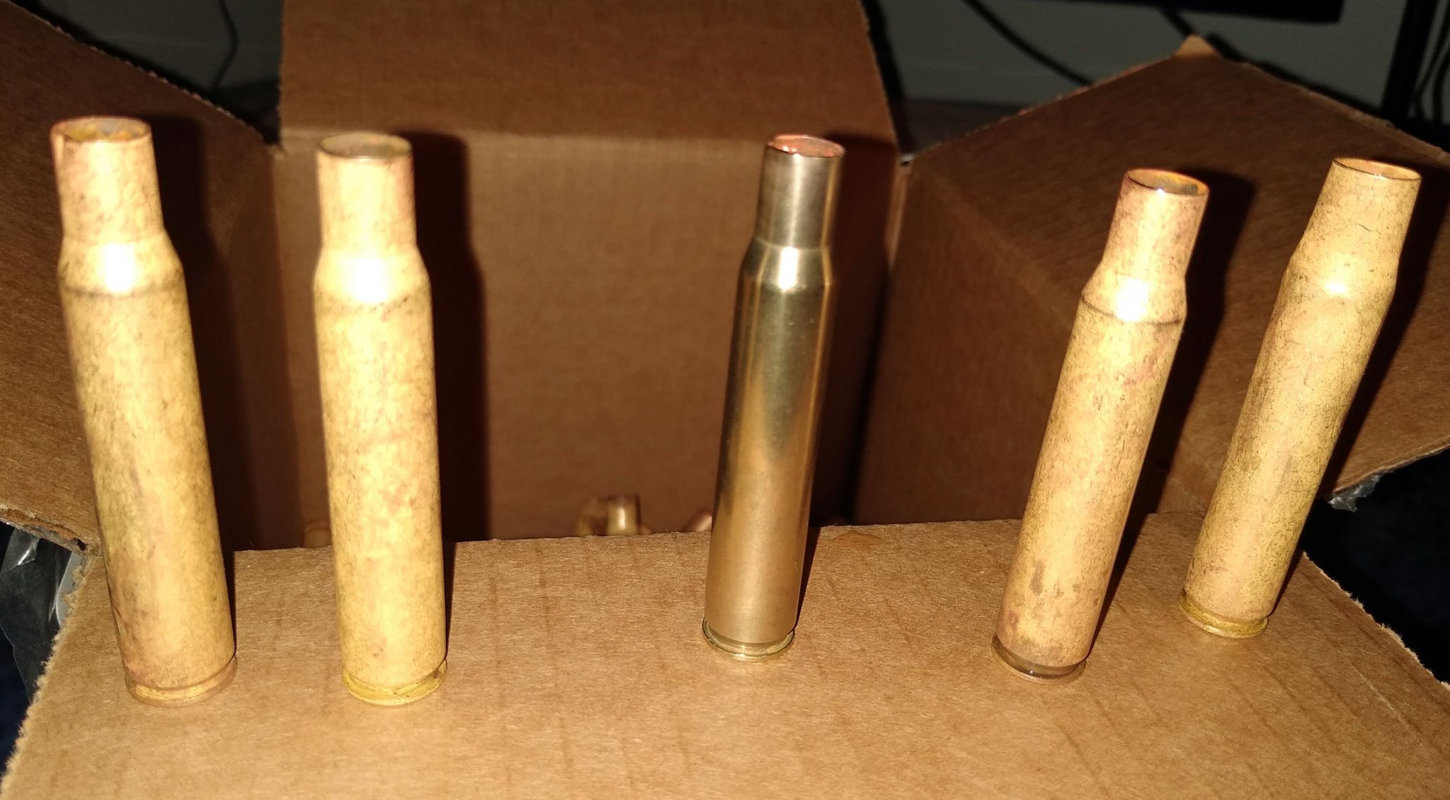

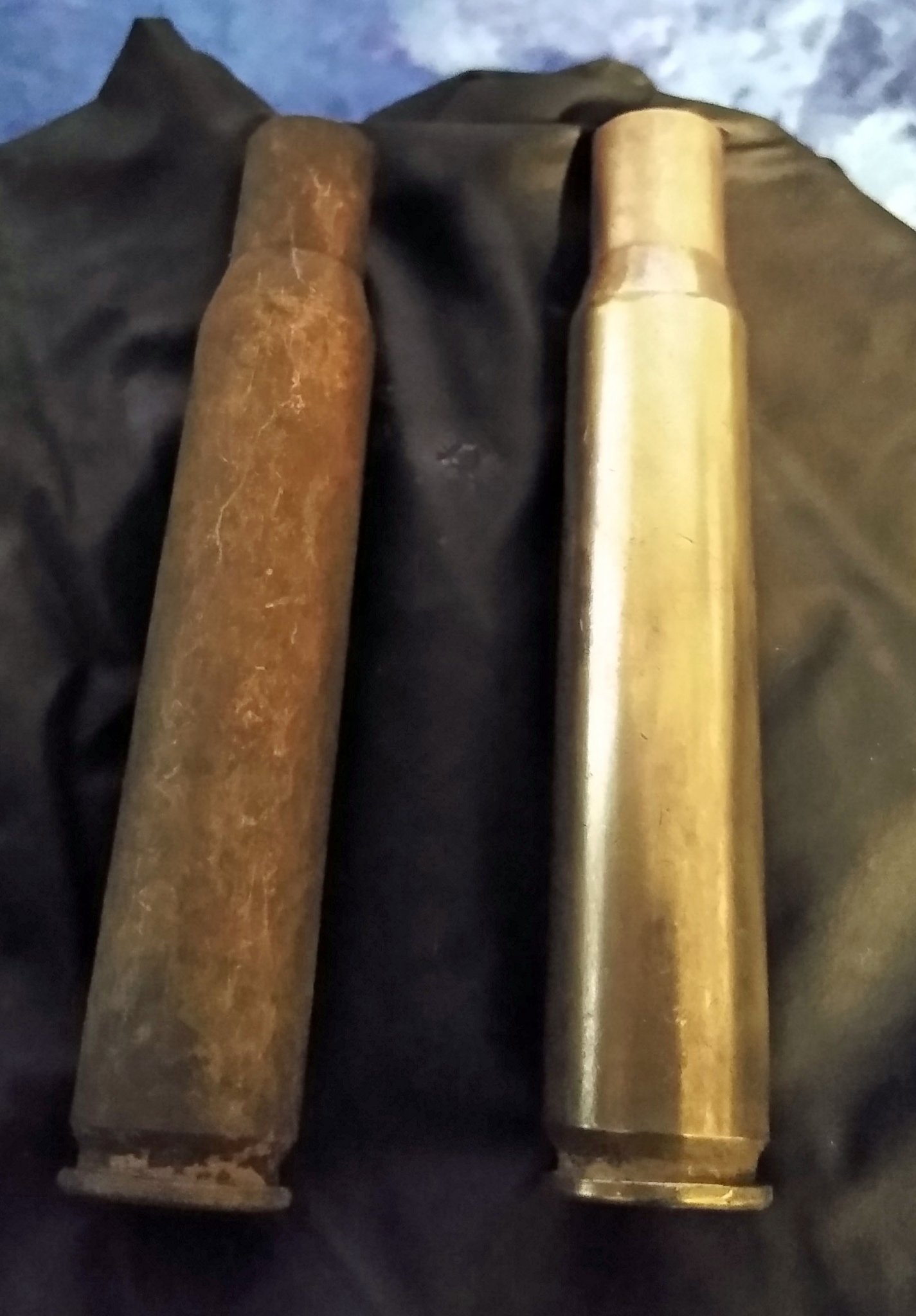

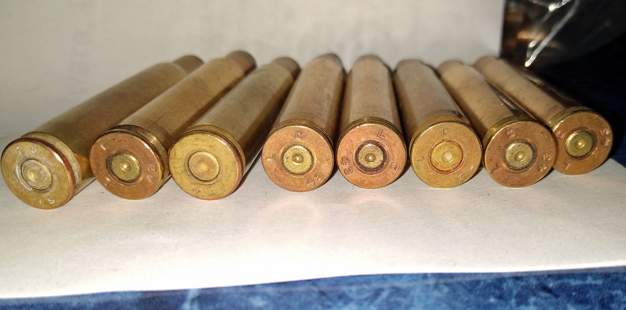

One can build Good ammunition for old tired war horses ; Behold ; Please note I spare No extras for targets . IF My pinion hadn't been stripped ,I'd have been able to elevate POI . I've since Fixed that by rebuilding and thus making a New sight . One enbloc all accounted for ,yes low and remained so until I realized the pinion was toothless !. Now have #25 firings on 1943-44 -53-54 LC cases , 0.5 gr. under max IMR 4895 & 4064 .
So I say it can be done

173 grain bullet? What bullet was that?
M72 Match pulled ; I have K's as DCM dumped tons of them back in the day ,in favor of 168 new standard .

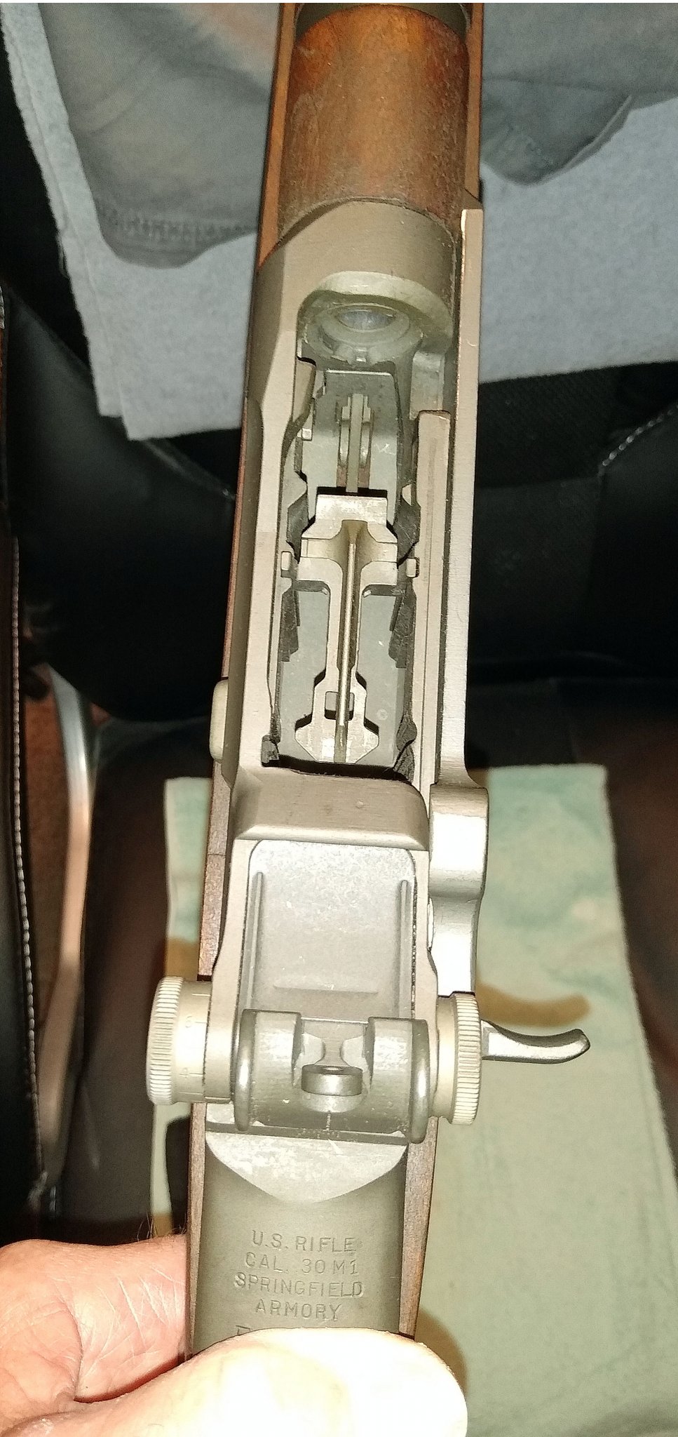

That group was from a rack grade Rifle of mine as I have a few Garands . By it's appearance it looks as if it might have been used to link a tank track of 3 during it's service life . So appearances can be deceiving .

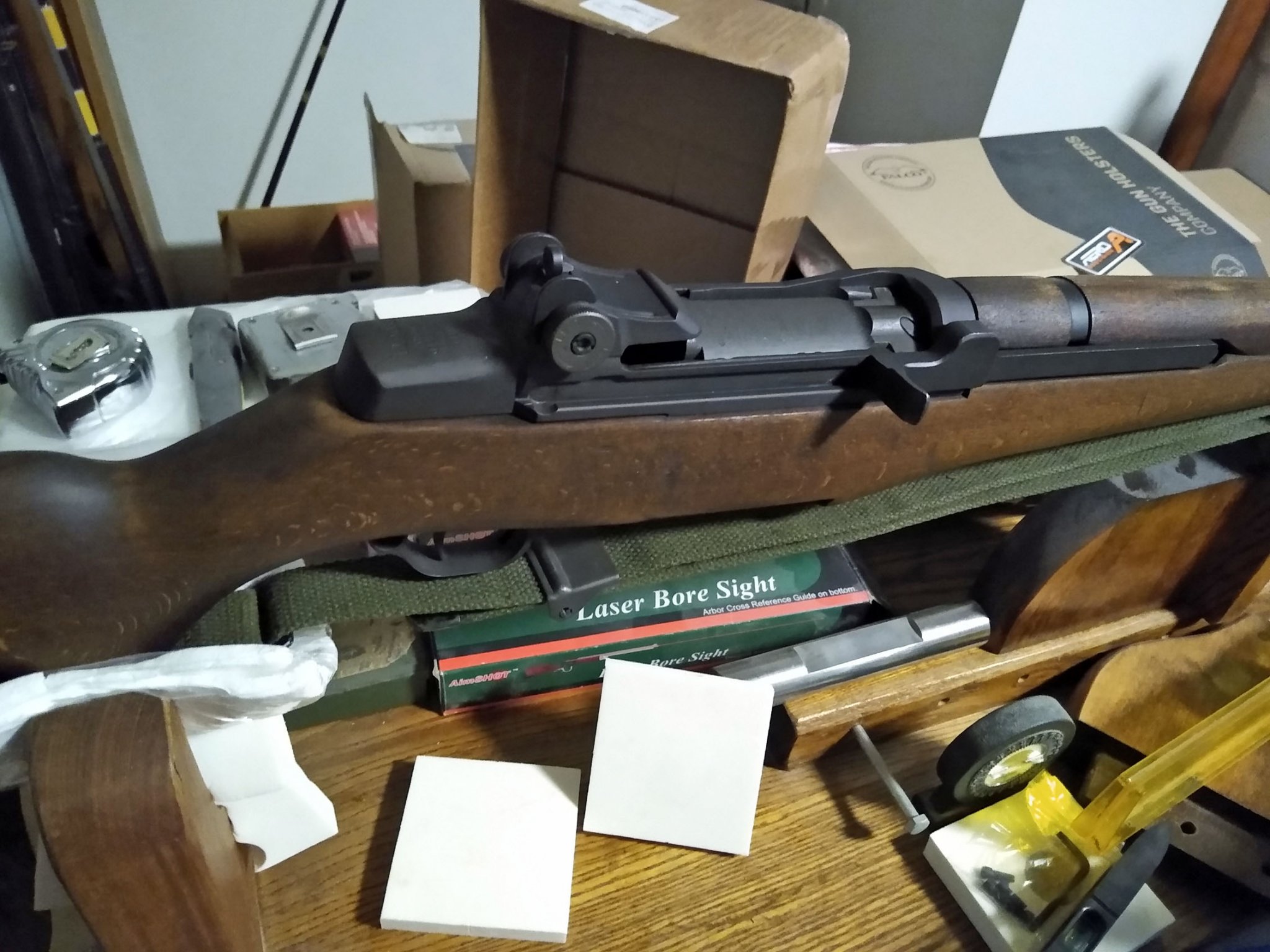

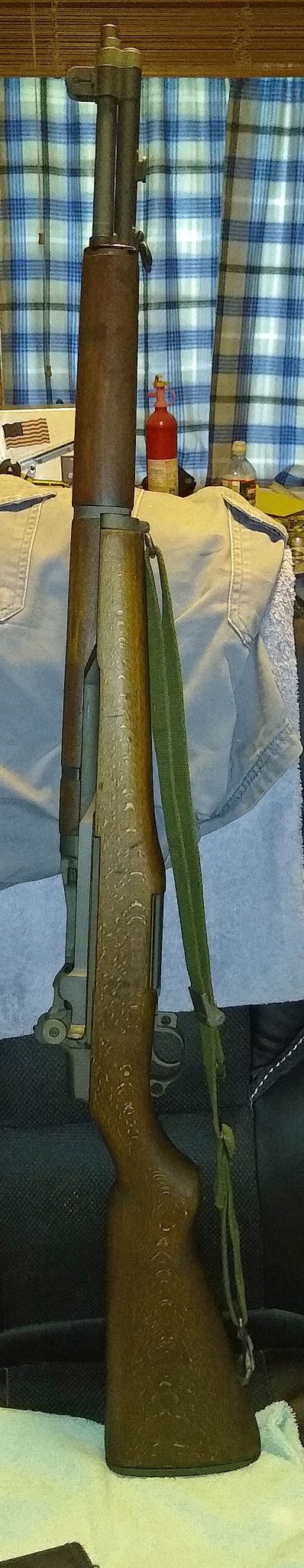

I will be developing a few new loads so as to shoot My virgin UN-Issued 1943 Garand . Not a arsenal rebuild but a genuine UN-issued Garand . Decades ago My 1 St. Srgt. after #3 tours VN ended up in the Anniston Armory prior to retirement . He discovered a secret stash of #6 stored Never Issued Garands among other fossils ,which he somehow legally purchased as arsenal rebuilds ;) . He and I served together and were tight ,so I got a call one afternoon and the Deal of a Lifetime . I won't say what I paid as watching grown Men cry has never set well with Me .
It was still in GI issued wrap cosmoline and ALL #'s matched Springfield awaited my unveiling in the diesel bath . Now I bought a # of Garands via DCM and knew what Armory arsenal refurbs were . It was a Big Deal to ME to take My Dad out shooting as he was an expert marksman ,1930's Marine Corp #6 years 40's-50's Navy #22 Medical out . He was 80 before I finally bested him shooting . Might say something for earlier Soldiers training regiment ?. Camera and light play tricks ,it's Parkerized Green hue genuine . Being a chemist I learned how to recreate that or near any shade of Parkerizing . I actually talked with the daughter of Clark Parker and subsequently received her fathers notes about a year later .
Those of you who might not know : Parker obtained the patent and rights to Parkerizing and several of his employees made various improvements over the years through his and son's company , Parker Rust Proof Phosphating Company of America . Variations of colors = Temperature as well as chemicals added at a particular stage of the process and final drying .
