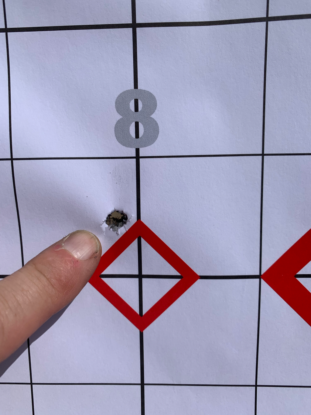

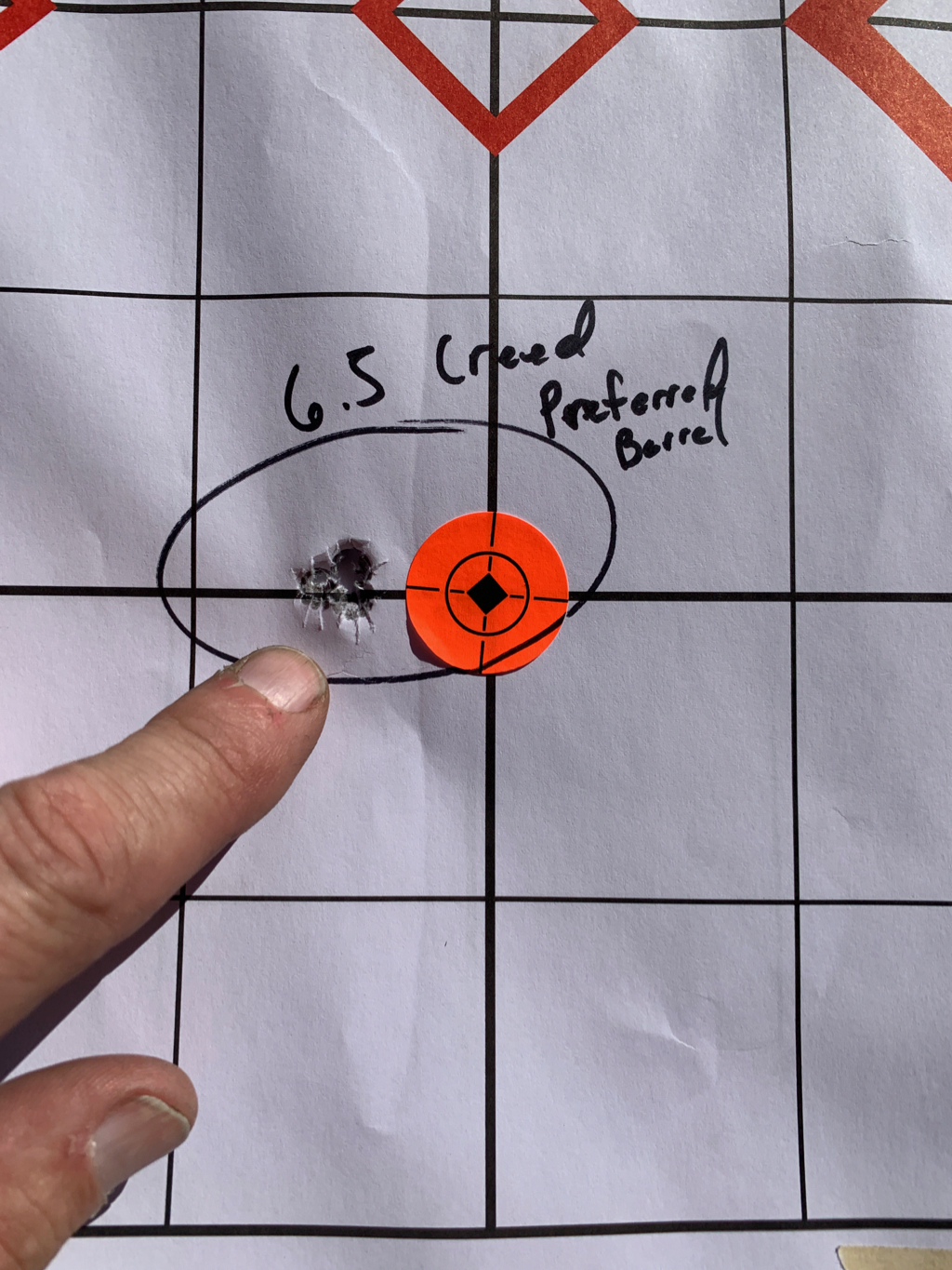

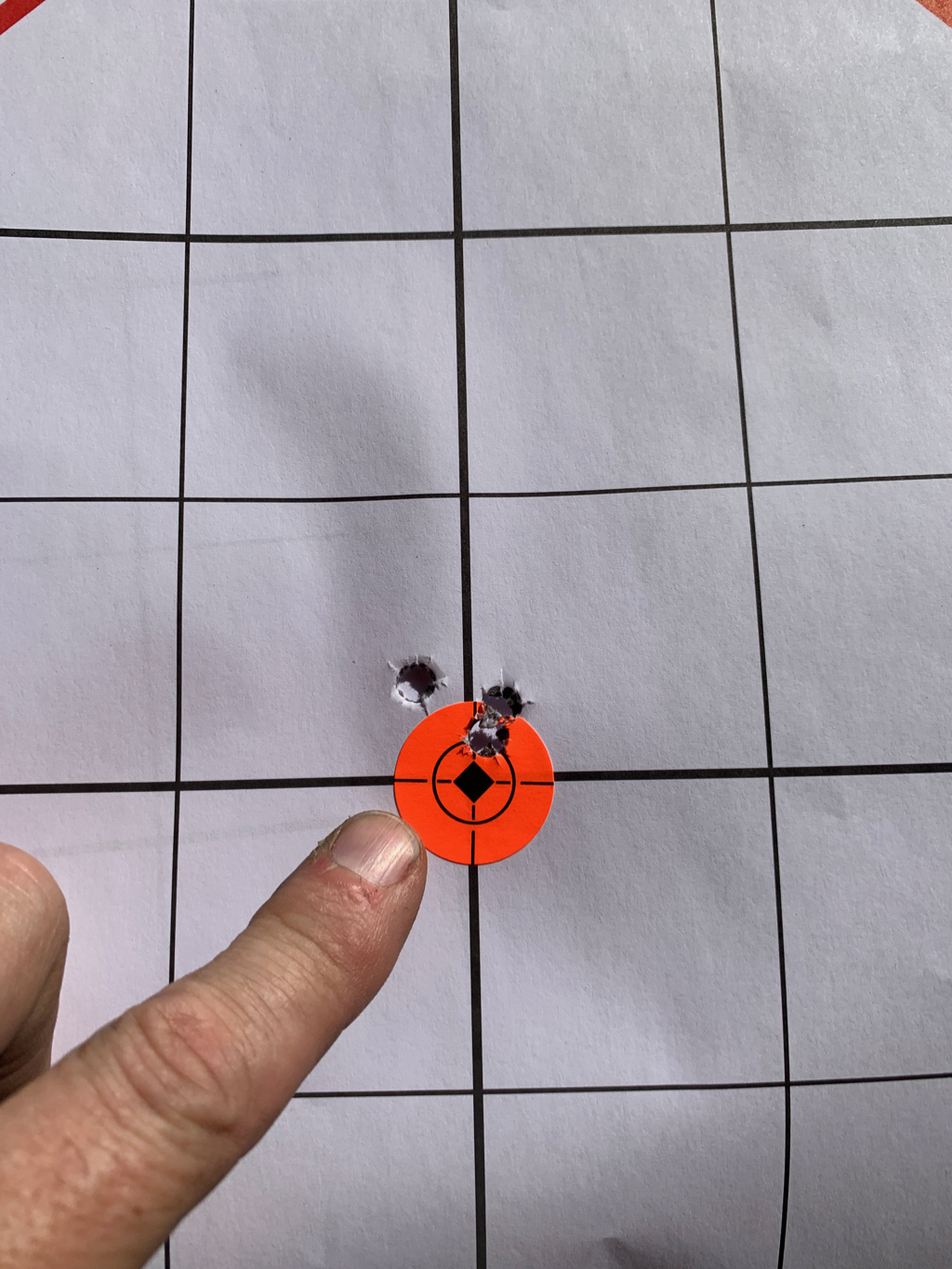

I installed a Preferred Barrel, Prefit for Ruger American....6.5 Creedmoor, 26 heavy Palma....here are some picture of breaking it in....
First Pic is a three shot group...would not believe if I had not shot it...but yes that is 3 shots at 100 yards, second is three shots a 100 yards and third is 3 shots at 200 yards
These were Hornady Black 143 ELD-X....2700 fps second.... my handholds of 130 Berger OTM groups were not as good but I was getting 2919 FPS...when I got home I measure the throat and my handholds were jumping a ton...they were loaded for the original barrel, so I think once I seat bullets based on this chamber I should get better groups.... SDs were single digits....I have three other Preferred barrels to put on actions...I hope they are shoot like this...
