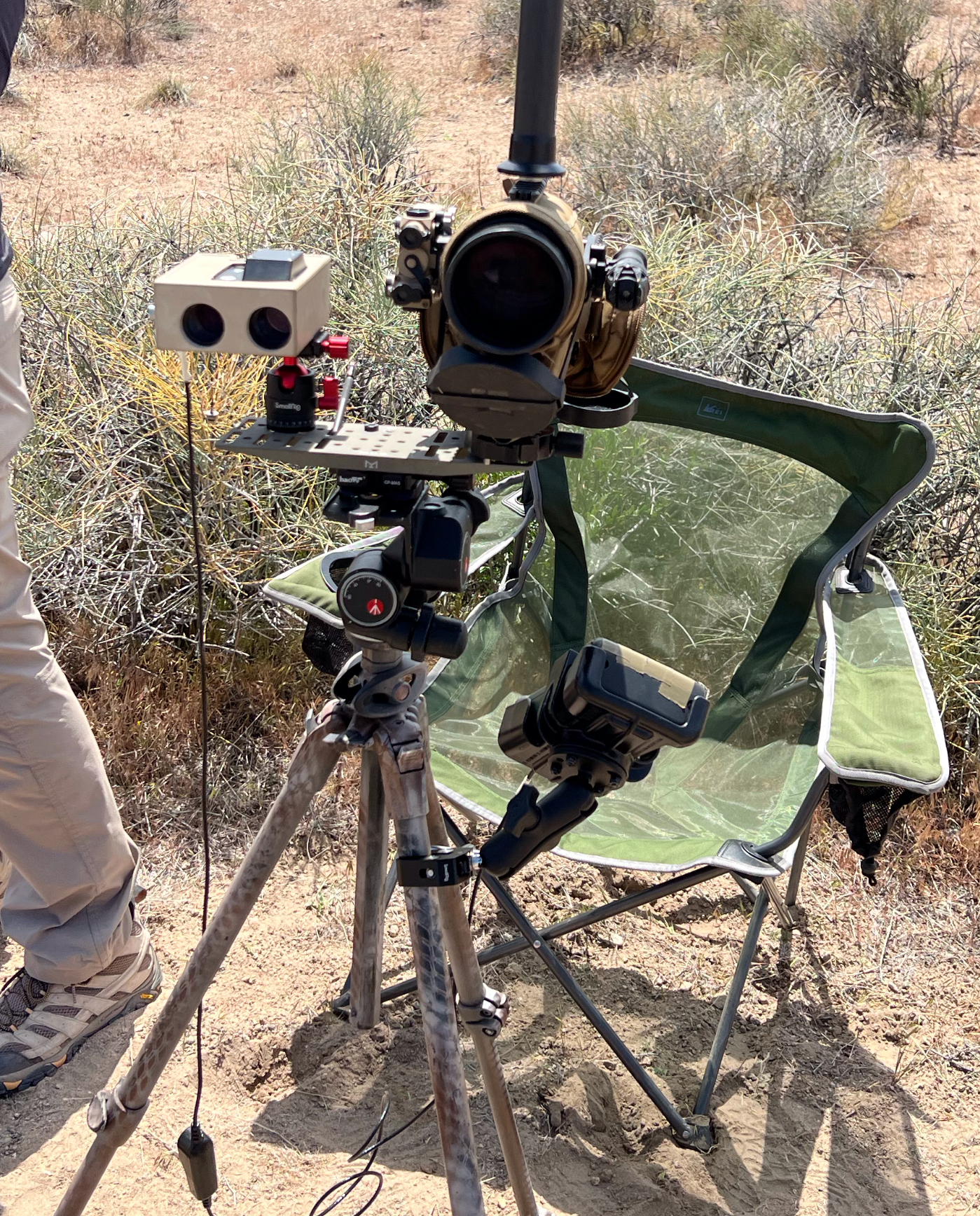

This is how I do it. Use the ball head to get the PLRF to point at the same object as the Spotter, then just use the rotational knobs on the main head to move the whole rig as one slaved unit. Ignore the wind meter mount on the Spotter - that was a bad idea.
