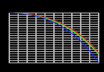

Using the Nikon SPOT program it shows the Hornady 120g AMAX dropping only about 4-5" less that the 140g AMAX at 960yds.
Edit; Tried to upload the trajectory chart.
