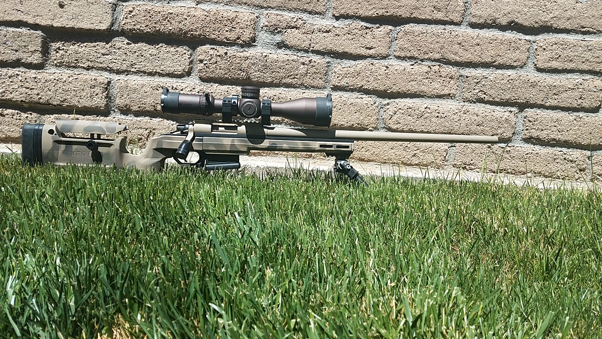

Krg bravo with a 700 action and NSS barrel nut and light varmint barrel. Plenty of room for bigger contours.
