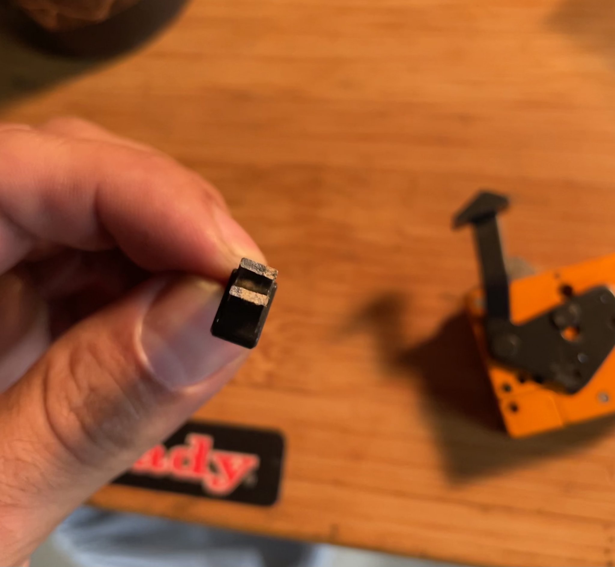

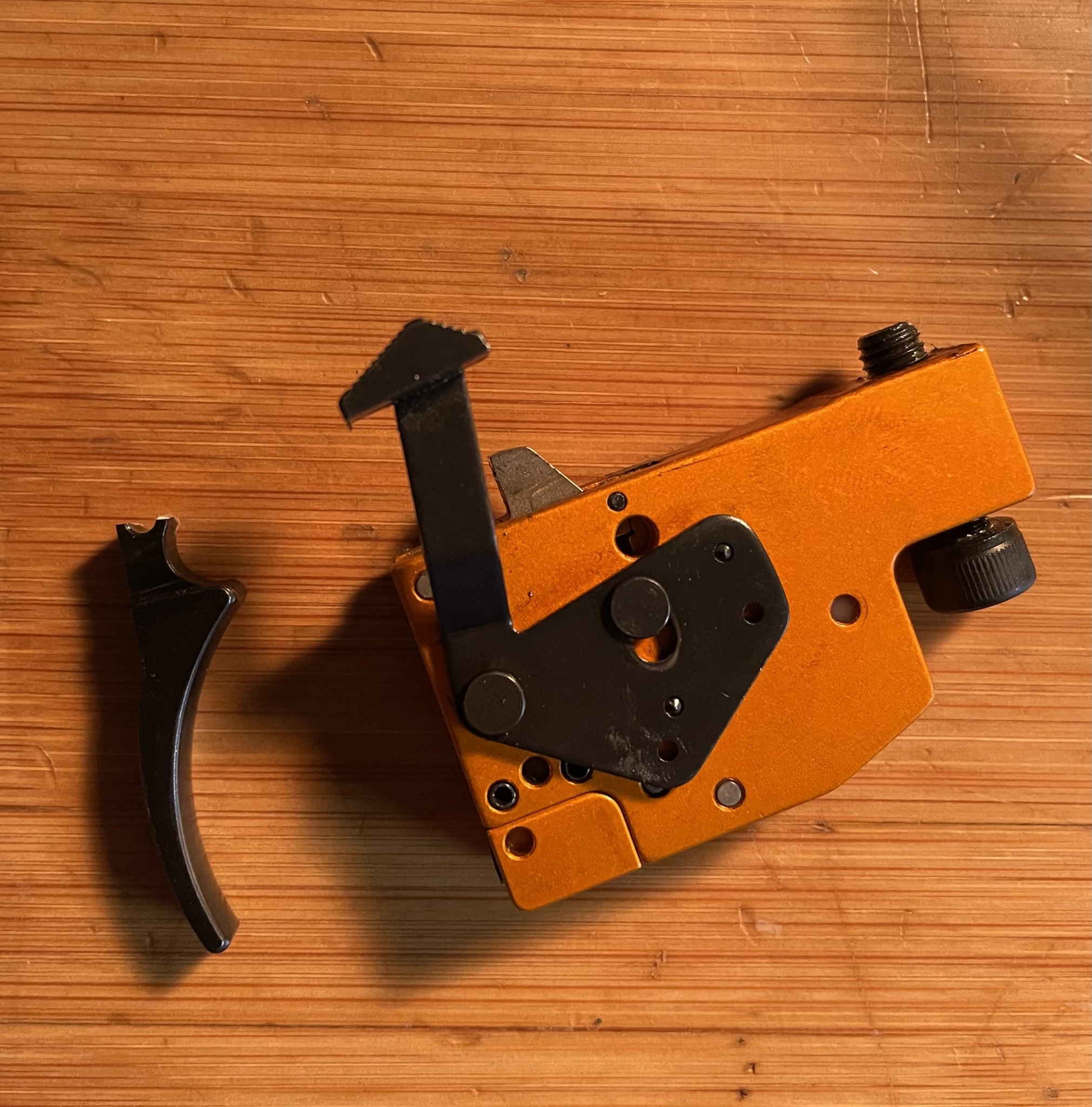

Yesterday I decide to remove the current barrel I have on my Tikka T3. Since my local PRS season is over and I have 2,800 rounds on it I figured it would be a good opportunity to swap barrels and do some load development for next season.
My T3 action currently has a Rock Creek prefit on it and I was planning on installing a Benchmark. So I start trying to take of the Rock Creek and it’s being unbelievably stubborn. I had the barreled action in a Viper vise with some drywall tape around the barrel. Gave the wrench a few taps with a mallet, nothing. Tried tightening and going back to loosening, nothing. Dropped some penetrating oil to go in the threads and then later decided to hit it with the heat gun. As I was heating it up and applying torque, after 3 or 4 attempts the action finally came loose.
As the action came free I heard something fly across the room and it was my trigger shoe. It broke clean off. Never came into contact with anything, the action didn’t spin out of control, it just snapped off. My guess is the inertia. I reached out to Timney to see if they can help but I’m baffled.
Anyone have ideas as to what I did wrong here?

You likely hit it at some point and never realized it. There is no way the inertia of the action spinning blew it off. Just replace it and move on...
Reactions: camocorvette
You’re probably right. Only other thing I can think of is somehow the heat weakened the trigger shoe. Regardless, I’m sure Timney will throw me a bone
If you used a rear entry type wrench it looks like it put downward pressure on the trigger sear and it broke.
Ah, this is most likely the cause then. I used the T3 action wrench from Bugholes, which is a rear entry. Definitely will keep this in mind for next barrel. Thanks for the insight - I think you nailed it.

Also, a bit late, but better safe than sorry, I’d pull the trigger in the future if using an action wrench that can damage it. I have my barrel vise elevated so the action and trigger sits way above anything it can bump, but I’ve caught myself getting near the trigger even still. It’s worth the few minutes to drift the pins out and play it safe.
Well I talked to Timney and they're going to send me over a new shoe that I can install. Apparently it's a punch a couple pins and swap shoes install. Crisis averted 😥
