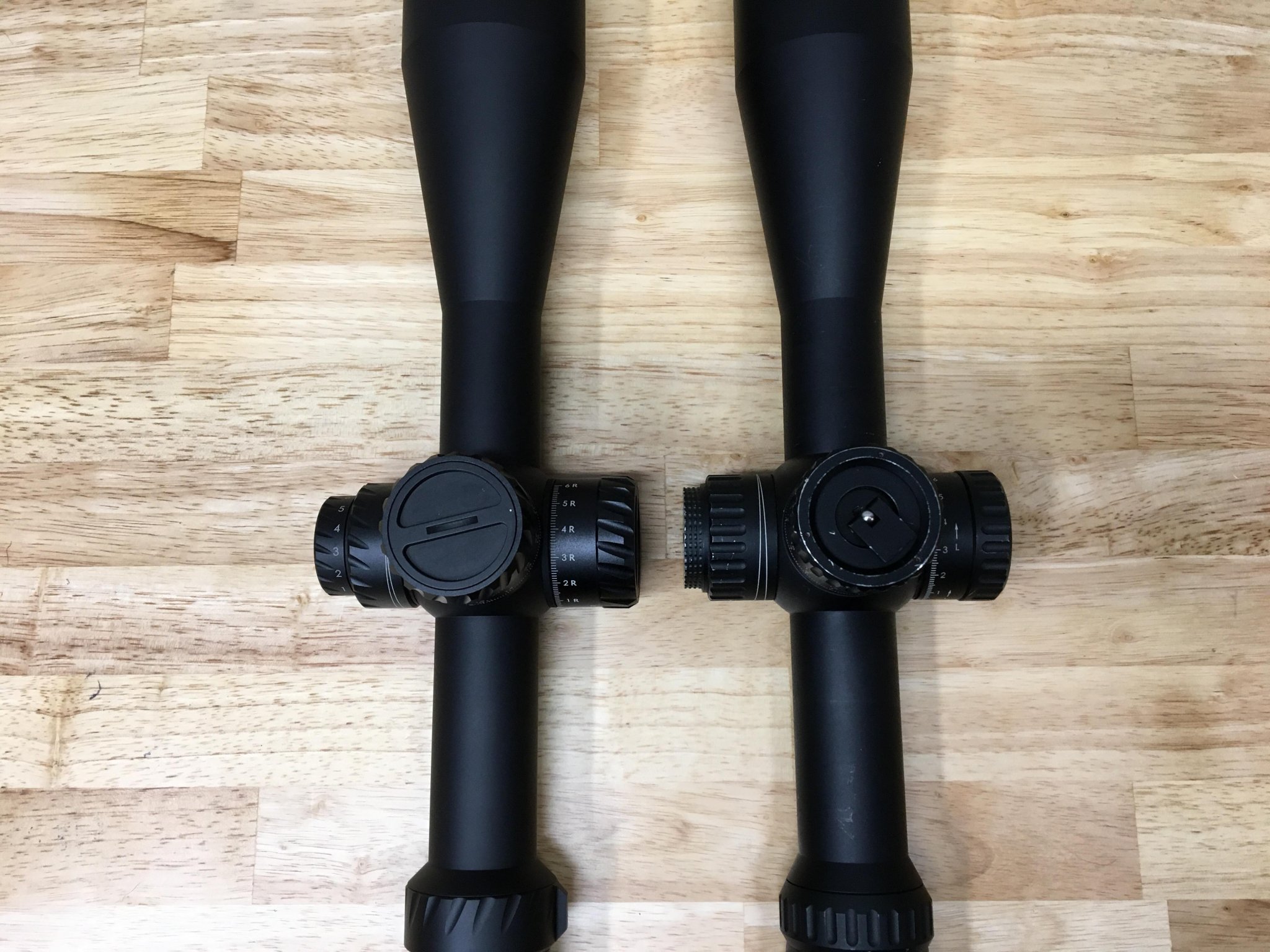

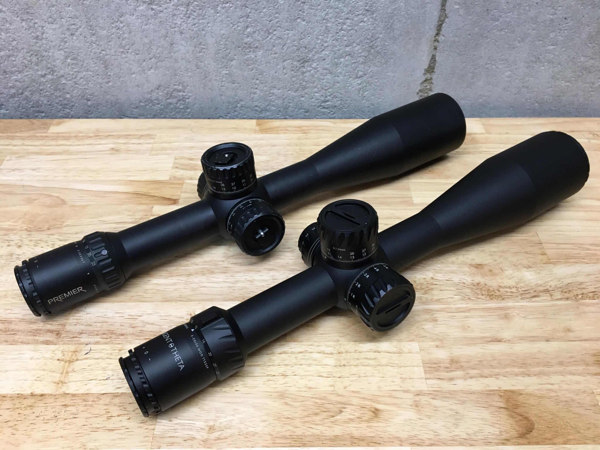

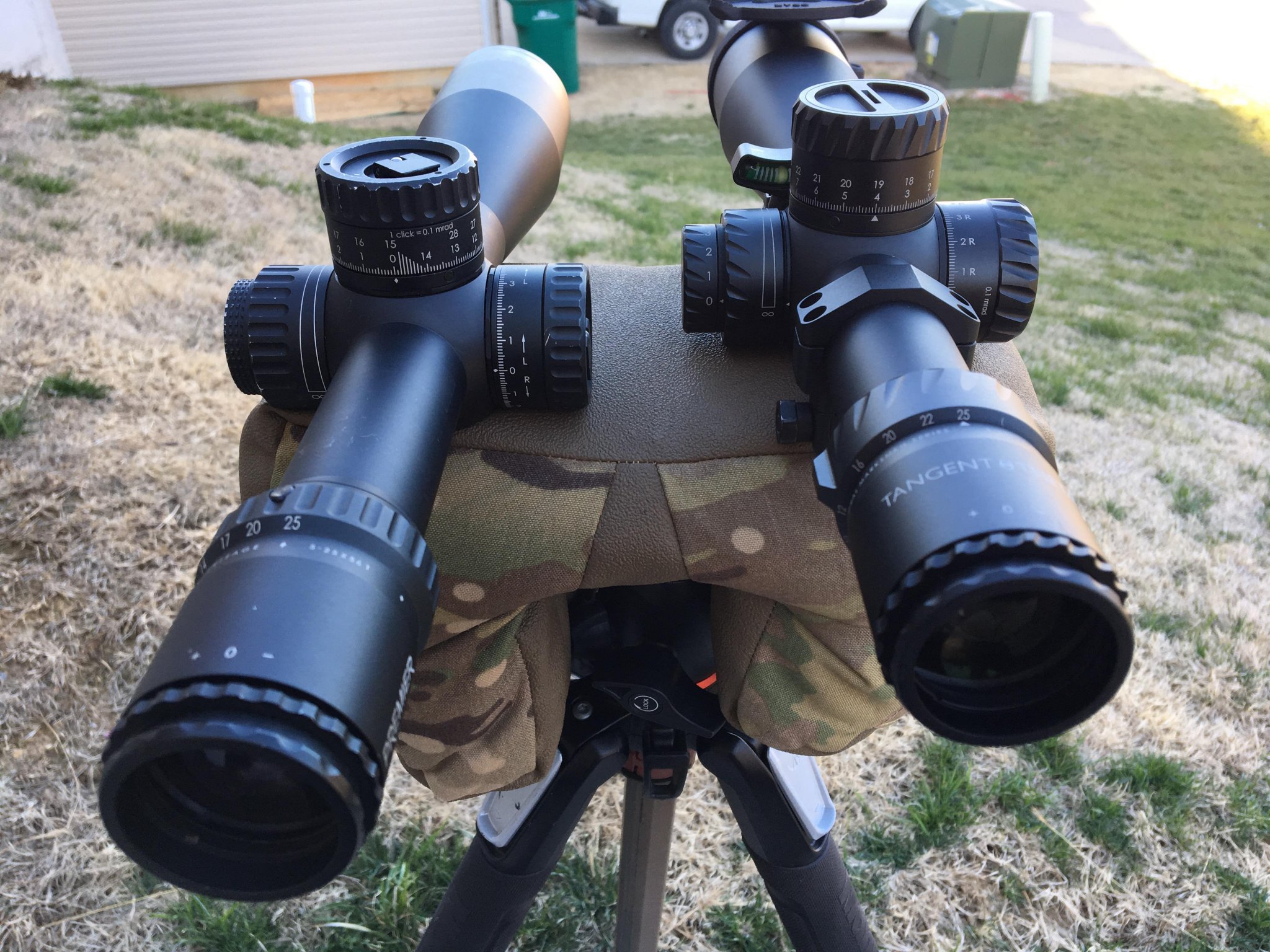

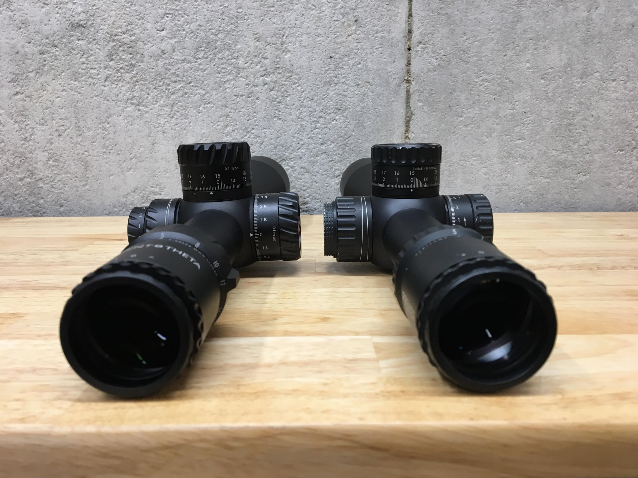

TT essentially "bought" premier and did a slight redesign.
I have a Premier 5-25 and a TT 5-25.
Side by side, they are damn near identical scopes. It appears that TT just did a slight redesign and changed a few things and upgraded the glass or coatings (you would never be able to tell the difference unless you look through them side by side)
Depending on the Serial Number, TT may honor the lifetime warranty with a credit toward a Tangent should something happen (nothing like a Vortex warranty though)
I wouldnt hesitate to buy one at all though. You will be extremely happy with it.
