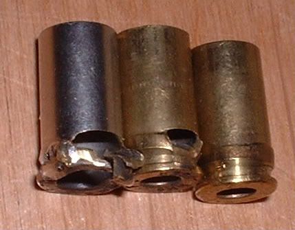

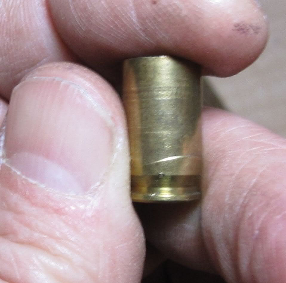

1) If the case gets a bulge in the shape of the feed ramp intrusion into chamber support, stop the work up. Useful loads must be reduced by a safety margin from this threshold.
I have done this countless times in 25acp, 32acp, 7.62x25mm, .380., 9x19mm Luger, 9x23mm Win, 357 Sig, 40 S&W, 10mm, and 45acp.
There is an underlying principal, the thin case wall has chamber pressure on one side and one atmosphere on the other. It blows a bubble. Like blowing bubble gum, it does not take much more to pop the bubble.
If you pop the bubble, you will be sorry.
When the case bulge breaks:
a) gas shoots out into the gun and can do things like blow the magazine bottom plate off, dropping the magazine spring and follower and ammo onto the floor.
b) Things get even worse when the case head blows off, and the extractor pieces leave the gun at lethal velocities. I have only done this once in 7.62x25mm and once in 9x19mm.
2) Primer piercing only occurs before case bulge in pistols with poor firing pin to firing pin hole fit.
3) Failure to extract only occurs before case bulge in pistols with poor extraction.
4) Chamber splitting or chamber bulging only occurs before case bulge in pistols with good case support [to the web or close] and thin chamber walls, less than ~0.1" thick.
What does it all mean?
The case bulge is the warning. Stop the work up there, and back off on powder charges.
