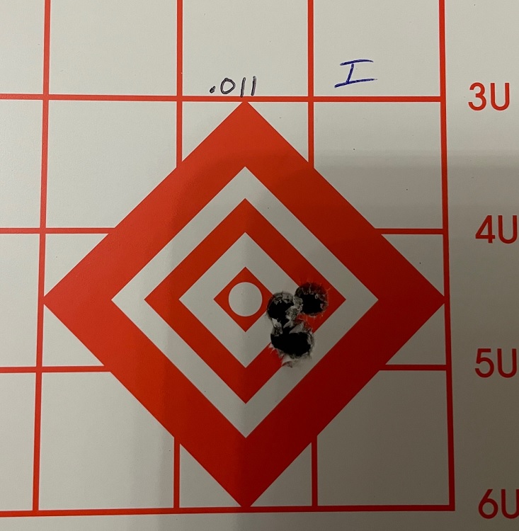

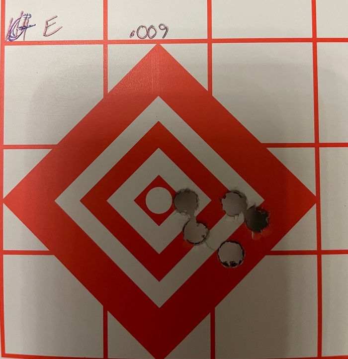

I realize this isn't conclusive data by any means, but it made a significant difference in my results. The results are consistent for me in the limited number of groups that I've shot in my testing. I'm extremely pleased with the results.
Primer seated at .009" below flush:
Primer seated at .011" below flush:
Do it a few more times, blinded to the seating depth
I've seen quite a few people taking sides on this, but there seemed to be enough evidence (for me) to test it out for myself. Glad I did.
Do you know what the crush is on the .011 seating? I am currently running .002 crush on everything I load.
I'm using Lapua SRP brass and CCI 450 primers. Lapua primer pocket is .120" deep. Primer cup depth excluding anvil is .110", with anvil it is .120". That would make crush .011". Given the measurements it seems a little odd that I can seat them at .011 under when it should bottom out at .010" under, but that's what the actual measurements are. A few even seated at .012" under. Manufacturing tolerance variance I guess? Primer seating depth was measured with an Accuracy One primer gauge that was zero'd just before measurements were taken. Also checked zero after measurements and it held zero.
I'll have to arrange for an assistant to make it truly blind. At some point you have to know what ammo was shot at what target to get the data. For what it's worth I really expected the .008" or .009" seating depth to be closest to optimum, but it didn't work out that way.
