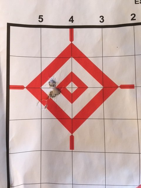

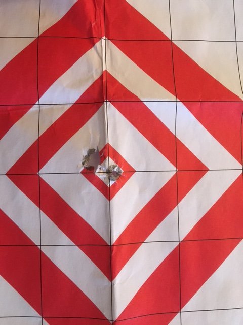

Team Prime came through and we had some 144 (Peterson Brass/Sierra bullet) for my wife's rifle...a short range session, but here is the down and dirty.
- Hawk Hill 26" chambered by Area 419
- A couple quick 3 round groups to confirm zero (these are shots 1-6)
-- Amazingly close to POA/POI of the Prime 130... 0.1 windage adjustment
-- Legit sub 1/2 MOA for these quick zero confirmation shots
-- Vel was running a bit slower than the the 2720 on the box; avg 2690 with SD of 12 (only 9 rounds. about 40degrees, DA -500)
- Shot well out to 1000....have not reviewed data but initially kestrel was way off, may have fat fingered something.
- Drop was a tad more than expected, but once dialed in, held the waterline on the steel very well. Vertical seemed quite consistent at distance; stacked them up nice at 800. Notes show drops: 600 : 4.3, 800 : 7.0, 900 : 8.4, 1K: 10.4. However, the 1K often has some weird light and the steel was pretty shot up so spotting impacts was tough...so take that DOPE with a grain of salt. It was near center-line, but we need to re-validate that when it is not snowing!
Edit: G7 BC 0.265 @ 2690 is lining up pretty close with the limited data we have so far.
FY was very happy with the results...Prime continues to shoot very well for her!
