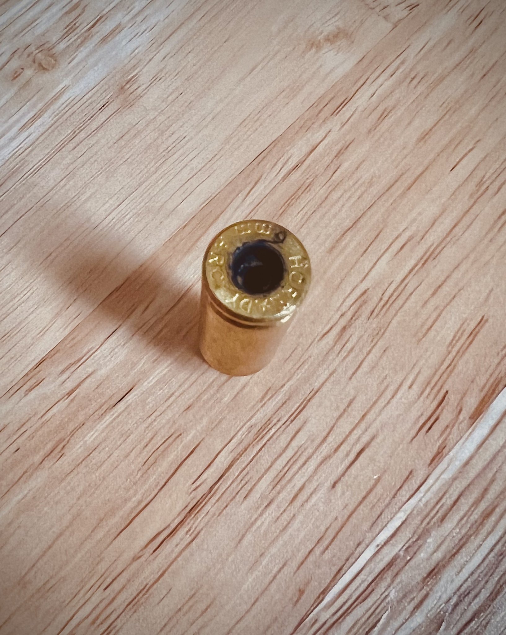

Loose tiny bits of brass? From what? I can’t tell from the pic but did it blow your flash hole out??
Good point! I just grabbed a loupe and examined the case - looking into the inside of the case at a bright light. The primer flash hole on the case is definitely no longer round it has a straight edge about 1/4 the length or more of the circle's edge.

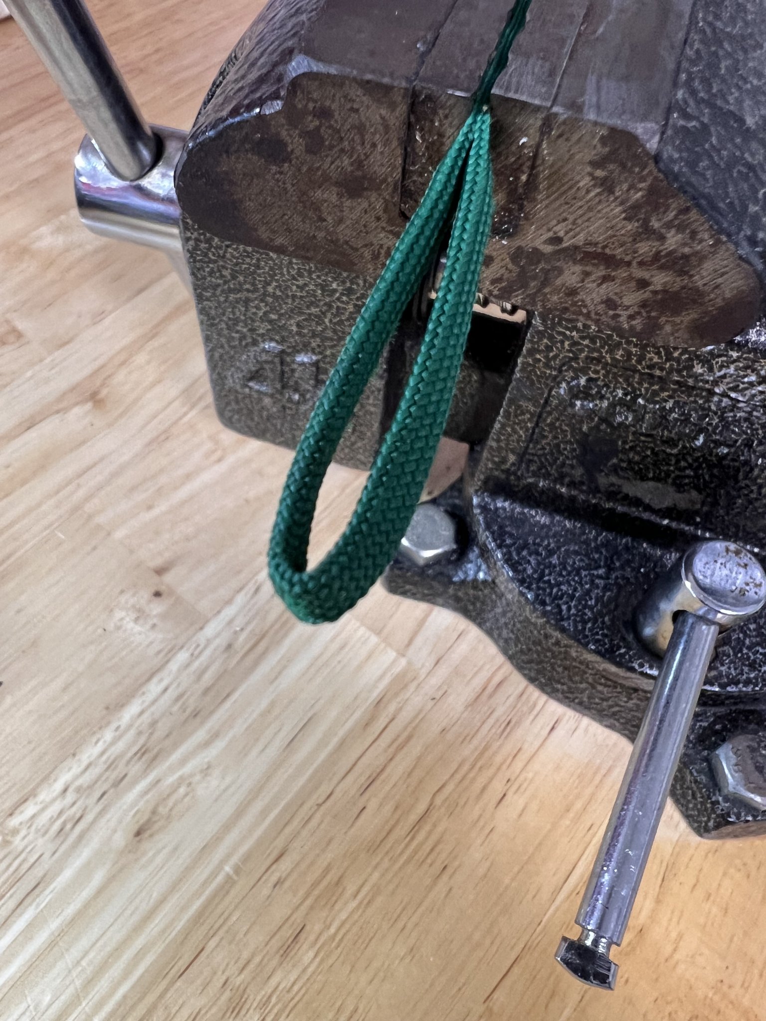

Another great idea! Woke up early this morning, grabbed some paracord and it worked! Kind of a pain because my action doesn't have a slot to put a washer in it so I had to pull and turn at the same time. I got it done but I'm still getting the Fix-It Sticks tool. Already ordered it from Amazon.

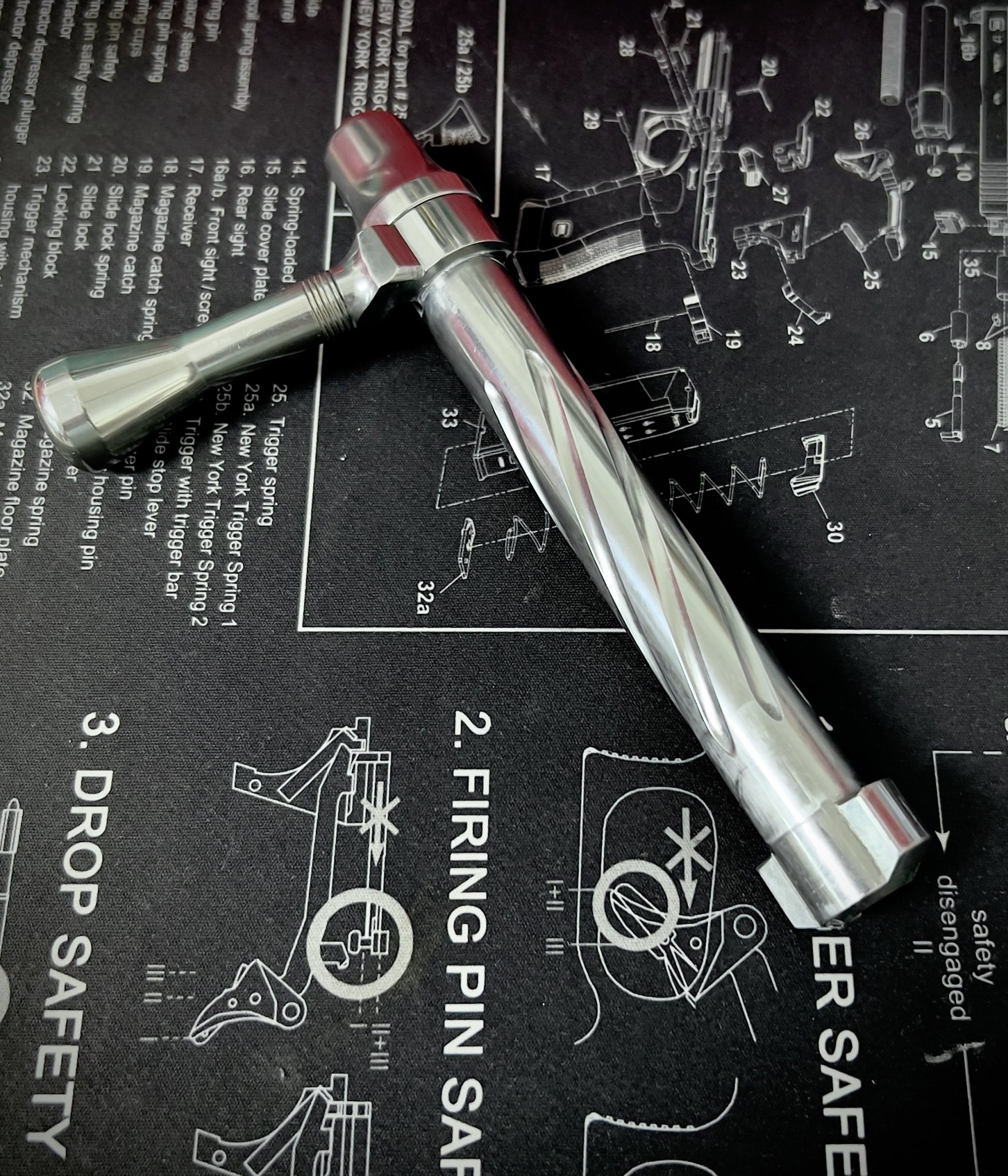

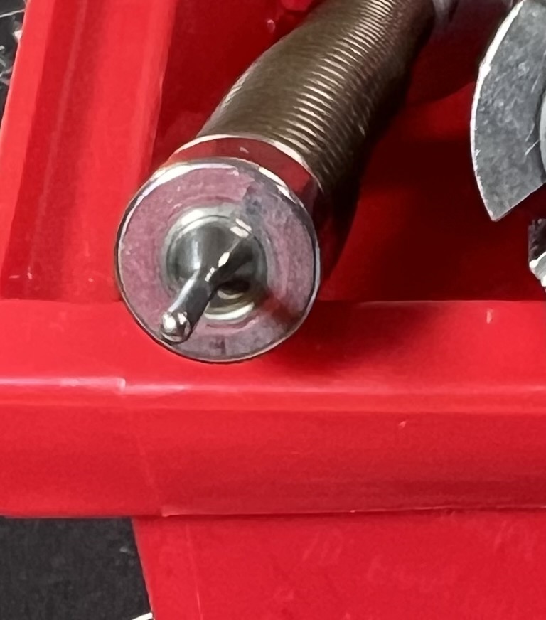

And :) the firing pin is in perfect shape. Nothing went into the bolt body and everything is great shape there....

How I rigged the paracord - took the nylon strands out of it :

The firing pin tip:
Bolt all back together. The outside of the bolt is greased because interestingly, although Defiance Machine's actions are stainless, the bolt are polished steel on the white. Apparently they are stronger than stainless but they can also rust:
