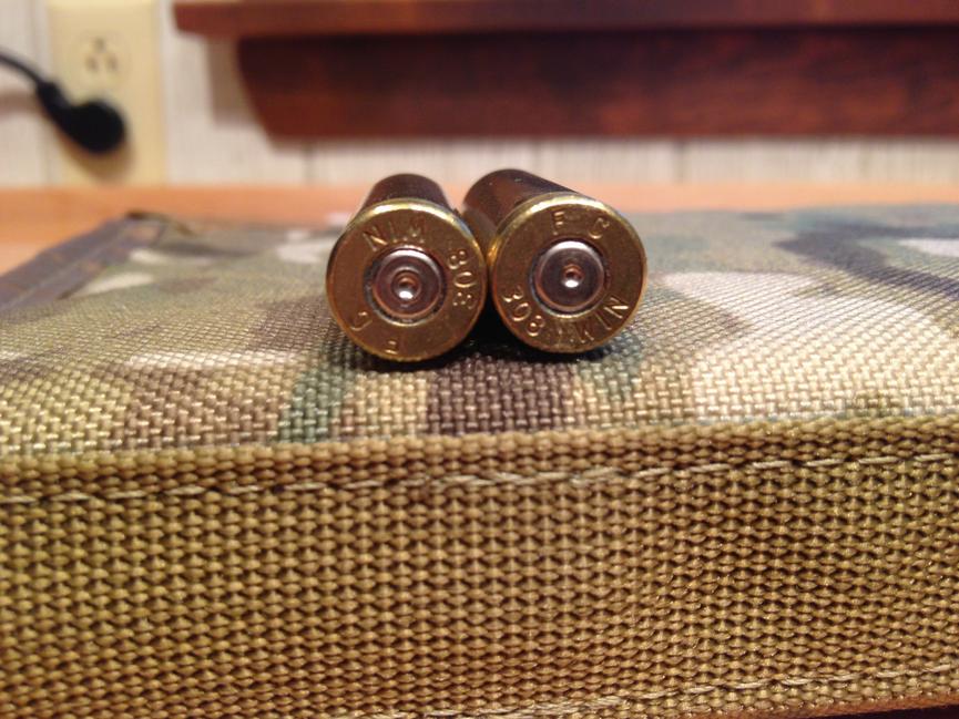

I have two Remington's and noticed this put of the 20in gun. See pic. 20inch gun on the left, 24inch on the right.
Doesn't matter if it's my reloads or factory FGMM. It does this with everything that's been through it.

Cratering usually comes from a poor fit of the firing pin to the bolt face hole, barrel length has no effect.
When I saw your thread topic I immediately thought remington. Primer flow is very common in these rifles. Nothing to be concerned about. Additionally, keep increasing your charge weight, you will likely find another node around 44.5g.
The only caveat is if you are having ejector swipe or a tight bolt ejection, then I would back down charge. Otherwise, sounds like you should go with 42.6. There won't be a significant difference at 500 yds with those loads.
I agree. Cratering like this shows the primer metal is flowing back into the firing pin hole and around the firing pin itself. Ask a good 'smith about getting your bolt bushed for the right firing pin diameter. There are a few on here that do it for a decent price.
