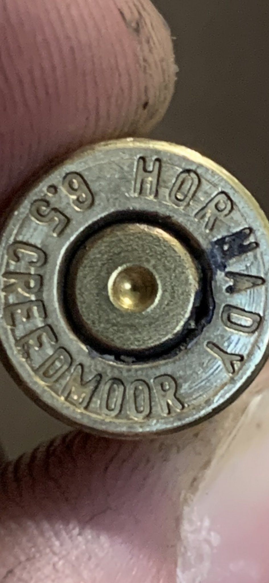

I’m looking for opinions on what caused 2 out of 20 primers to “blow out” today.

Wasn't it a batch of WLR large primers that was rupturing right at the corner of cup? Is that not what we are looking at? Its kind if a bad picture.

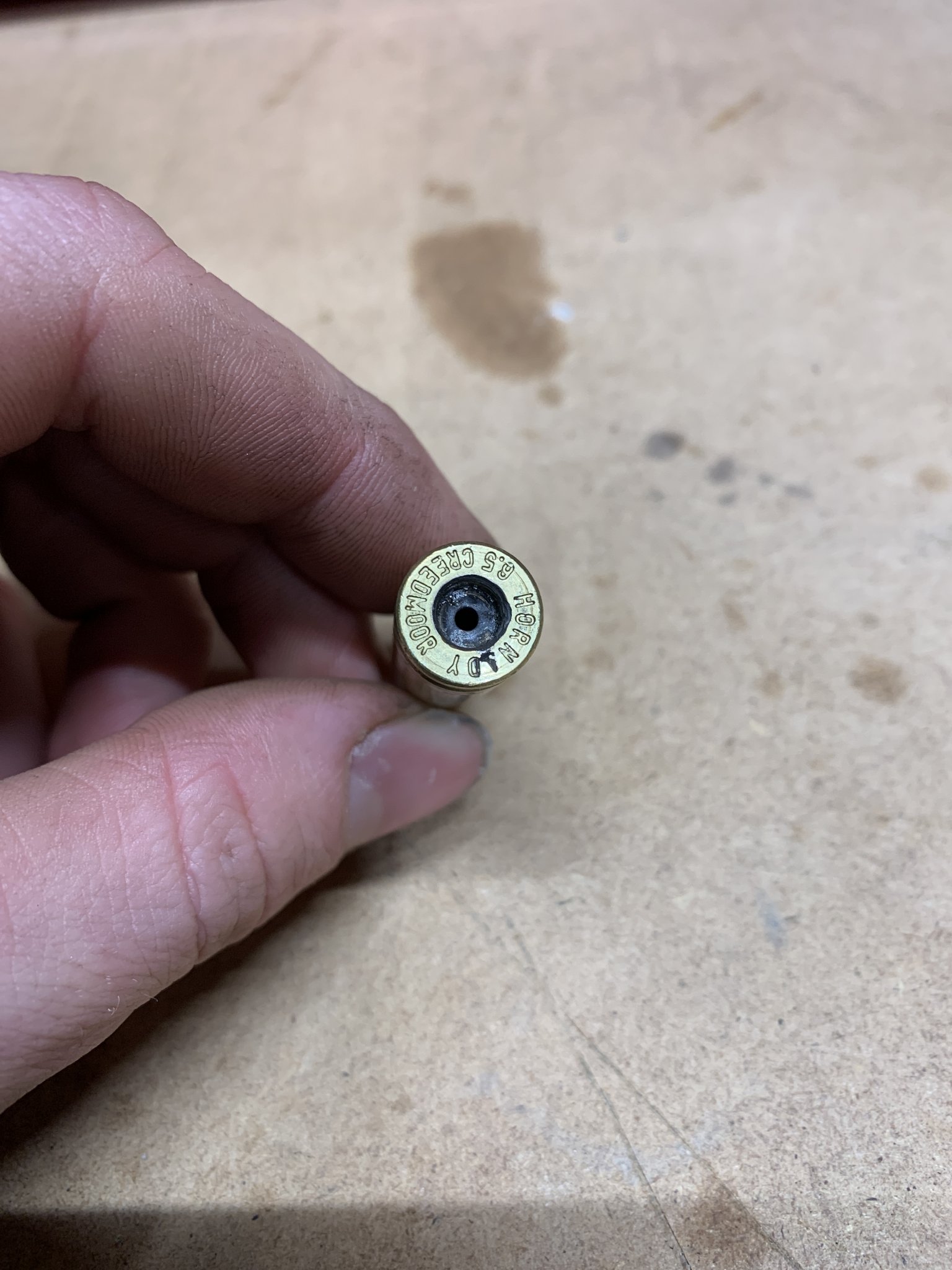

I haven’t decapped it yet to investigate, but I will tomorrow and post back here.

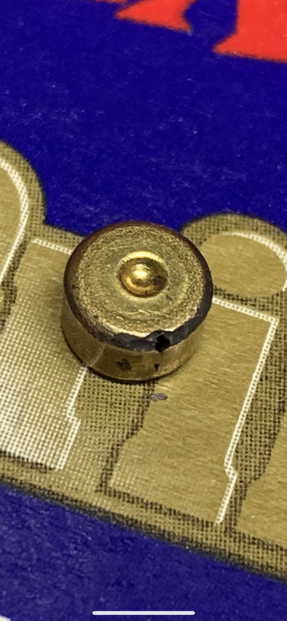

As supercorndogs and others suspected, there is a pin hole towards the edge of the primer cup. I’ve also attached pics with what the box looks like, and lot number
