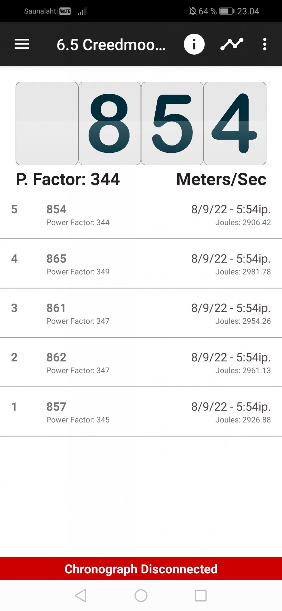

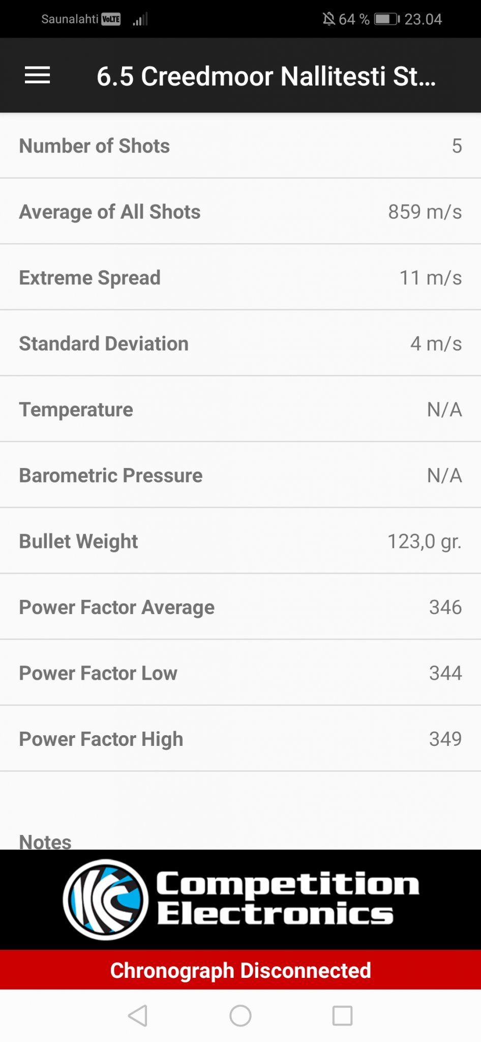

I have had a long time wish to test, does the small primer pocket has anything better, than large rifle primer in Lapua brass and
popular 6.5 Creedmoor caliber.
Received finally the LR brass from Lapua to test it.
Competition Electronics DLX chrono was the measuring tool, i like it better than labradar, it will work, no matter how you shoot thru it.
I have read a document few year back in G&A, and there the sr primer pocket was better.
I had 123gr Scenar and Vihtavuori N150 38,6gr in both cases, both cases were brand new, none shot.
SR is CCI magnum 450, and LR CCI 200.
Check out the results.
I know that when I tried small primer brass with 450s and Staball in my 6.5 the ES was horrible.

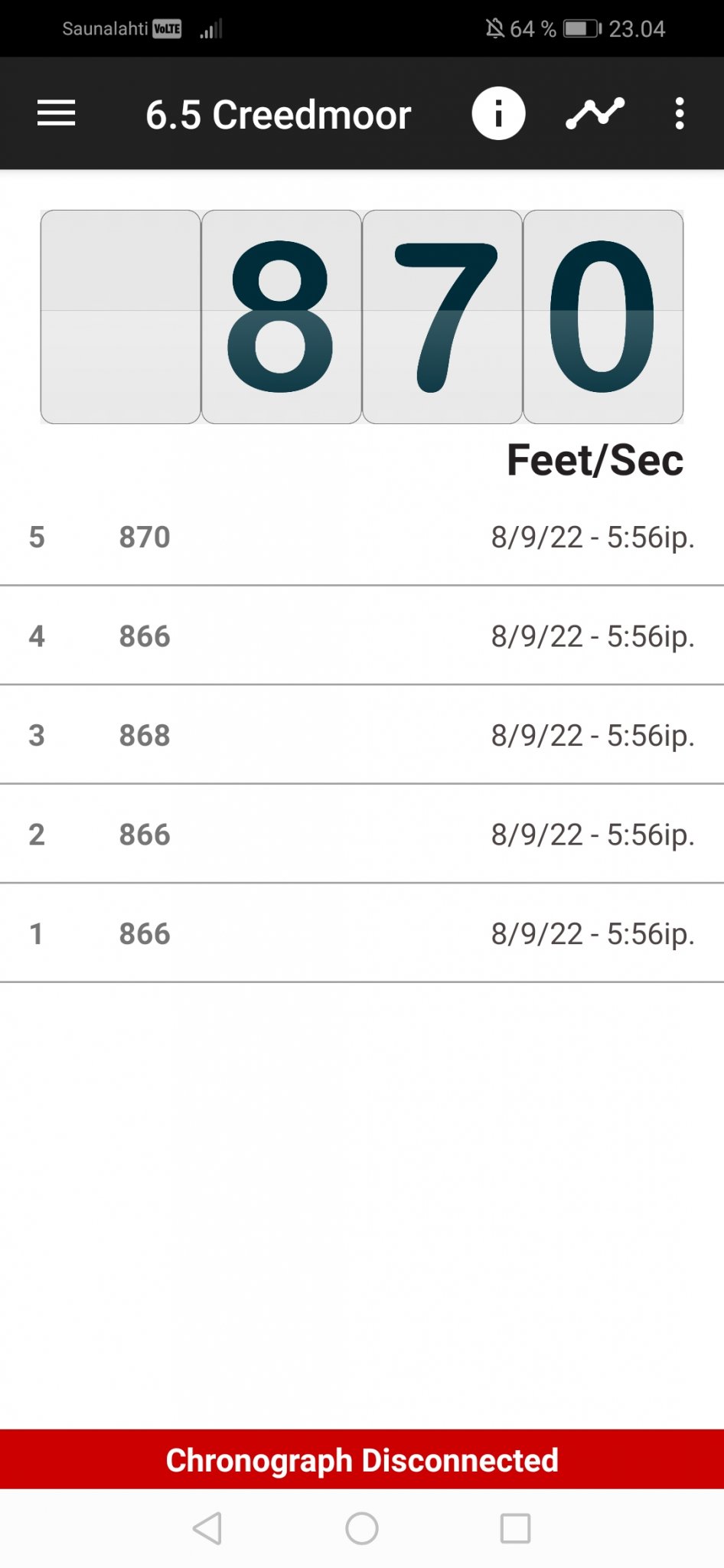

THIS WAS WITH THE LARGE PRIMER.

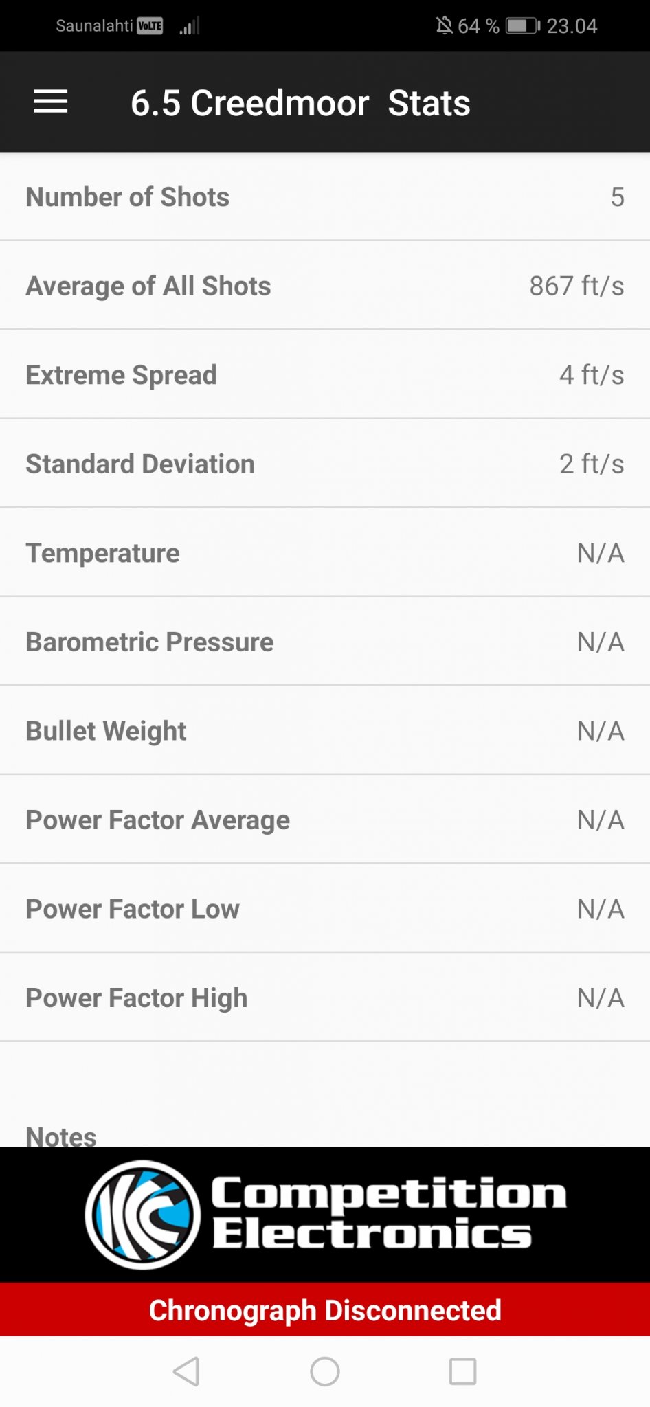

Thanks for posting. This is a perfect example of performing a test and comparing the results. There are standard methods for analyzing test data and comparing both means and standard deviations to see if they are statistically significant. For testing two means the test is called Welches T Test which is a variation of Student's T test. For variance/standard deviation its the F test. Using your data here is the result of that analysis:
Mean:
"1. Ho hypothesis
Since p-value < α, H0 is rejected.
The average of Group-1's population is considered to be not equal to the average of Group-2's population.
In other words, the difference between the sample average of Group-1 and Group-2 is big enough to be statistically significant."
Standard Deviation
"1. Ho hypothesis
Since p-value > α, H0 cannot be rejected.
The standard deviation (S) of Group1's population is assumed to be equal to the standard deviation (S) of Group2'spopulation.
In other words, the difference between the sample standard deviation (S) of Group1 and Group2 is not big enough to be statistically significant."
These results were from the following links:
This doesn't mean that there isn't a difference in Standard Deviation but based on probably and the number of data points we can't rule out the possibility that the results are equal. If we have more data its possible that the results would be different.
Good catch but I assume its just an APP error in display. Anyway the comparison is valid for the data.
By the way, in the analysis there are two hypothesis that are assumed.
Ho is that the two values being compared are equal.
H1 is that the two values being compared are unequal.
The test is applied to Ho which if untrue then H1 is true.
Can you trust this data? It’s showing 870 “Feet/Sec”. I realize it’s probably a typo but…
I can not get the measure to be m/s on my cellphone, even i do switch it to meter, but the reading is feet, but it its m/s, because i selected it to be so from the chrono.
Software does not support m/s on the driver for that competition electronics, or i am not doing the change right way :)
