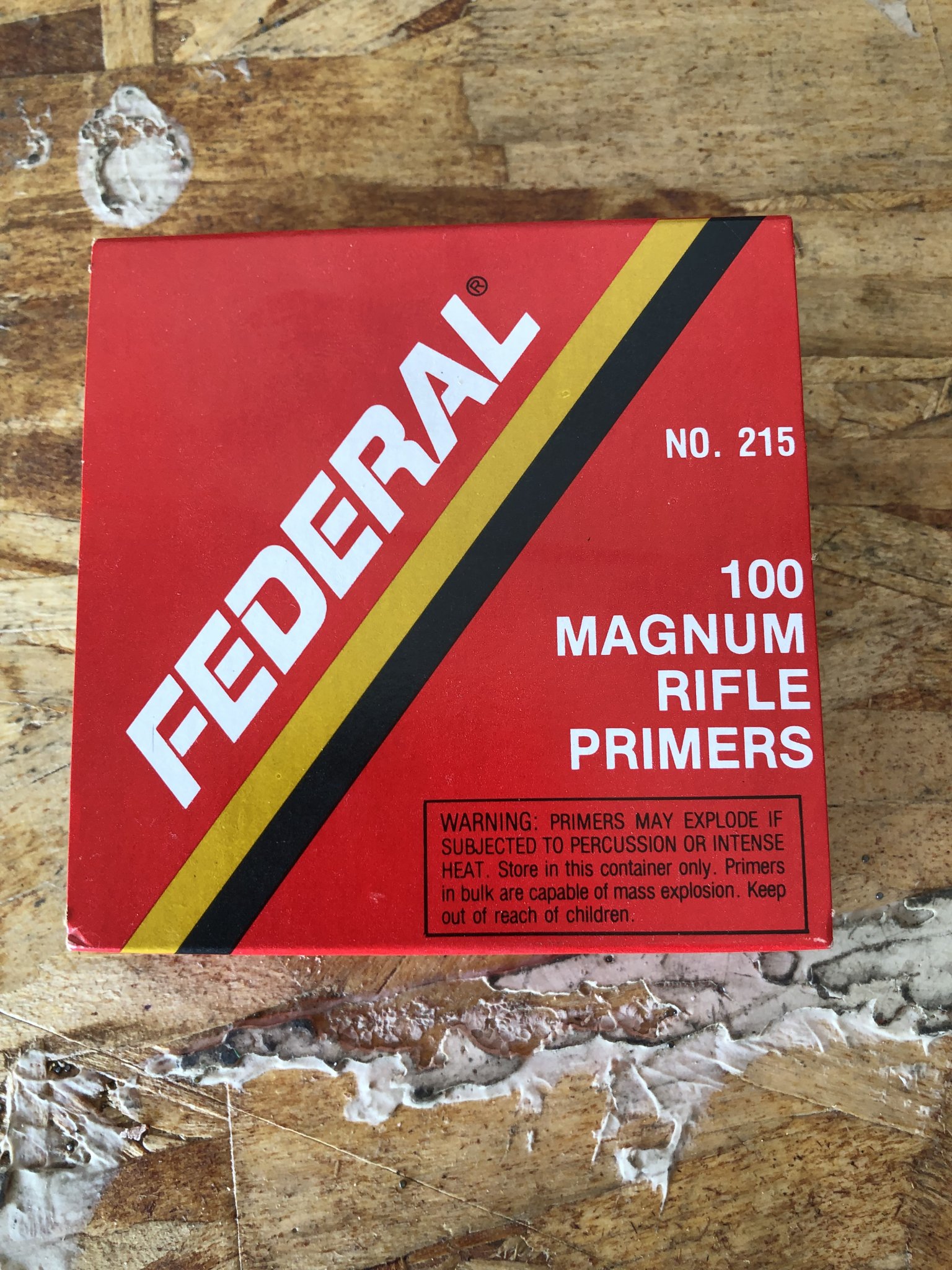

Speaking of primers any guesses on the age of these? Never seen these boxes
Those primers are from the 70's through the 1980's. I have a few of the same 215's left.

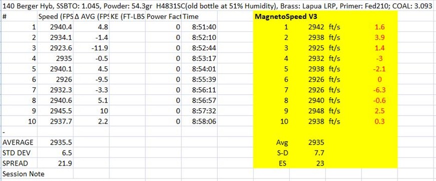

My issue with Chronos (a minor one) is that they are typically considered accurate in their accompanying literature to +1%/-1% of the indicated value.
1% of 2500fps would the be accurate to +25fps to - 25fps. That spans a range of 50fps. I would not consider that range to be small enough to give any real meaningful help when doing load development. An indicated value of 2500fps could refer to velocities ranging from 2475fps to 2525fps.
But I may not be the right person to be making this observation. I do own a Chrony Alpha, FWIW

Some Chronos are more accurate than others. For example:
Here's an example where I compared my MagnetoSpeed v3 to my new Xero C1 and note the average speeds:
