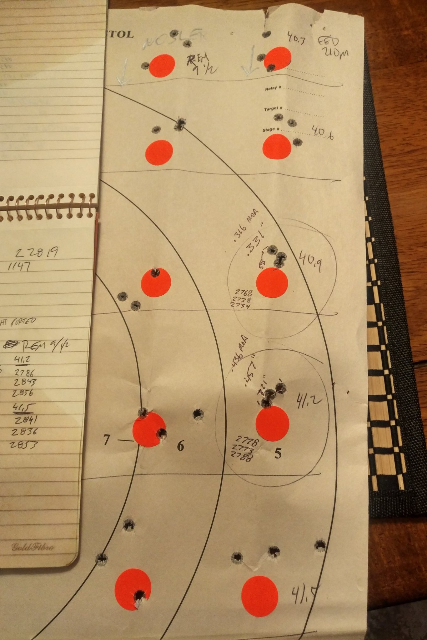

    When I switched from Remington 9 1/2 to 210M, my velocities dropped, but my ES/SD's got much tighter as did the groups....
    Remington primers on left column, 210M right column.... Same brass, same bullet, same powder charge... the only variable changed was the primer.

    That makes PERFECT sense. With Reloder 17 (high energy powder) the groups were all over the place with the Remington primers. With the Federal, everything tightened up.
