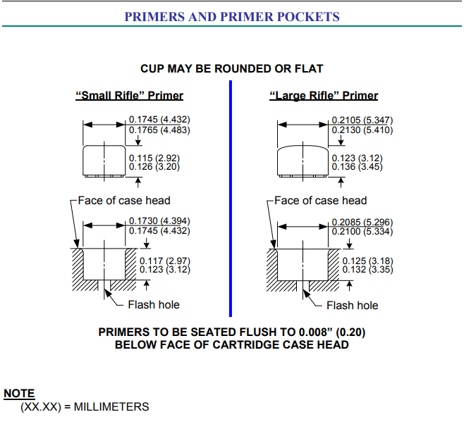

Primer specs from saami if you wanted to compare
Reactions: LG65CM
