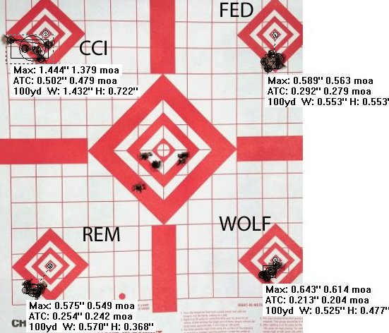

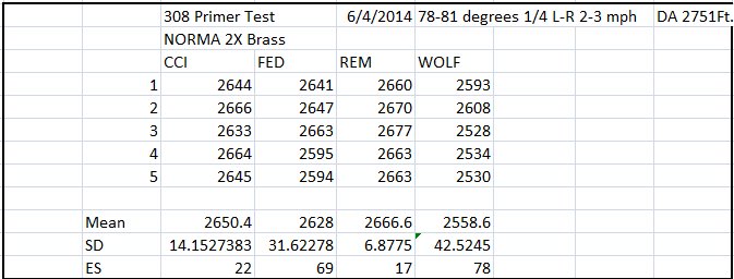

Rem 700 5R 308. 175 SMK, Norma Brass, Varget - 44.4 Gr. I think I really like the Remington LR Primers.
Good Luck,
