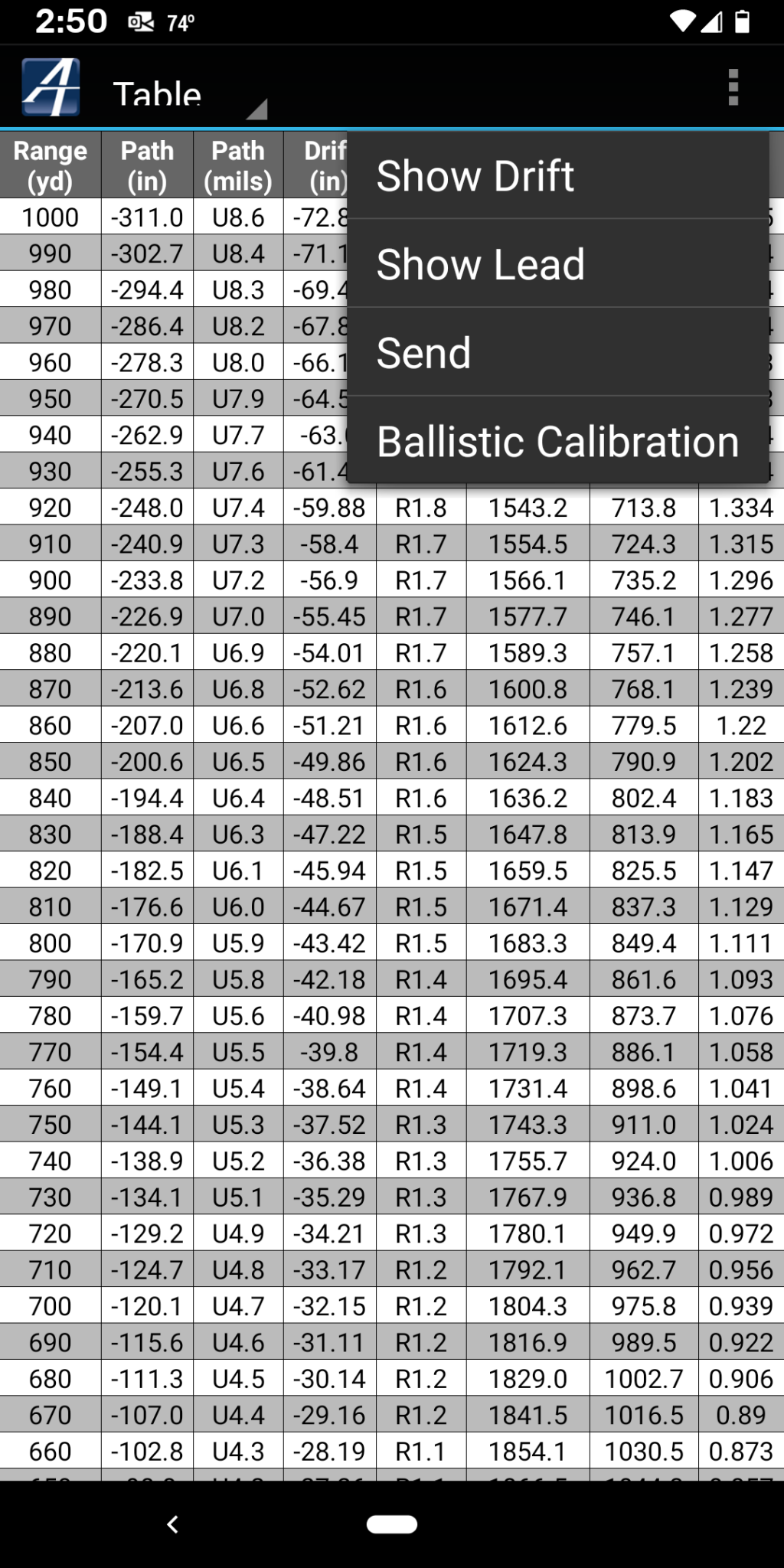

Open up the table and click on the three dots in the upper right hand corner and click send. It will convert the table to CSV, which can be opened with Excel or Google Sheets, and you can then email it to yourself and print it off.
