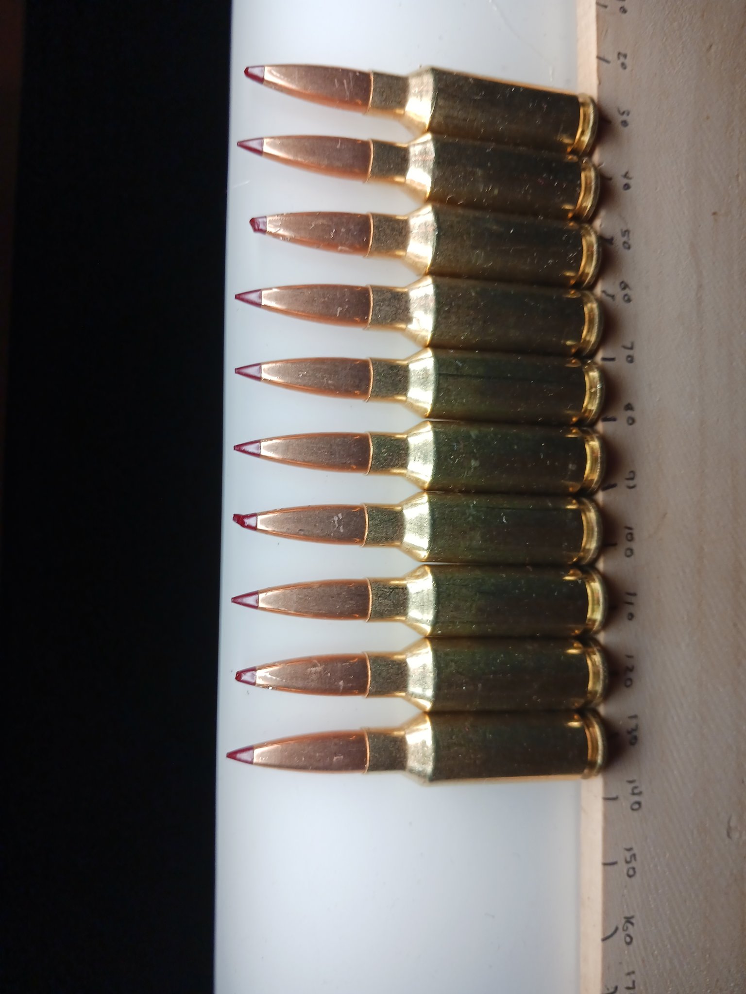

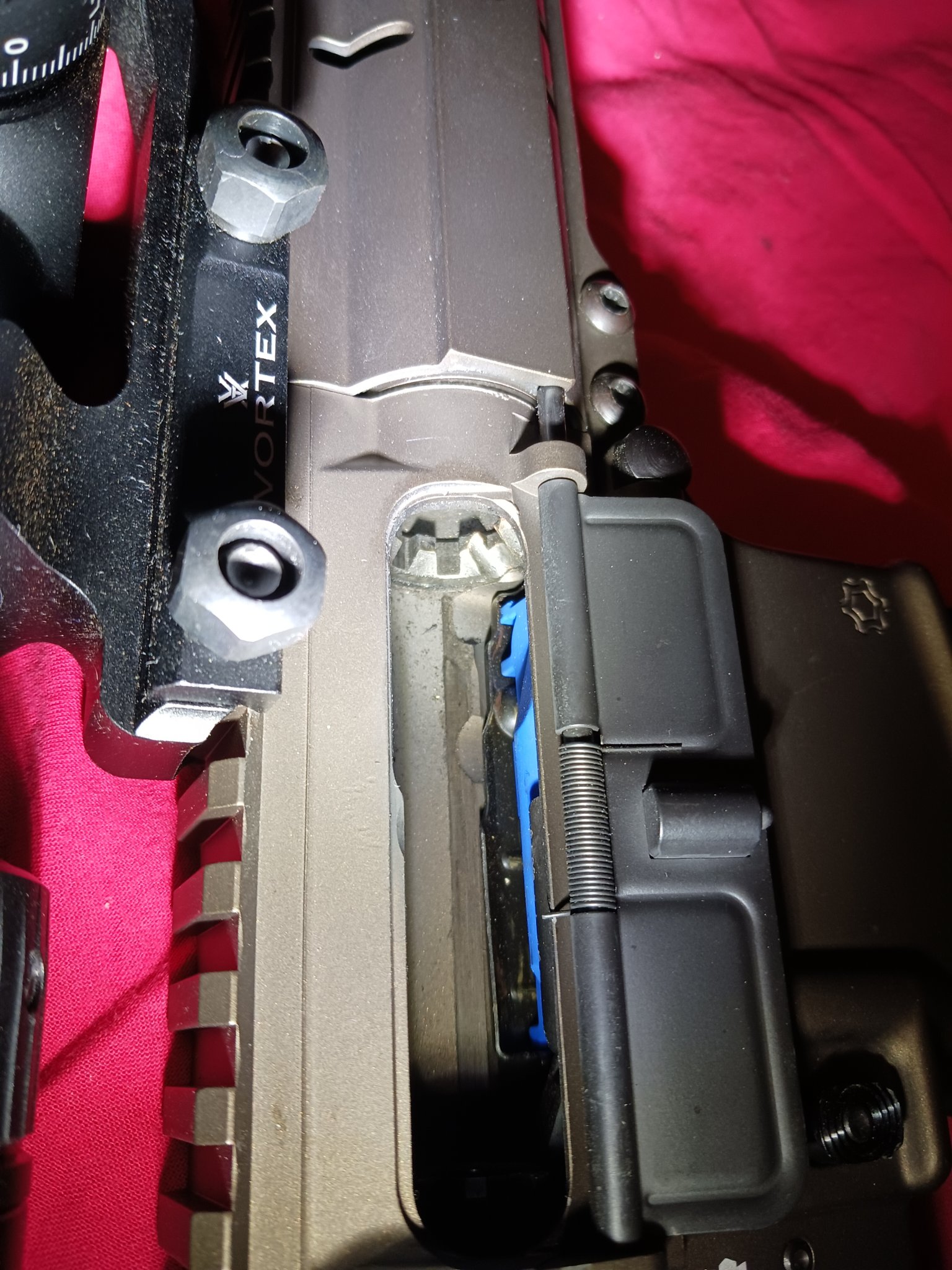

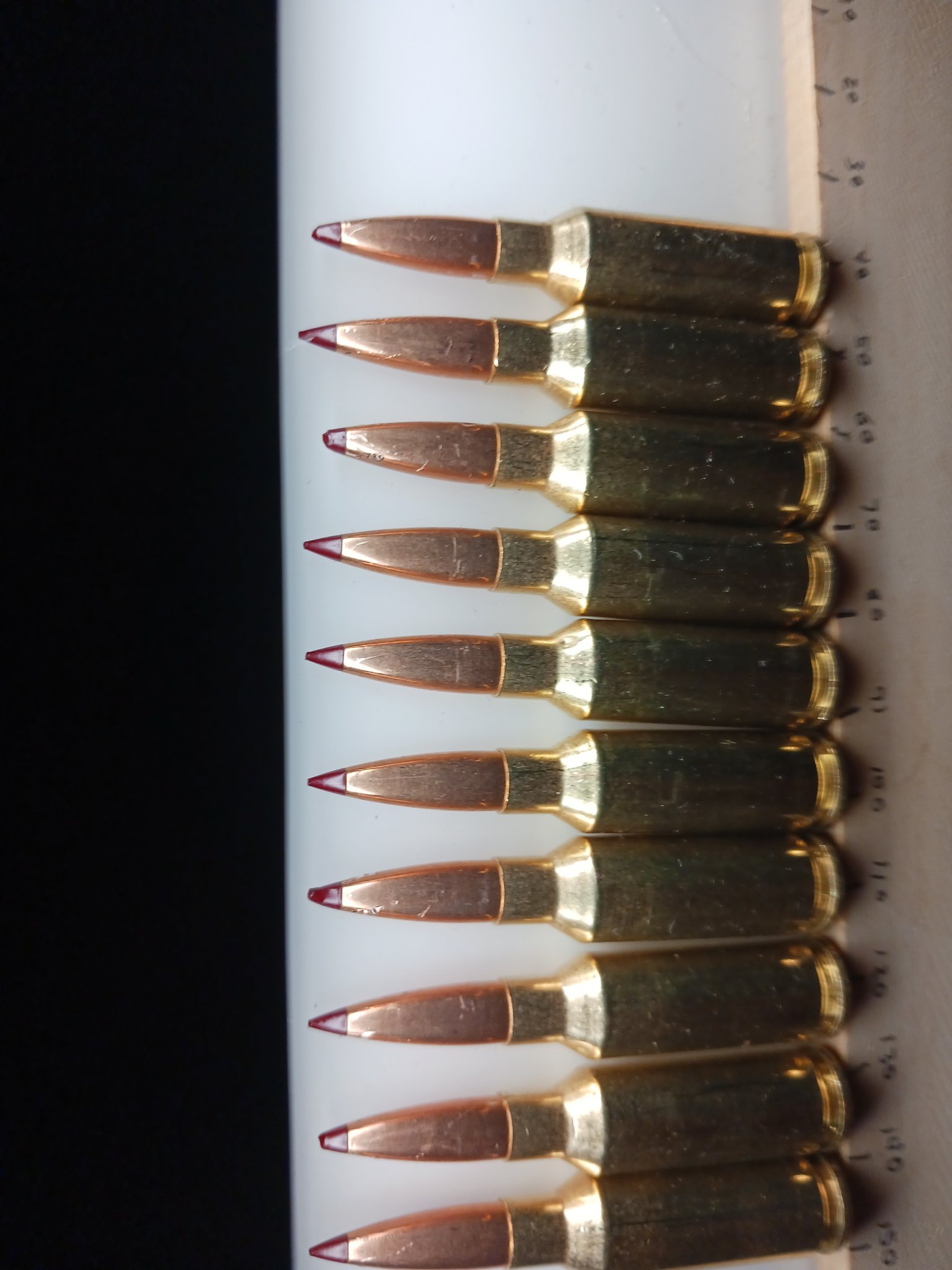

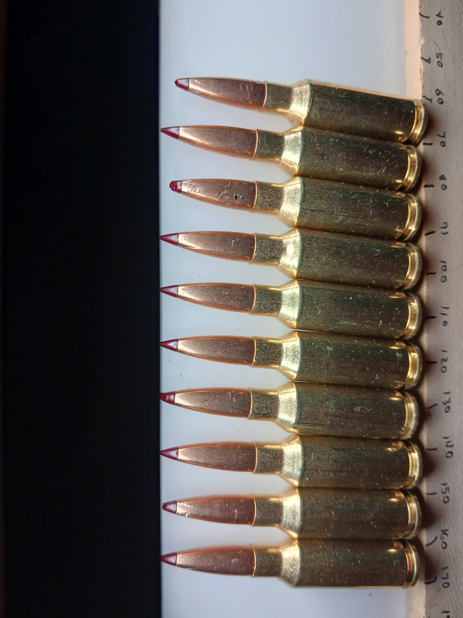

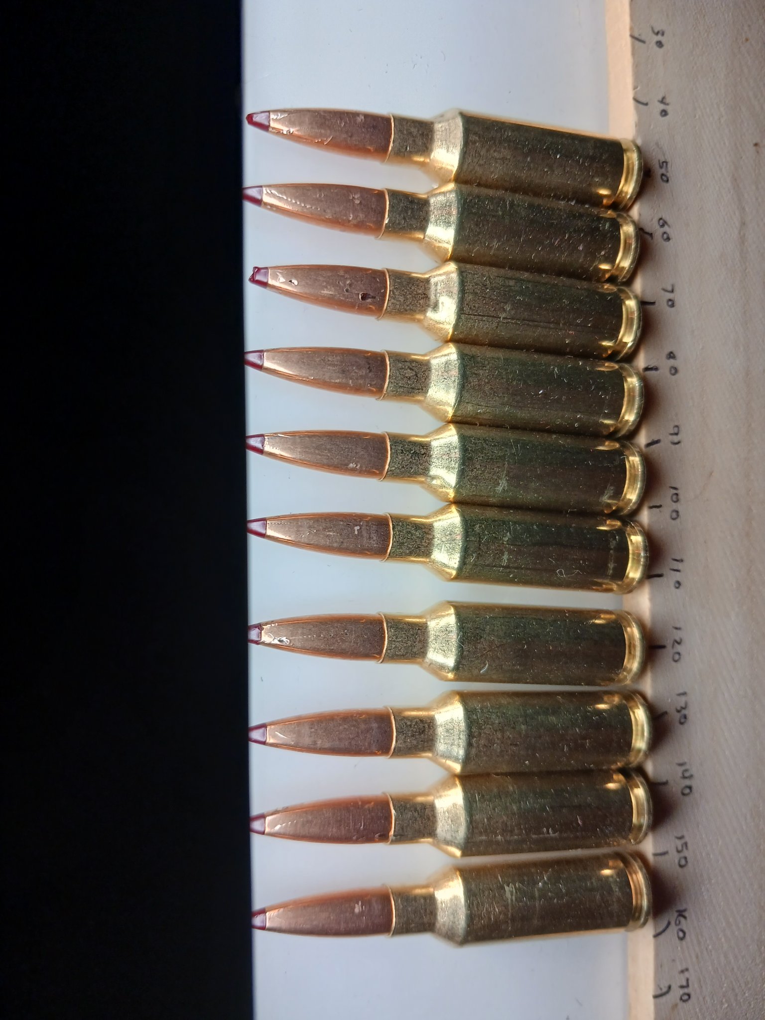

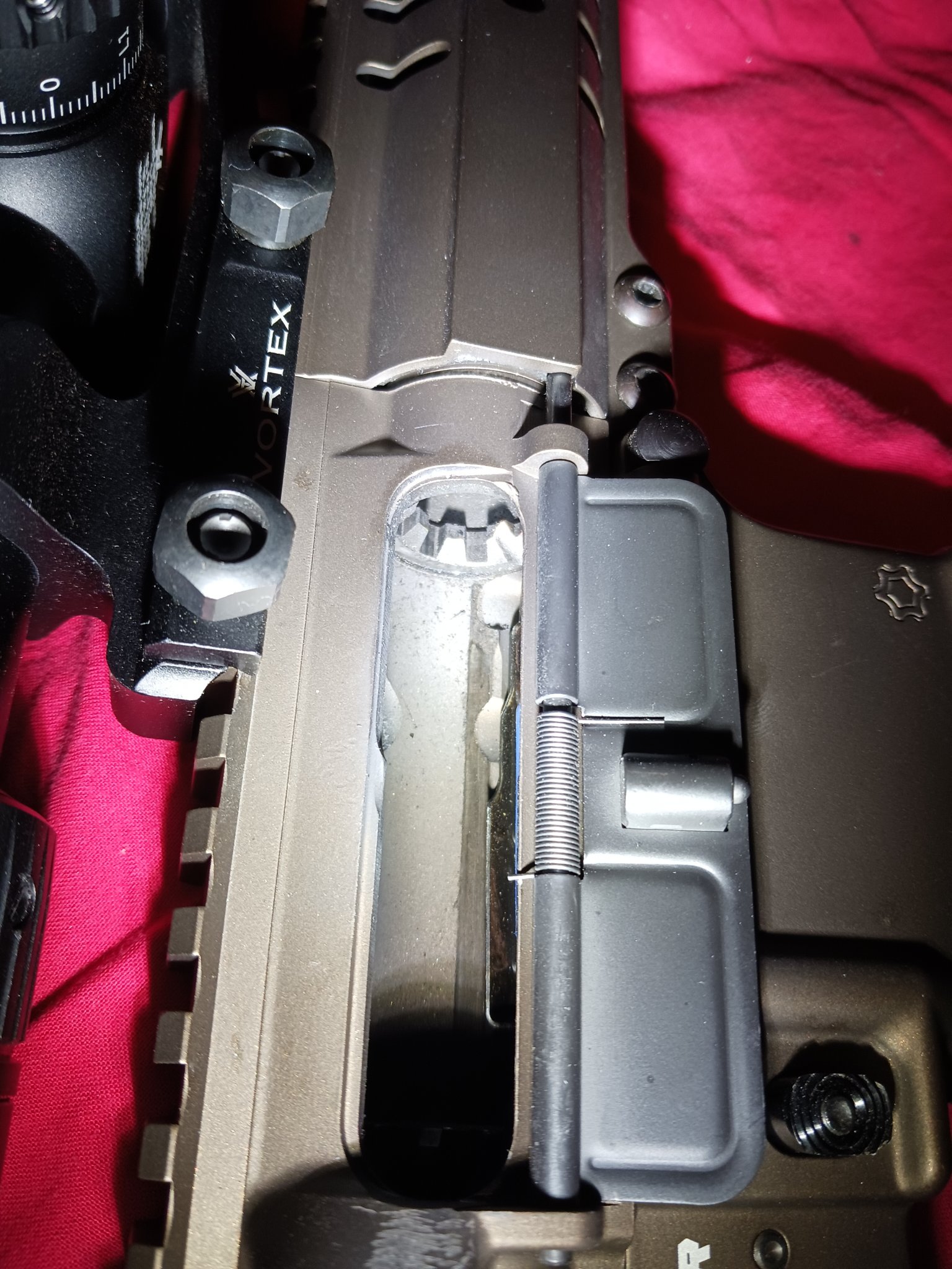

I ran one magazine of 10 through the CMMG, just ejecting one after the other. The pictures included here show, as well as I could manage, all the rounds side by side and rotated slightly from one picture to the next. There are certainly some interesting blemishes. Some certainly look like what I would call gouges. I was less successful showing the chamber and feed ramp, but I uploaded what I got and will try again tomorrow for better positioning.

Those are pretty roughed up. It's kind of tough tell in the pictures but it looks like I see copper on the edges of the feed ramps. I don't know if it's enough it's the cause of your bullets failures.
I was very surprised how roughed up they were. I knew the ramp picture was almost useless. Made with phone camera. My borescope arrived. We have guests for a few days who are not 2A fans, so I won't get everything back out until after the weekend. I should be able to take some excellent pictures with it. Teslong Rifle Borescope + Smart Endoscope app for Android. First tests were very nice.
