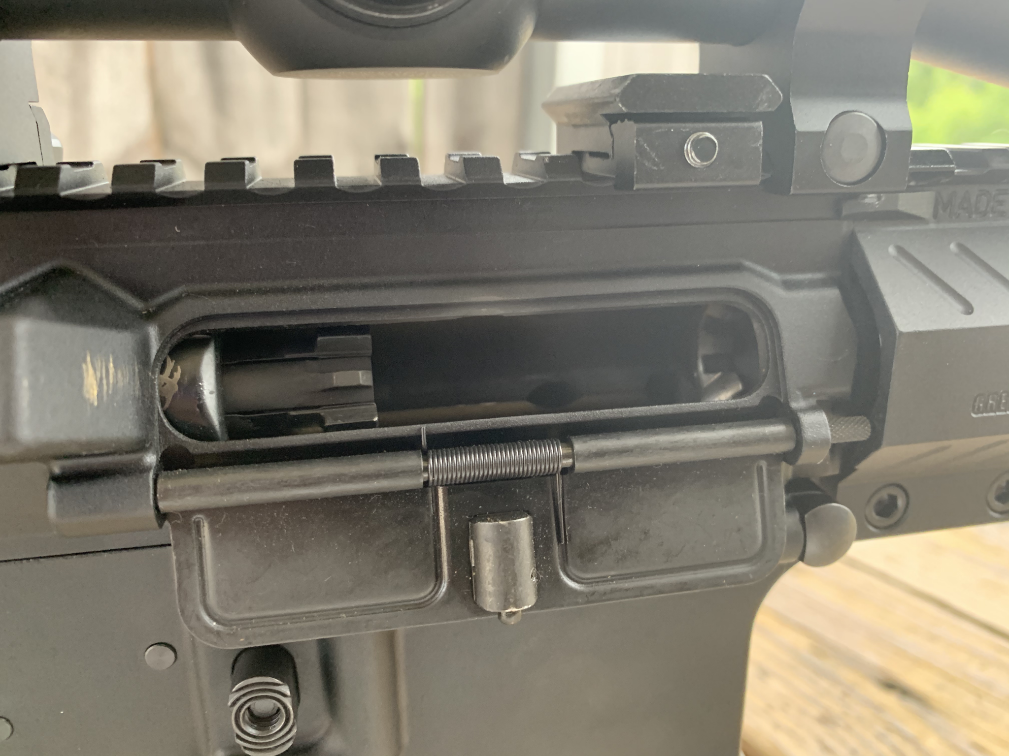

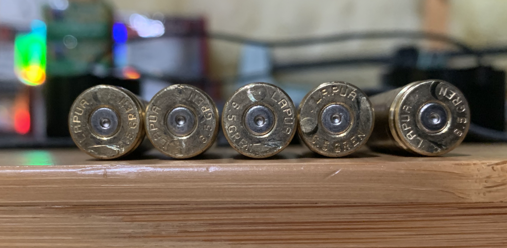

So I just built a 6.5 Grendel, bought the complete upper from Grendel Hunter (18" Mid Length) and I've taken it out to the range 4 times now. Every single time out it's had problems cycling and feeding the ammunition and the accuracy has been really bad. Sometimes the bolt doesn't want to lock back on the last shot, it's getting stuck trying to pick up the next round and sometimes not picking it up at all. Groups are averaging 2.0 MOA at 100 yards.

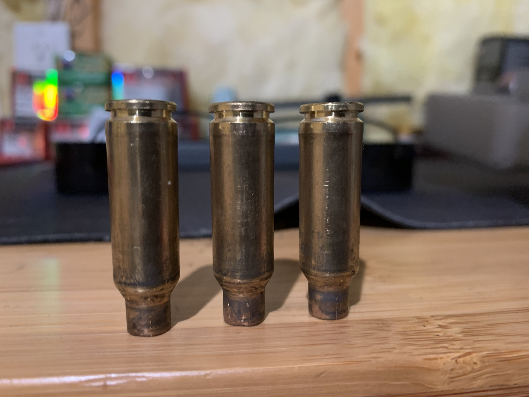

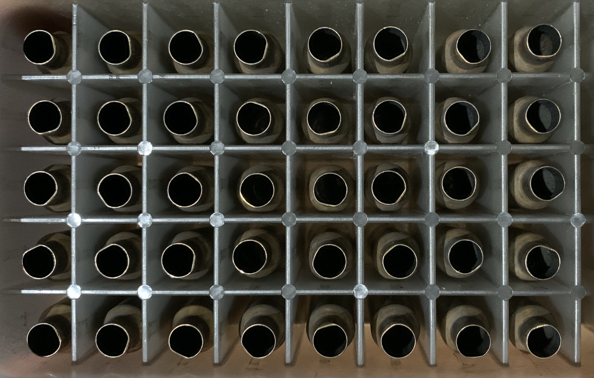

My brass is getting absolutely ate up by this gun, it's causing major dents around the neck of each round making a "D" shape in the case necks. When I measured the brass with my headspace comparator it grew from 1.210" (new) to 1.222-1.226" (fired) on average and the loads that showed pressure signs grew to 1.228 - 1.230"!!!!!! I was concerned that it could be excessive headspace so I checked it with a Go/No Go Gauge and they both checked out fine.
I was also running an H2 buffer and thought it might be short stroking so I put a carbine buffer in and it still did not want to cycle. The upper came with an adjustable gas block so I might need to try tuning that next. I'm using an ASC mag right now and I just ordered an E-Lander mag to try and see if the cycling is a magazine issue.

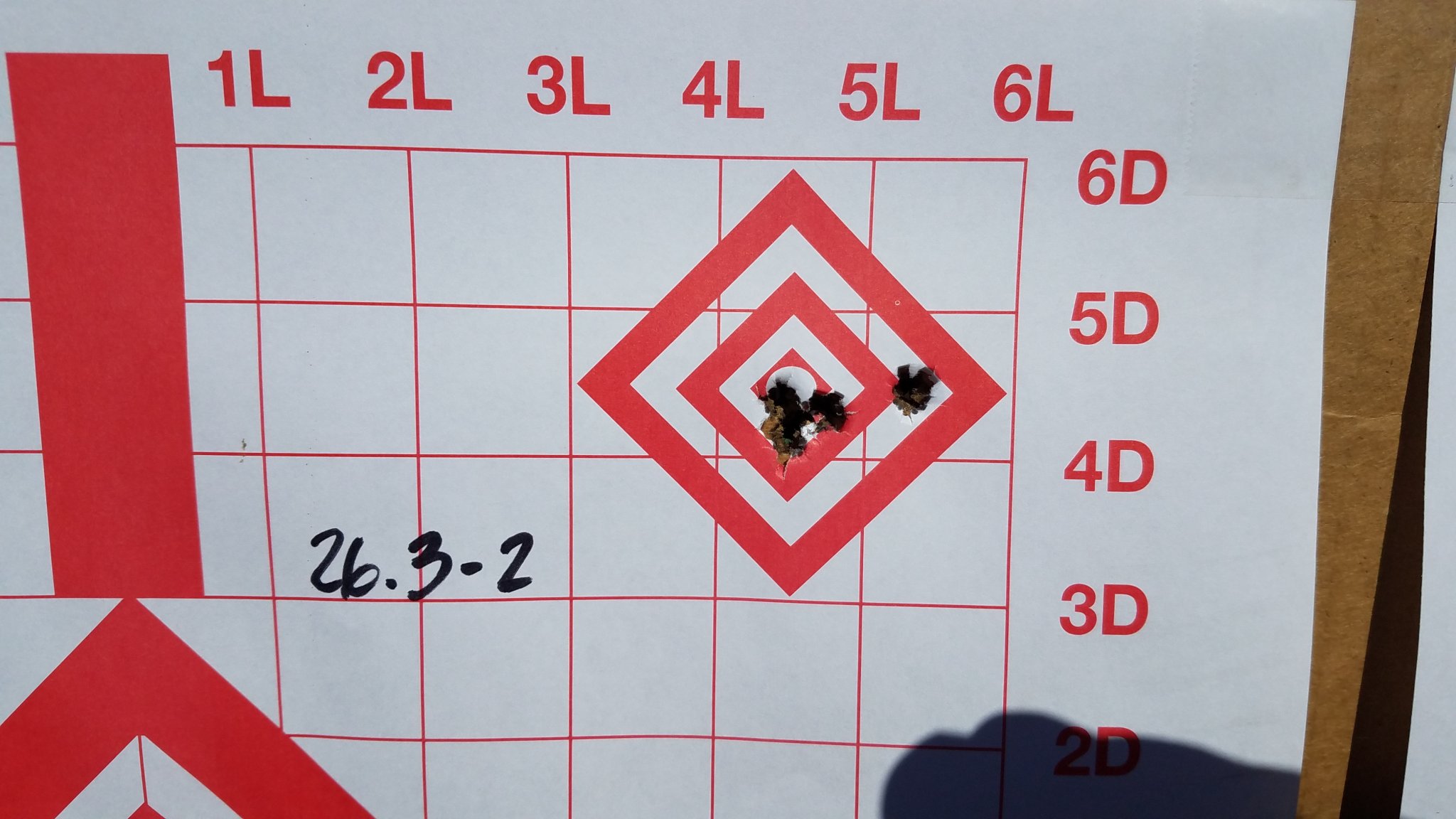

As far as accuracy I thought the problem could be a scope issue so I put another scope on the gun and it shot just as bad so it's not a scope issue. My next move is to buy some factory ammunition and give that a try. 95 rounds down range so far and not a single group below 1 MOA. I Did ladder testing with AR-Comp and IMR 8208 from 26.3gr up to 28.5grs. It seems like I can't go above 28grs with AR-Comp without getting pressure signs. I was able to go a little higher with IMR 8208. The gun didn't shoot either of the powders, bullets or primers well. Going to back down the loads again to 26-27.5grs and re test after testing factory ammo first.

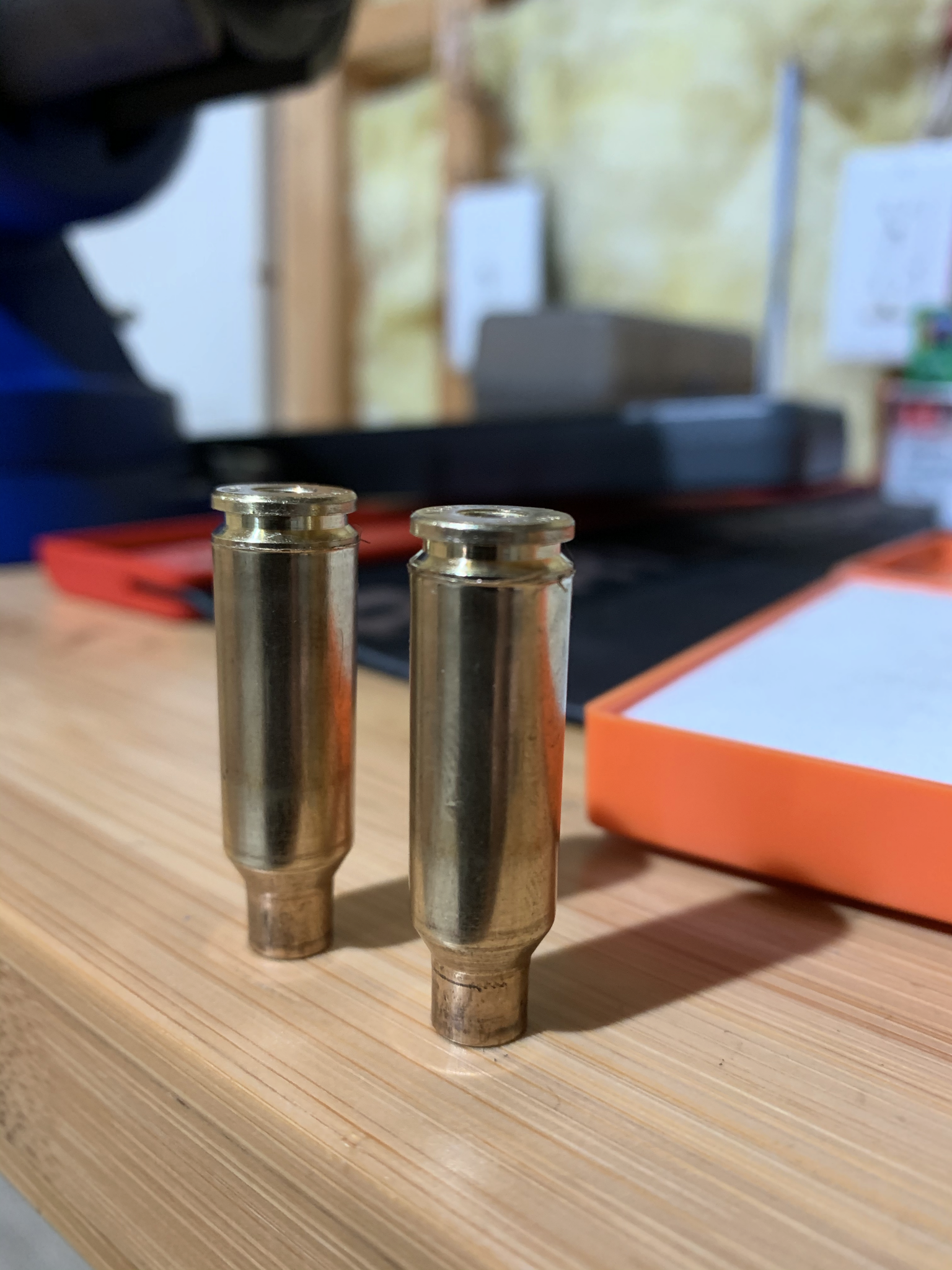

Dented Case Necks
Ejector Marks on case head
Bulging case head (The one on the right is the best example)
Ring of brass I got after trying to resize those cases
Best I could get at 100yds (Red dots = 1/2")

As far as cycling, maybe check seating depth. I ran handloads seated .020 off the lands and then realized I wasn't paying attention to mag length. (Idiot mistake) Seated too long. IIRC my jump is damn near .208" at published COAL. I'm not a gas gun expert.
I have an ER Shaw bull barrel and have had respectable results.
I don't know if my brass is dinged at the volume level you posted, but it does happen. No resizing issues (Hotnady dies) Can't speak to the length issue but don't recall mine needing that much trimming. Mine is an old Model 1 Sales upper / barrel setup. Maybe yours is chambered "deep"?
Over gassed? Loads likely too hot?
Yes, test with factory Hornady 123 loads.
Certainly see signs of excessive pressure in your third photo
Case mouths are being dented on the case deflector upon ejection is not uncommon
I ran a ladder of 123's up to 27.6 of 8208XBR with no pressure signs.
Reactions: Snuby642

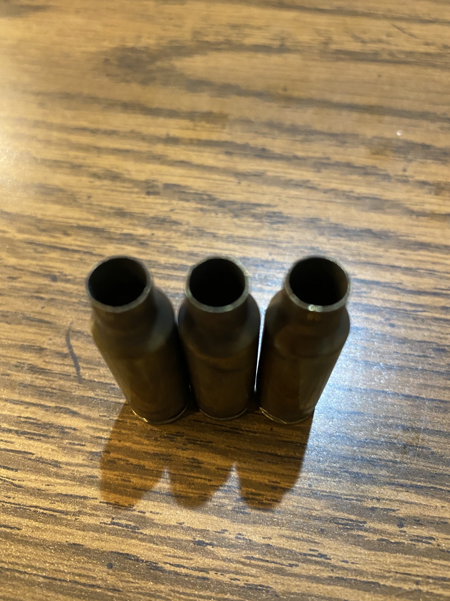

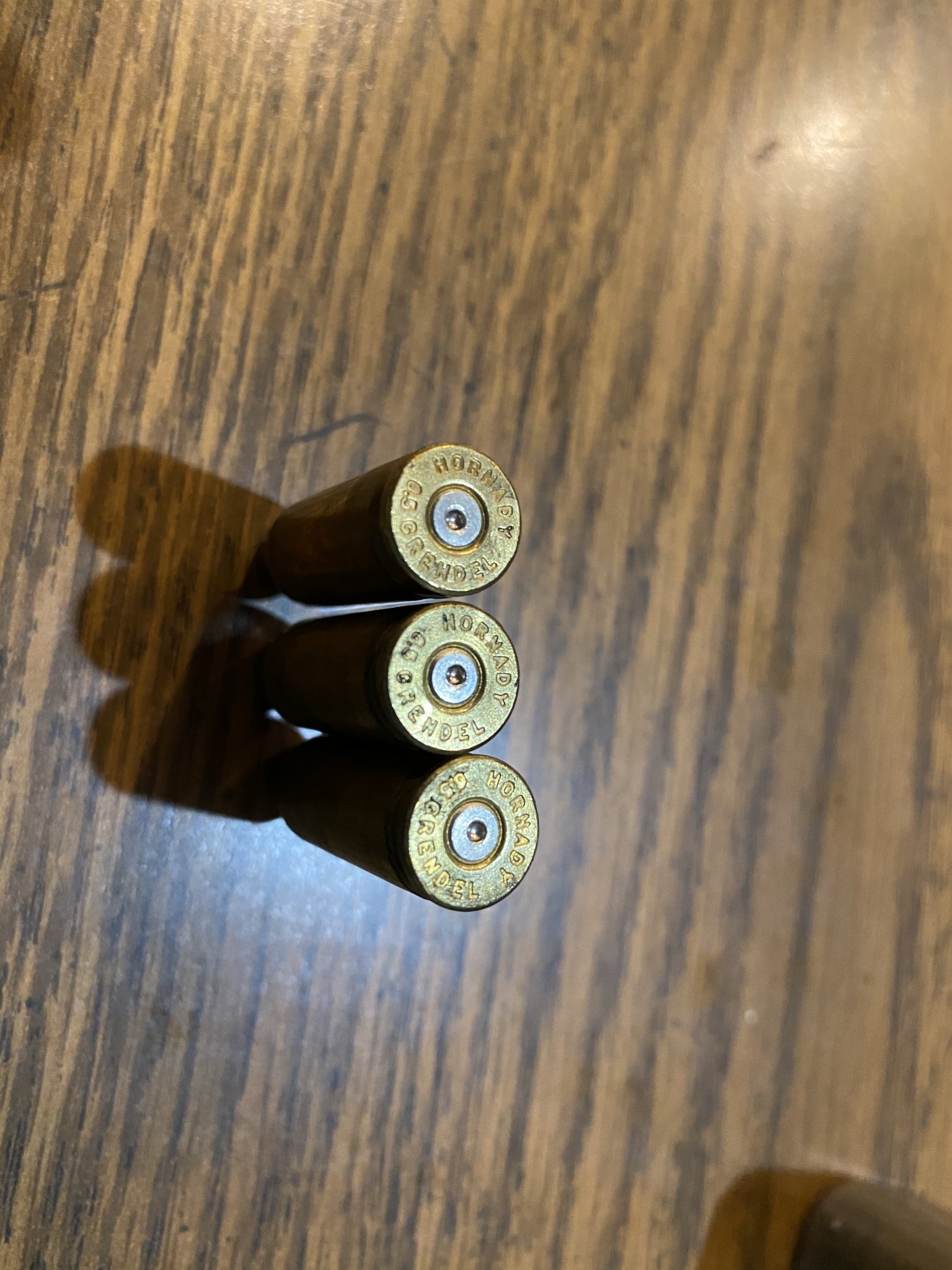

That brass is showing pressure signs, especially for a Grendel. Book max is 52,000 for the Grendel. I run 8208 under 123 Nosler CC’s in two different Grendels and brass doesn’t look like that. These are right at 52k pressure according to quickload. These are loaded at 2.250 COAL and cycle well in both of mine.
I agree just not sure why it’s showing pressure signs, my COAL is 2.250” as well.Are your loads compressed? I get a crunch when I seat the bullet even at 27.5grs
With the marks on your case heads, and the profile shot looking like you are trying to create a "belted" mag, I would dial the loads back significantly. You could check the headspace also with a no go gauge.

So that's .012-.015" case growth at the shoulder from new to fired. That's a lot. I'd suggest checking that chamber with go and no-go gauges.
That's what I was thinking because usually I only get about 0.003 to 0.004" case growth. I also have a case guage and the rounds with ejector marks on the case head would not fit in the case guage due to the swelling at the case head, I believe that's why when I tried to resize them they would not fit into the reisizing die without cutting that ring of brass. Just bought a go and no go guage though to check the headspace.

To me... your pics suggest early unlocking of the BCG, while the case is under considerable pressure.
And your charge weights might be high for your barrel / chamber / throat length ... etc.
I would tune the Adj. GB from fully closed to 100% lock back on a single loaded round. Carefully watching your fired brass cases for any issues.
IMHO, use factory ammo for your first testing w/ the Adj. GB... then try your reloads.
I could be completely wrong... but your issues suggest to me, a large gas port.

This is the barrel I'm using in 20", and the 24" one is the one where the extractor failed. I have a second 20" on standby in case I want to build another or just do away with the 24". I believe the modifications needed to convert the 223 bolt face to the Grendel dimensions weakens the extractor to the point where excessive loads cause breakage, and that the 6.5 Grendel is an exception where failure occurs well before pressure signs complain significantly. Literally, my extractor went at .1gr over published max. Where Midway sources its AR Stoner barrels is a good guess. I did a whole lot of looking around on the Internet, and came up with strong suspicions that at one time they were Bear Creek, and that later (now?) they are Liberty.
Right now I'm very happy with my Grendel;s, and I strongly suggest you back down the charges because I think you are probably on the verge of losing an extractor, just like I did. The 24" is now assigned for Varmints with the 90 TNT, and the 20" is for deer sized game or smaller with the 120 Gold Dot.
Greg
