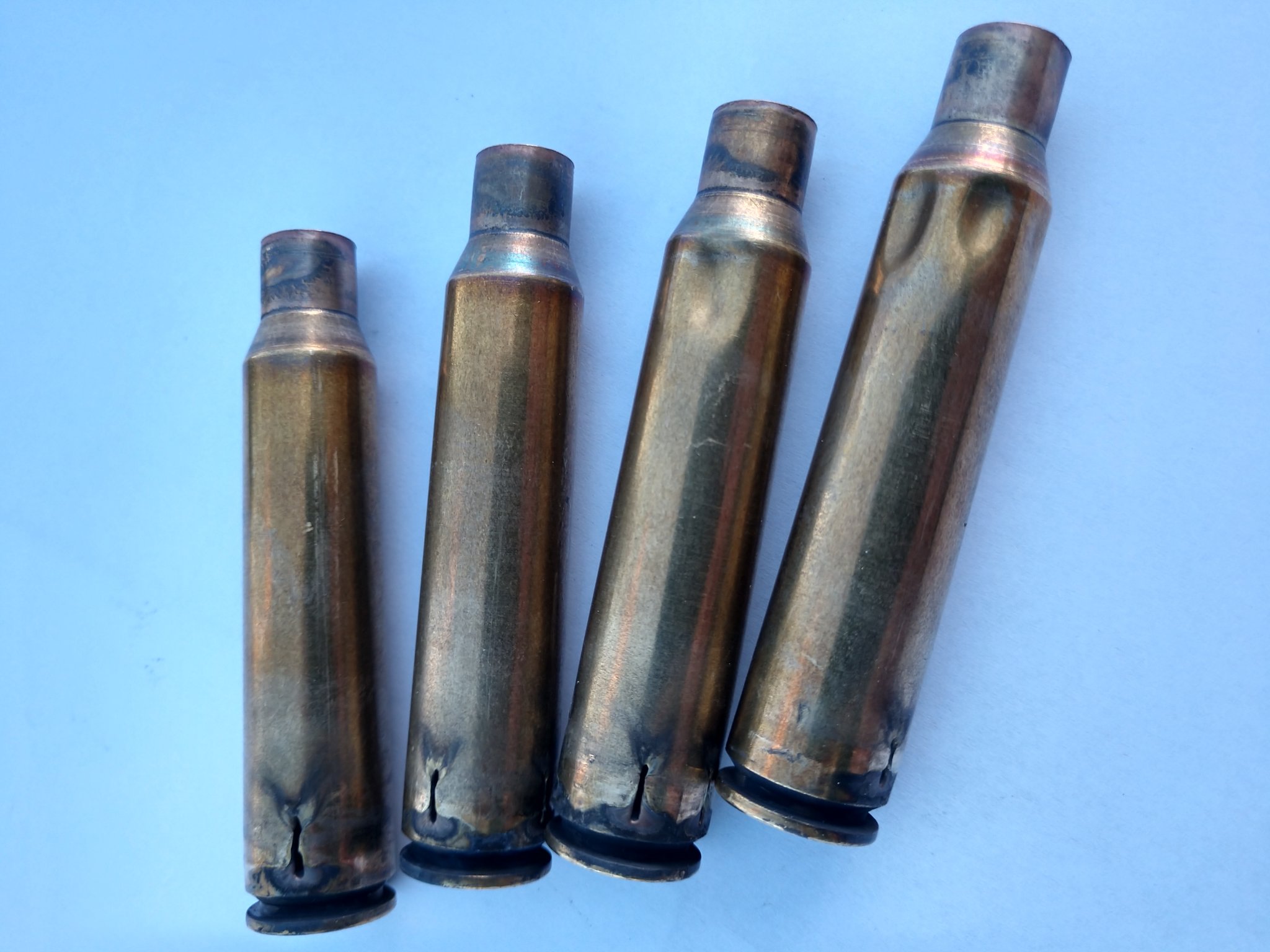

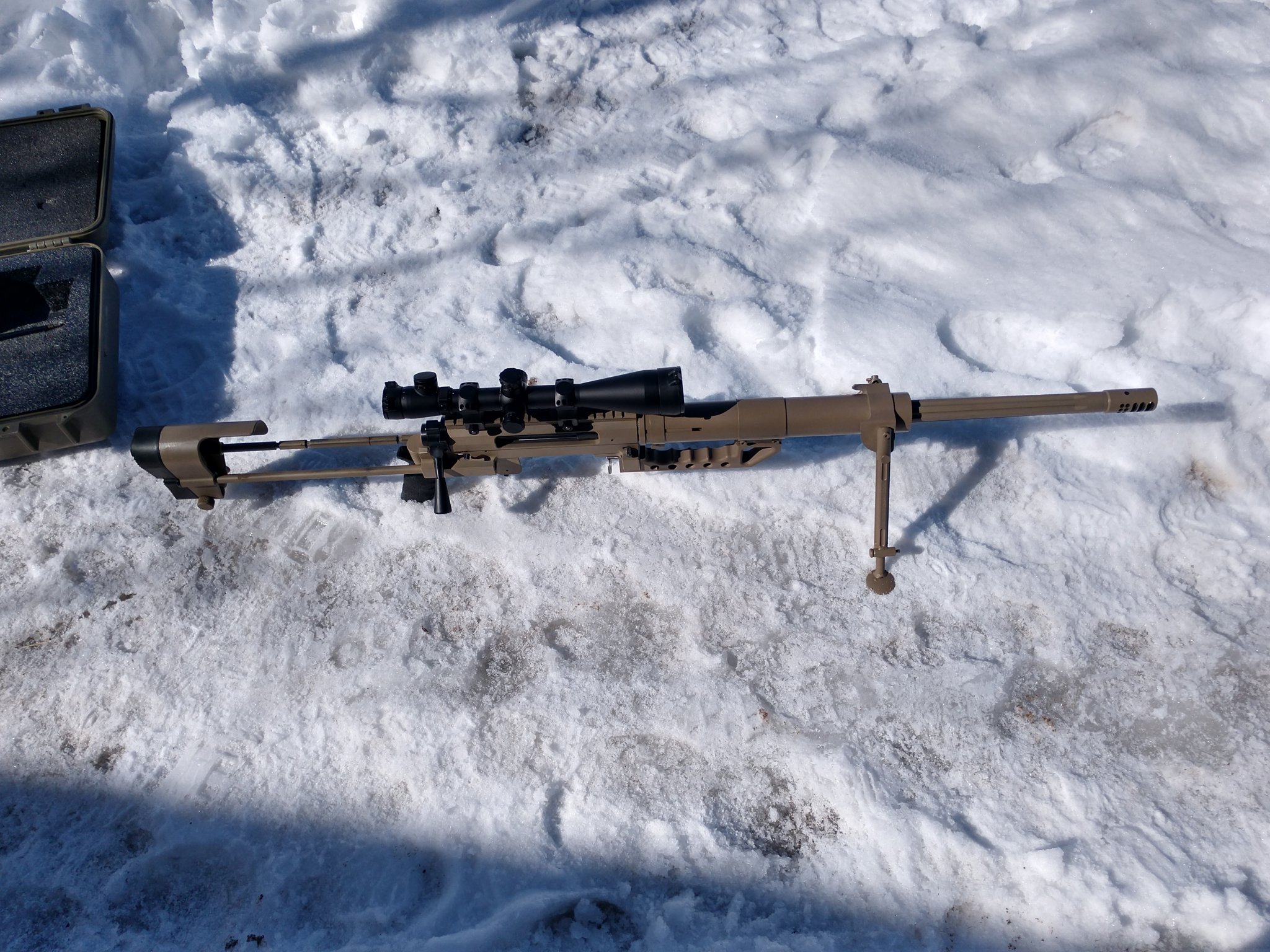

See attached pictures, factory ammo, rifle has around 100-rounds through it since new. When it was purchased new 10+ years ago, no issues back then with this ammo. Rifle and ammo have set for a long time. It was brought out today, and this was the result. Ammo was stored in a cool basement. Primers do not show any major signs of any high pressure.
Also of interest, a few rounds of the factory new ammo had split necks
Guessing maybe age hardening of the brass?
Factory ammo, Jamison brass.

The other thing that's puzzling, the dimples just behind the shoulder, which weren't there before firing.
Cases stuck in the chamber, and we had to use a cleaning rod to pop them out. Not much resistance, just the extractor wouldn't pull them out.
I measured the base area of the fired rounds, and they grew between 6 and 7.5 thousands from the new case.

Improper metallurgy. Remember, 10 years ago we were in the midst of a "panic" similar to the current one resulting in leaky Win primers and "surplus" LC brass that failed? Best to disassemble and scrap the brass as another suggested. You already had 4 cases fail, how many more chances do you want to take?
Gas pressure leaking forward, or from the neck caused the case to partially collapse at the shoulder.
If you were measuring growth in the web of the brass case, it should never grow in diameter by .006 or .0075. When you do case head measurements to estimate pressure, they should be in ten-thousanths (.0001's) of an inch. .0007 would even be high (like over magnum 65k psi pressure).
I've seen plenty of those dimples just behind the case shoulder and the case didn't crack etc...near the base.
I'd check the headspace of the ammo to the gun. If I recall correctly too much headspace will have the same effect in causing those dimples as well. Funny it didn't happen 10 years ago but is happening now.
Cases getting brittle after 10 years and properly stored? Anything is possible but I'll say in my opinion I lean towards no.

Ok, to all concerned. After much research, it looks like Jamison brass was crap. Problems like mine are the norm throughout, including those who were shooting African Safari cartridges to those shooting the big Buffalo cartridges in their Sharps and Rolling Blocks, all with new Jamison brass.
Someone I know, PhD type, who works in a metallurgy lab offered to do a failure analysis, so yesterday I mailed him a couple failed cartridges to play with. I know what the answer will be.
I cleaned the bore and chamber, and metal etching from ruptured cases was minimal, so no worries there.
I suggested to the owner that we pull the bullets, reuse the powder, and reload on new brass that has a proven track record, and he agreed with me.
So we're going to wait on him to purchase brass, dies, a big press, etc., as he doesn't currently reload.
