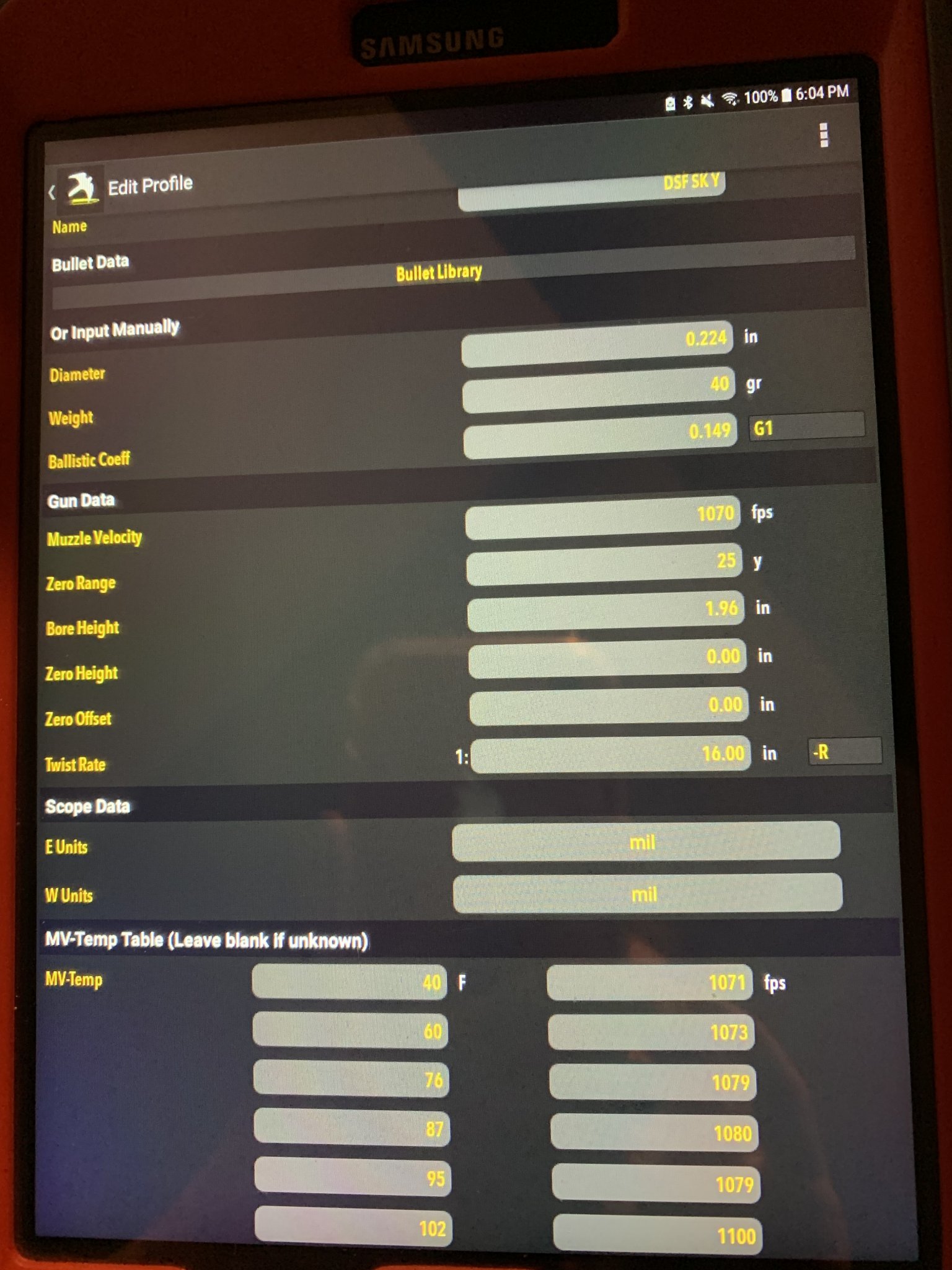

Here is the profile I'm using for SK Yellow. The DOPE has always been .8-.9mil @ 75yd and 2+/-mil at 100. When I updated the firmware on my Kestrel, I decided to update my MV Temp table and re-true the Kestrel. There were no user input changes besides the tweaking of in the Cal DSF menu.
As usual...everything was fine before I messed with it!
Is there a custom curve for SK Yellow? Or are you using the Center-X custom curve?

That looks good to me, I think you’re down to something is majorly input wrong on the DSF data. Check the numbers there, if that’s good I would rebuild the gun from scratch. Checking the dope after each thing you modify.
I think I’m using the center-x curve. I didn’t even chrono my ammo. Input the box velocity and trued with dsf.
