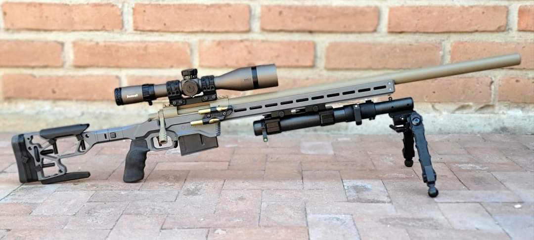

Hey yall. I have a nice 300 WinMag build, but when it was built the barrel was not profiled. So basically it has a 30" bull barrel which makes the gun super heavy. I would like to have it cut to 26" and threaded, but most importantly, I would like the barrel profiled. Is this something that the barrel would need to come out of the action for, or can profiling be done on the barreled action? Probably doesn't matter, but it is a Surgeon 1086. Also, any recommendations on where to have a barreled profiled? I am in AZ so something local to Tucson or Phoenix would be great. Thank you.

Found in my old texts that it was built by Steven Clake. There are some references to him on this forum being a reputable builder.
This is the gun guys. Maybe I should just part it out?
Again talk to Southern Precisions, a BugNut barrel could fit your action and are easy to install or so I have been told.
