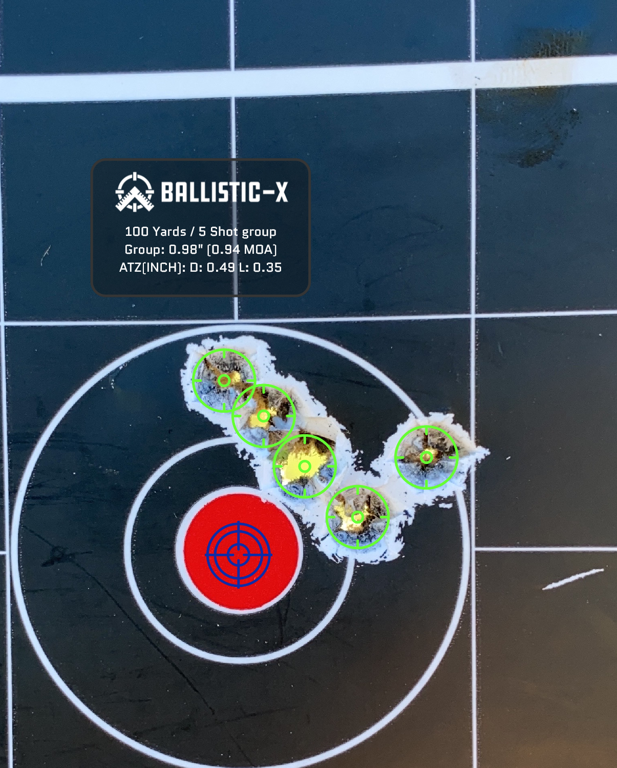

Black and red target 178 hornady precision hunter
Black yellow 165gr fed fusion
And 3 shot group was fed gold metal match 168
