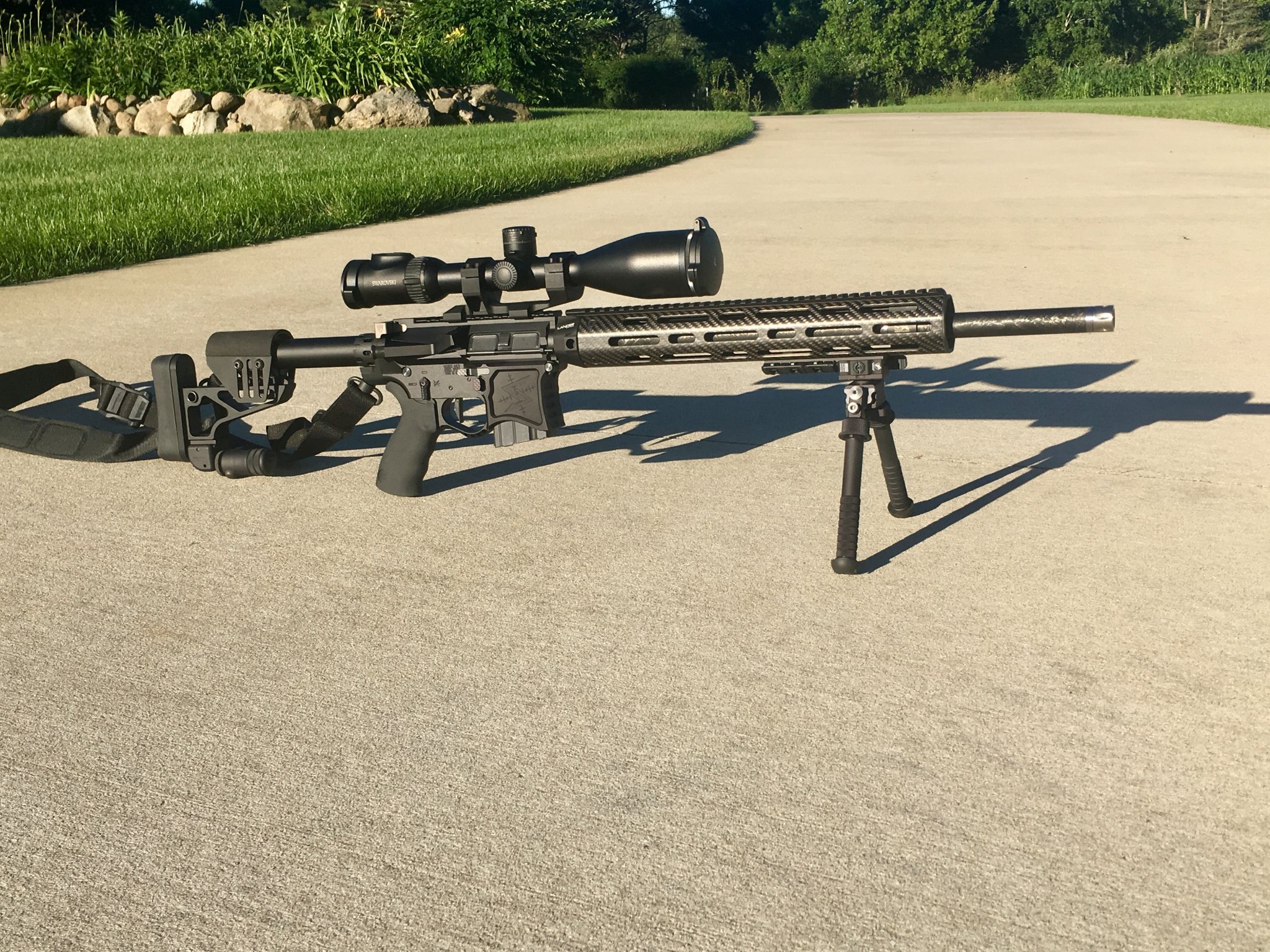

Running four Proof CFW barrels with a 5th in progress on my personal guns. I'm a believer. Light weight. Amazing accuracy. Zero problems.
Love the 2nd one down. If you get a chance let me know what the overall length is exactly the way it sits in the picture.
