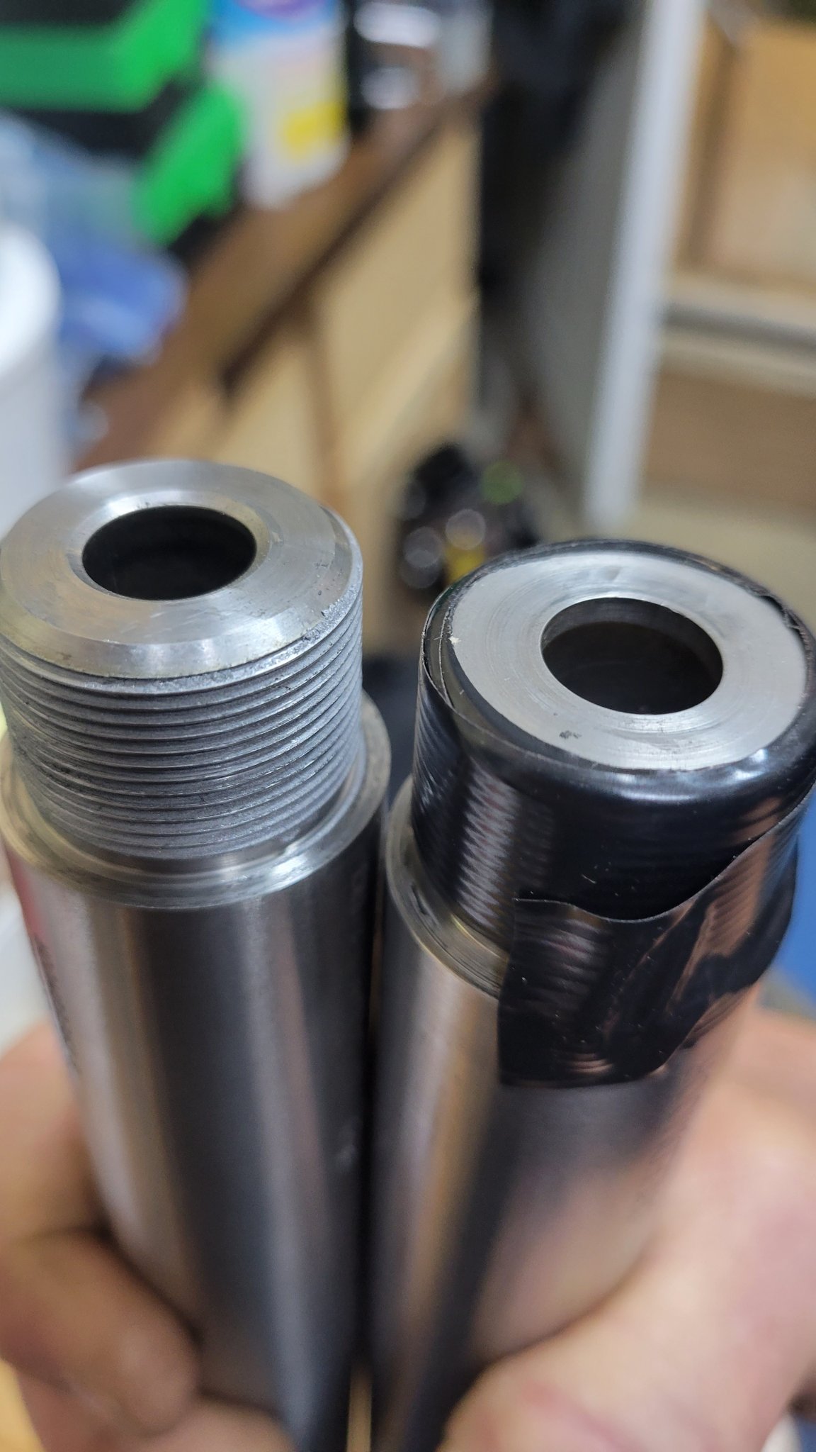

I've had those same issues with a Smith that Jim See discusses. I as of yet I have not had issues with my Proof barrels. Proof on Left/ Smith on right
