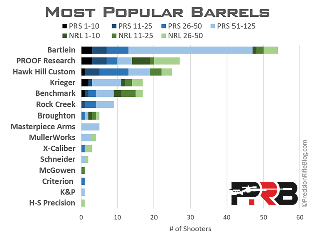

All the proofs you see in the top polls are the stainless barrels, you will be pleased with them just like you would be with any of those barrels in th elist

Brux barrel just set the world record for a 5 shot group at 1000. Think it was just a touch over 1"
