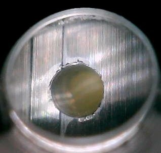

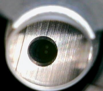

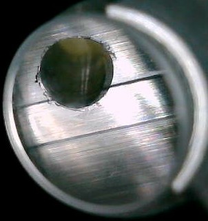

The Proof gas barrels I’ve had through my hands all had visible with the naked eye burrs at the gas port. Granted it’s a very small sample size, but that’s across calibers and frames, so not very encouraging. Glad to hear they seem to shoot though.
Have also seen the burrs in barrel’s gas port on interior of barrel, most recently on a 300BO barrel. Hard steel, bad drill bits or process? Would surely hope they’d catch that in QC, or have a better means of correcting issue. I’ve cleaned them up, and they do shoot very well, but irritating to know they’re shipped in that state and require attention prior to assembly.
Proof chambered barrels leave something to be desired. Their blanks have enough issues without monkeys also doing the cambering.

FWIW, when I finally got my barrel from Craddock, (back when the wait was only 4 months) I noticed the gas port straddled the transition between a land and a groove. I called and Paul told me that in his experience, there was no accuracy difference between a gas port straddling a land and groove and a gas port centered in a groove. He went on to tell me that of all the cases that he had seen where a barrel showed gas port erosion that was faster than normal, they all had ports that were centered in a groove. So he no centers ports in a groove unless a customer specifically requests it.
Reactions: TheOE800
I called Proof yesterday and that's basically what they said no measurable difference in accuracy or barrel life in regards to the gasport location.
I also email them the pictures of the Gas Port out of that SS Barrel and they said shoot it, if it doesn't perform at Sub 3/4 or less with match ammo they will replace it.

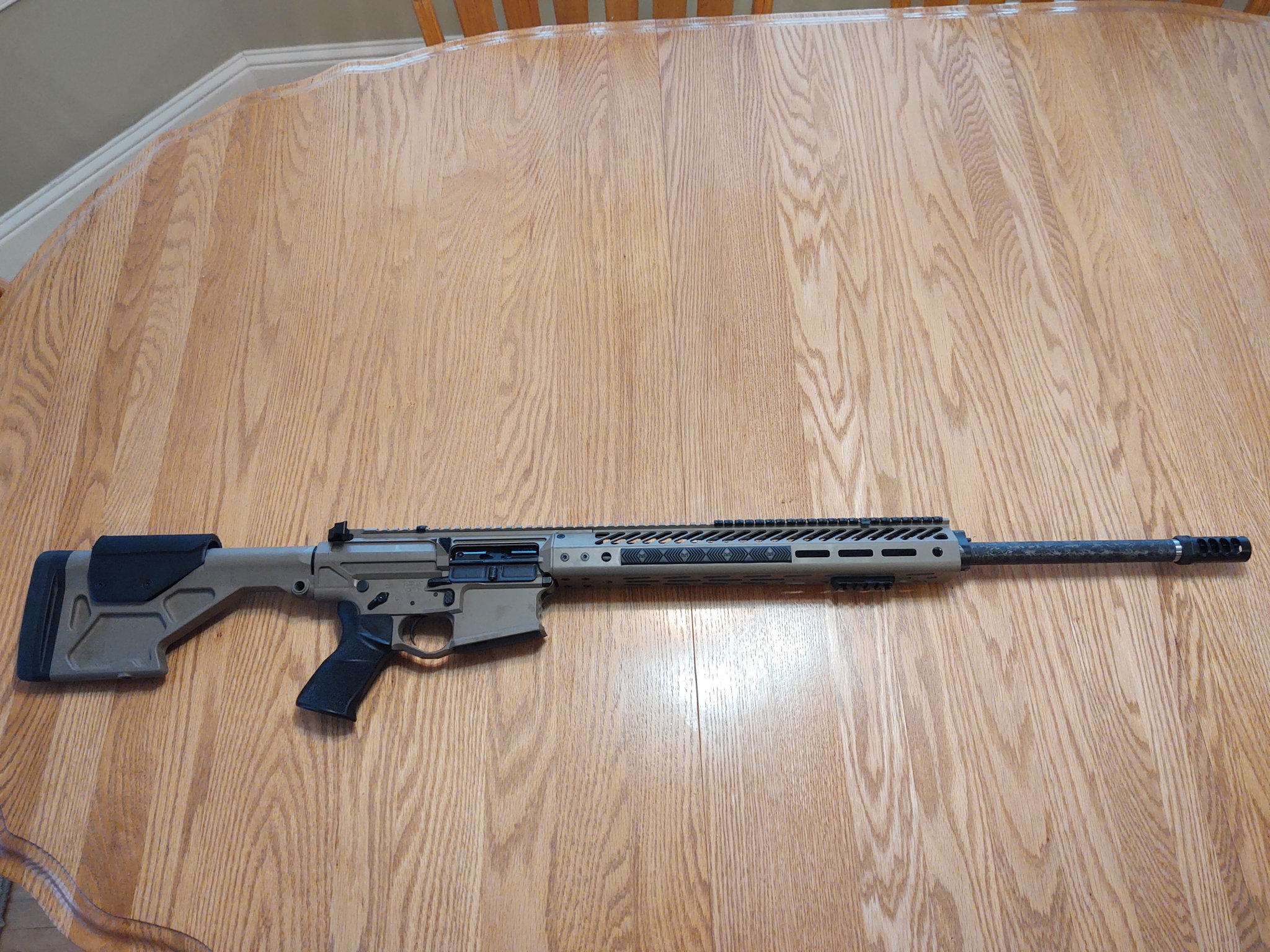

So at this point I have no regrets with choosing Proof Research for my current build, it's not just about the quality of the product, but how they stand behind their products that makes the difference.

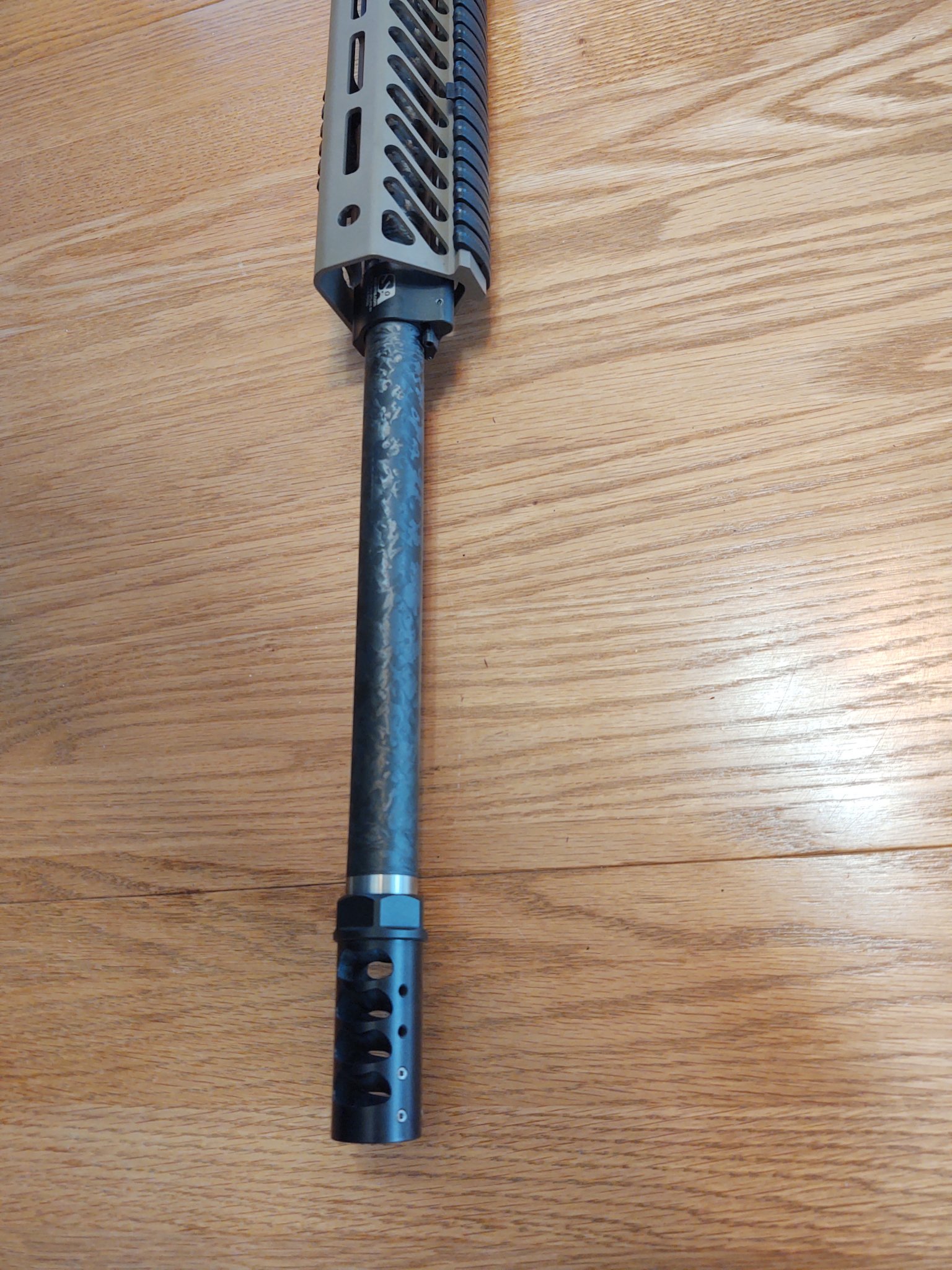

I have a 24" Proof CF 6.5 CM. I'm very happy with it. It was super accurate right out of the gate. Very easy to tune with a SLR AGB and has been nothing but reliable. I think the difference in accuracy between the two mentioned barrels is going to hide in the margin of error created by shooters ability, bullet preference, reloading skill, and builders tuning ability.

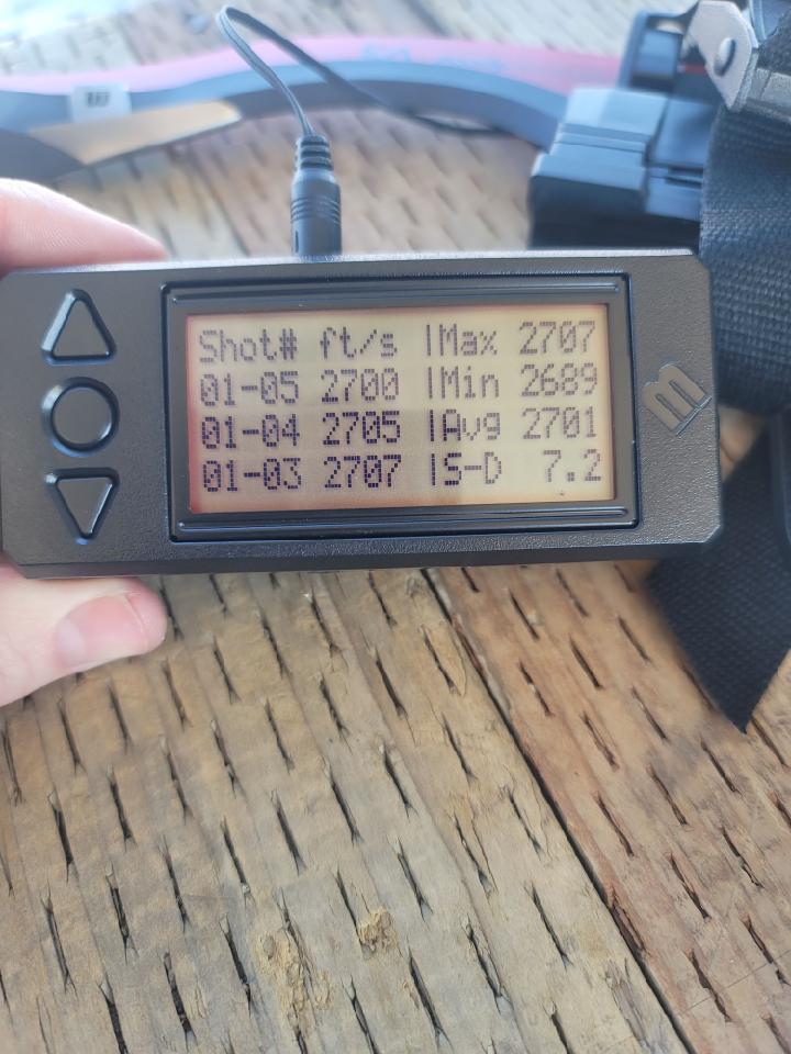

What MV are you getting from your 24"?
Damn that's nice.

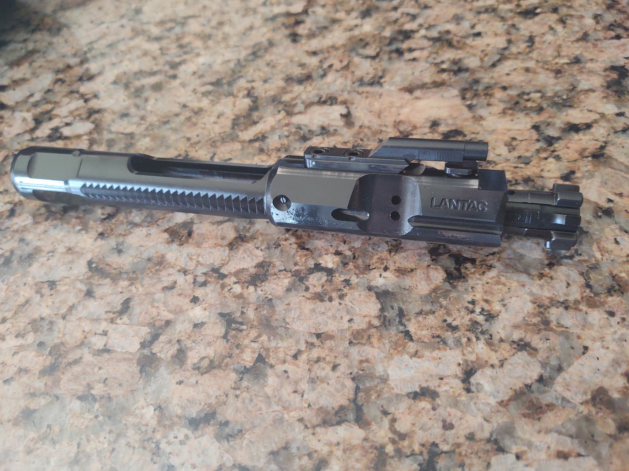

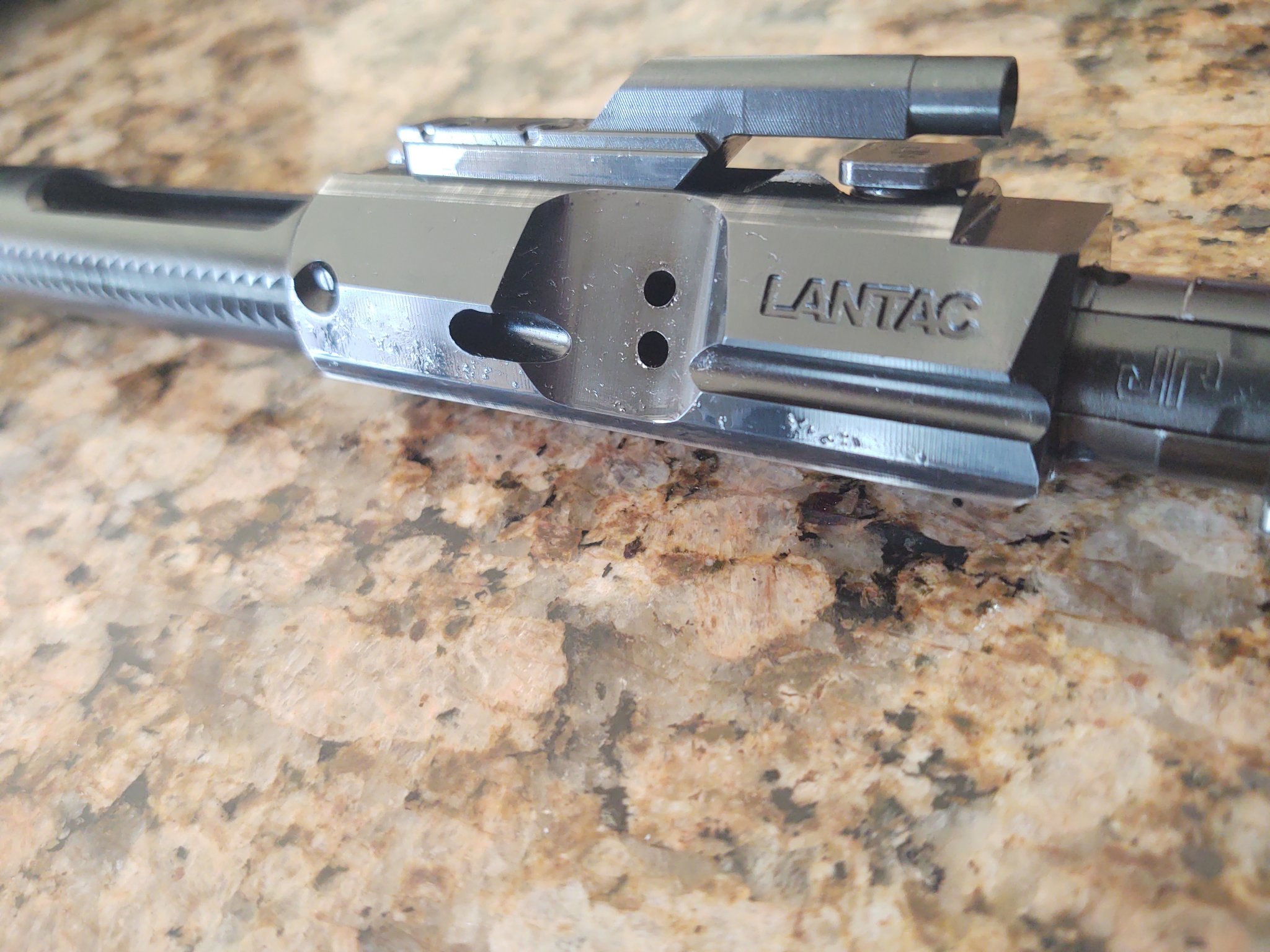

I did make some minor alterations I decided to go with the Lantac full mass 1lb 2oz Carrier that has the oversized boss at the tail end to mitigate carrier tilt, also utilizes directional gas vent ports so that the gas assist in driving the carrier in a straight line to the rear during recoil and also further pushing the gases away from the shooter's face.
The bolt is a JP HP and which is what Proof recommended to match with their barrels.
All in all I think this is going to be an exceptional shooter.

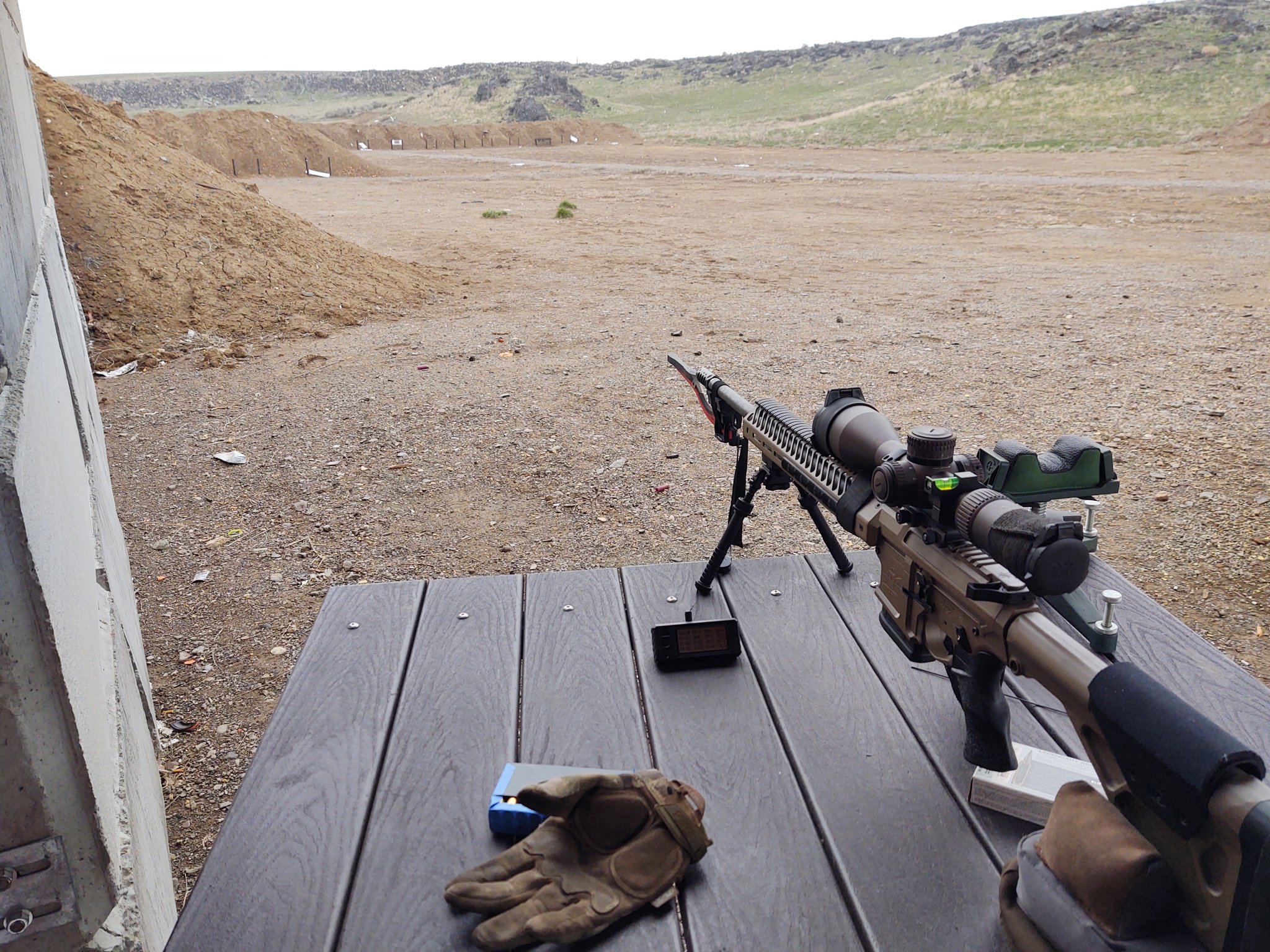

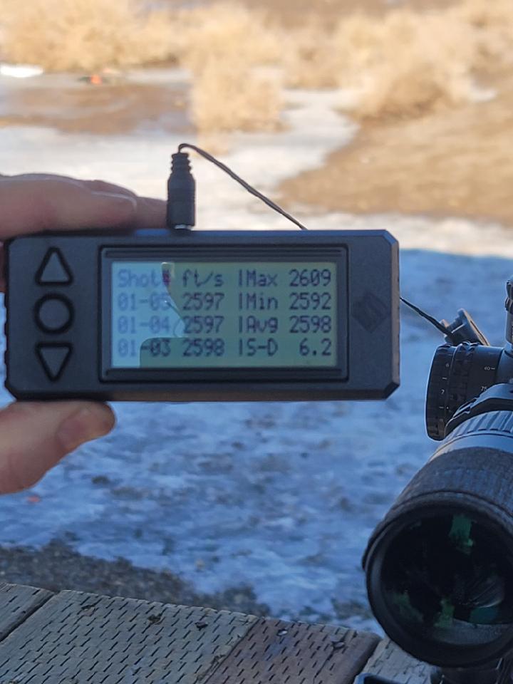

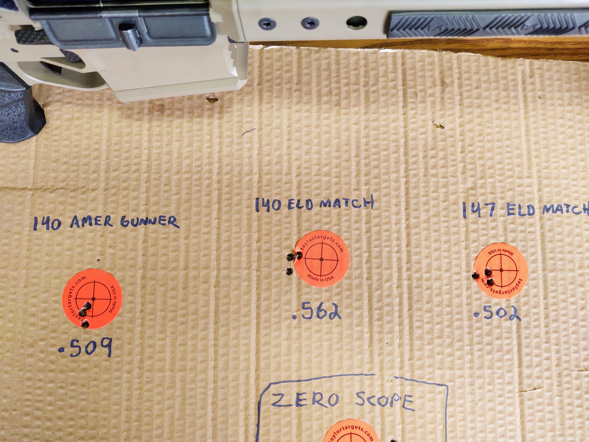

I'm at the range right now just shooting some cheap Hornady whitetail 120 GR hunting ammo for barrel break in, gas block and muzzle brake adjustment and it's already grouping about 3/4 MOA.... Only issues I'm having now is it so damn cold and windy I can't feel my fingers...lol
My first rounds downrange were 120SMKs loaded at(randomly) 2700fps. Shot knotted up little groups. Let us know what it does after the gas is tuned and you have a good load. Eager to see barrel to barrel consistency.
I just shot three 3rds groups of 14O American Gunner, 140 ELD Match, and 147 ELD Match, they all look to be about .5 MOA when I get back to the house I'll update this post with pics.
140 American Gunner, 140 ELD match and 147 ELD Match all shot .5 MOA
140 American Gunner .509
140 ELD Match .562
147 ELD Match .502
Total of 18rds fired today in 36° high wind, couldn't even feel my fingers. The Proof Research carbon fiber Barrel is showing great promise and I have no doubt with Handloads it'll be a consistent Sub .5 MOA shooter.
The rifle performed perfectly and smooth as butter, no failures at all and the recoil is practically non-existent. I'll start working on handloads soon as possible.

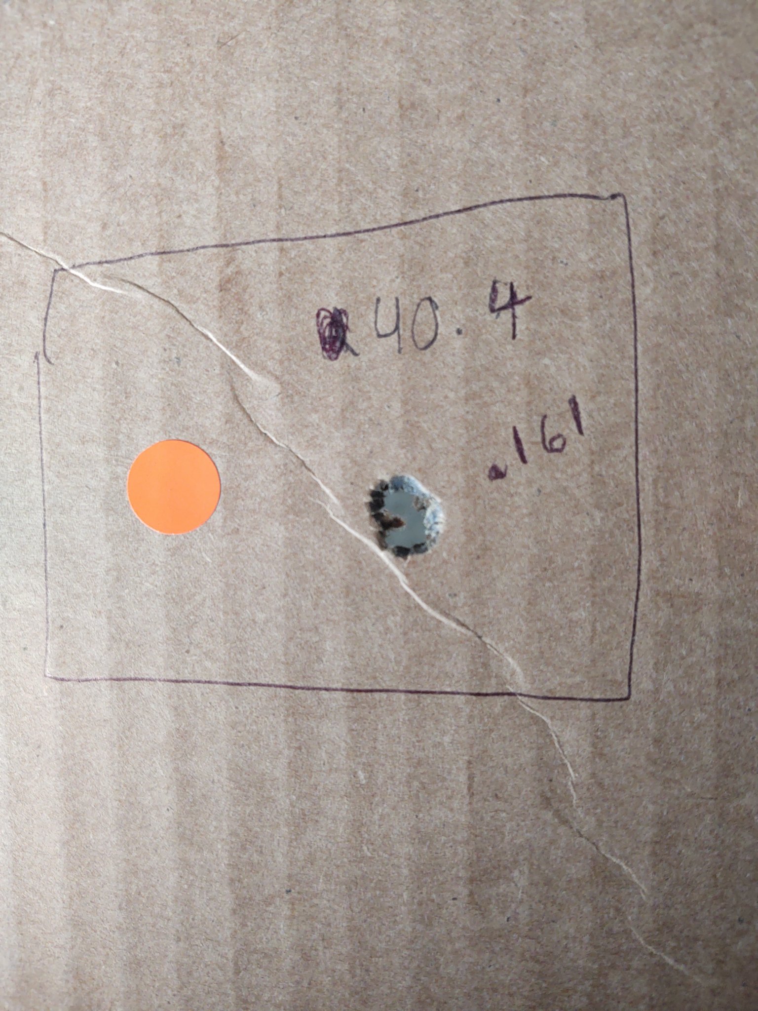

Just thought I'd update this thread...

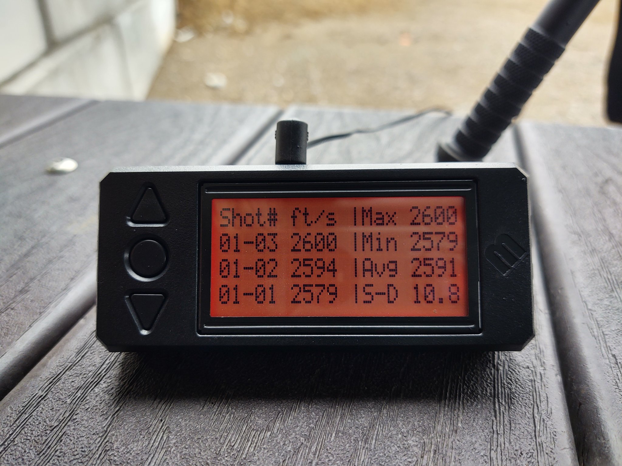

So I went back out to the range in the snow and fucking rain today because I swapped scopes and wanted to finish fine-tuning the muzzle brake.
This Proof Barrel is a fucking hammer !!, after I re-zeroed the scope I shot two groups, one with Hornady 147 ELD Ammo and the next with Hornady 140 American Gunner..
To put this into context not even my Custom Bartlein's from Craddock or CLE shot Box Ammo this accurately or as consistent, I had to handload to maintain Sub 1/2 MOA. Next weekend @FALex and I will take it to a indoor 100yrd range and I'll shoot some 5rd groups.
They were both a little on the slow side for a 24" Barrel but it was below 40° at the range so I'm hoping with warmer weather and the barrel being fully broke in it should speed up a bit.

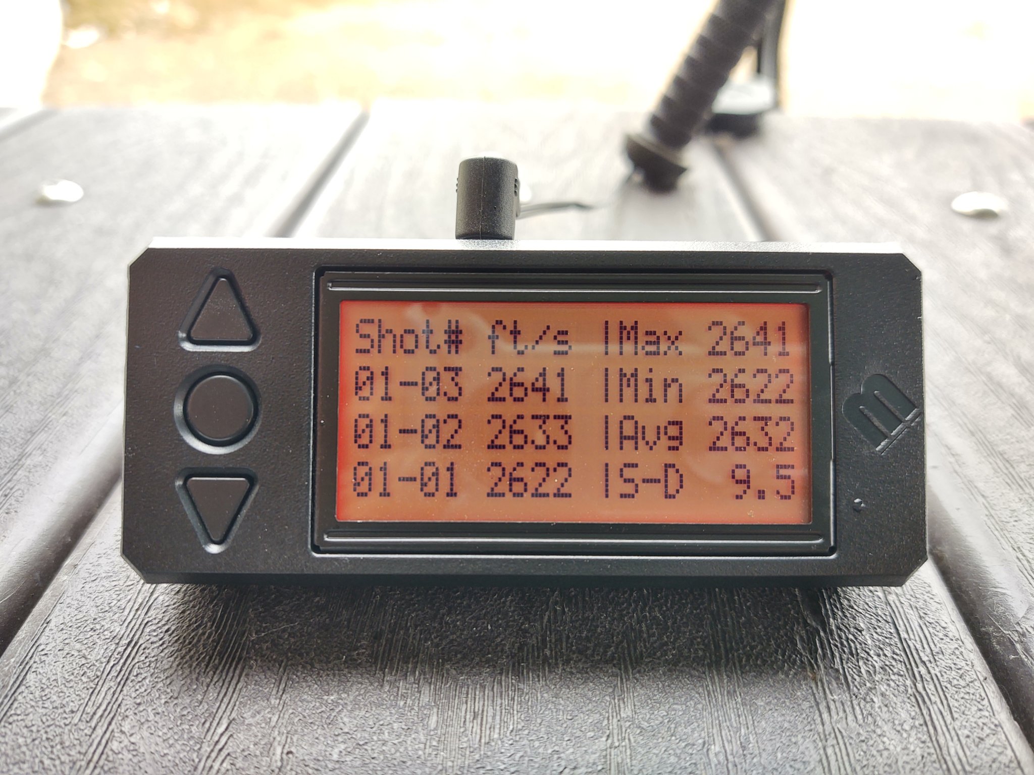

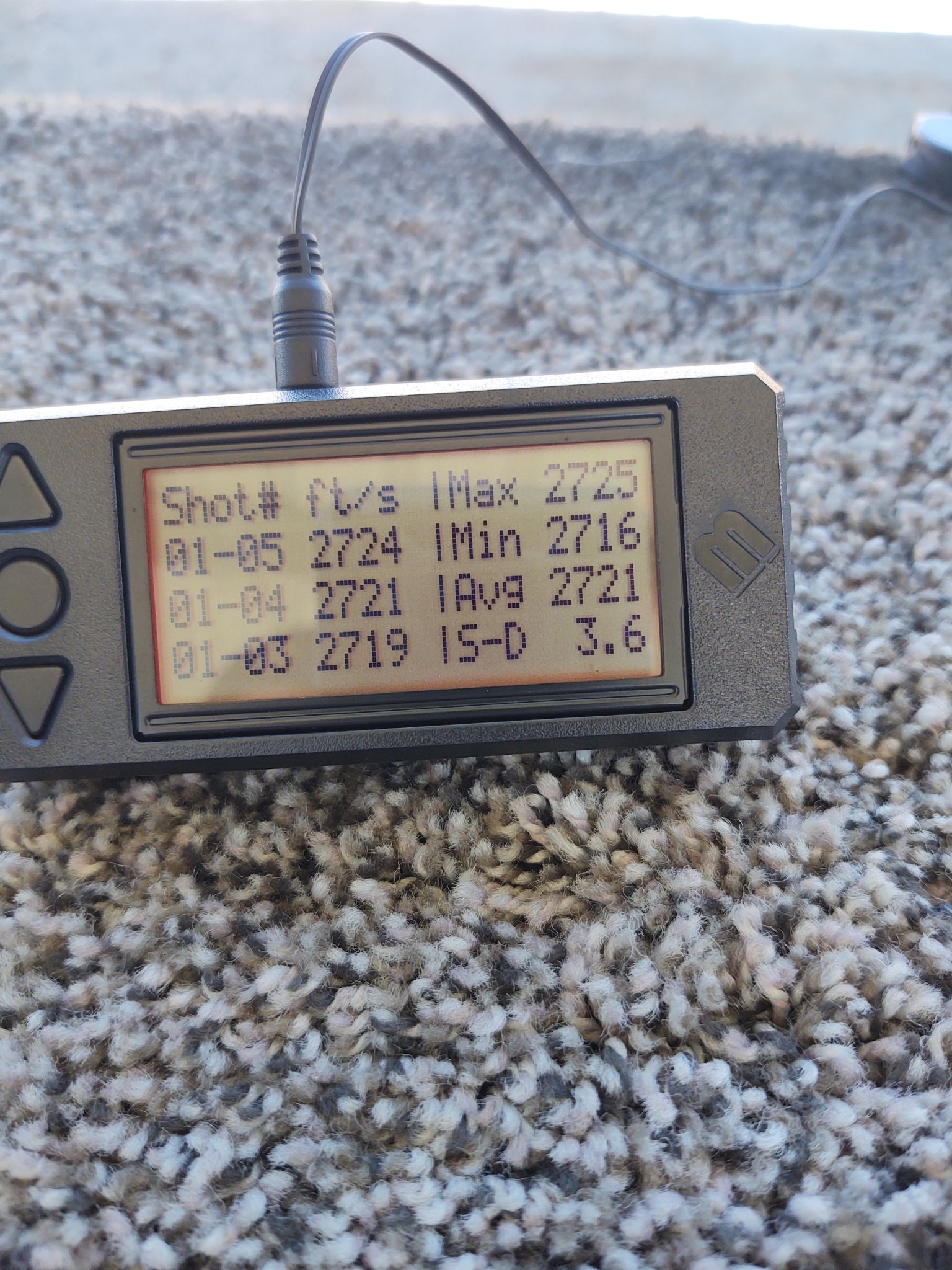

I haven't ran the 20" yet but here is the following info I have.
24" PRCF with 41.0grs of H4350 / 140 ELD's/ Starline Brass.
Here's (2) Bartlein barrels same in every way except length, one is 18" and the other is 22"
Both are shooting the exact same load of 40.4grs or H4350 /140 ELD's/ Lapua Brass.

So looking at this it seems the 22” really doesn’t give up much of anything to the 24” being in the same velocity node without excessive pressure or beating up the brass to get there?
The 24" PRCF with the load of 41.0grs of H4350 is right there at the edge of showing pressure signs.
And the 22" Bartlein with 40.4grd is a relatively light load, I did shoot 41.0grs in it but it didn't group as well as 40.4 so I didn't chronograph it but I'd be willing to bet it would be the same as the 24" PFCF if not faster, the PRCF barrel is the slowest 6.5CM barrel I've ever had.
So to answer your question, no there is no real advantage I can see at this point to run the 24". However I just ordered a 24" Bartlein 6.5CM to test that very question, apples to apples using Bartlein blanks from Paul at Compass lake instead of comparing PRCF to Bartlein's.
