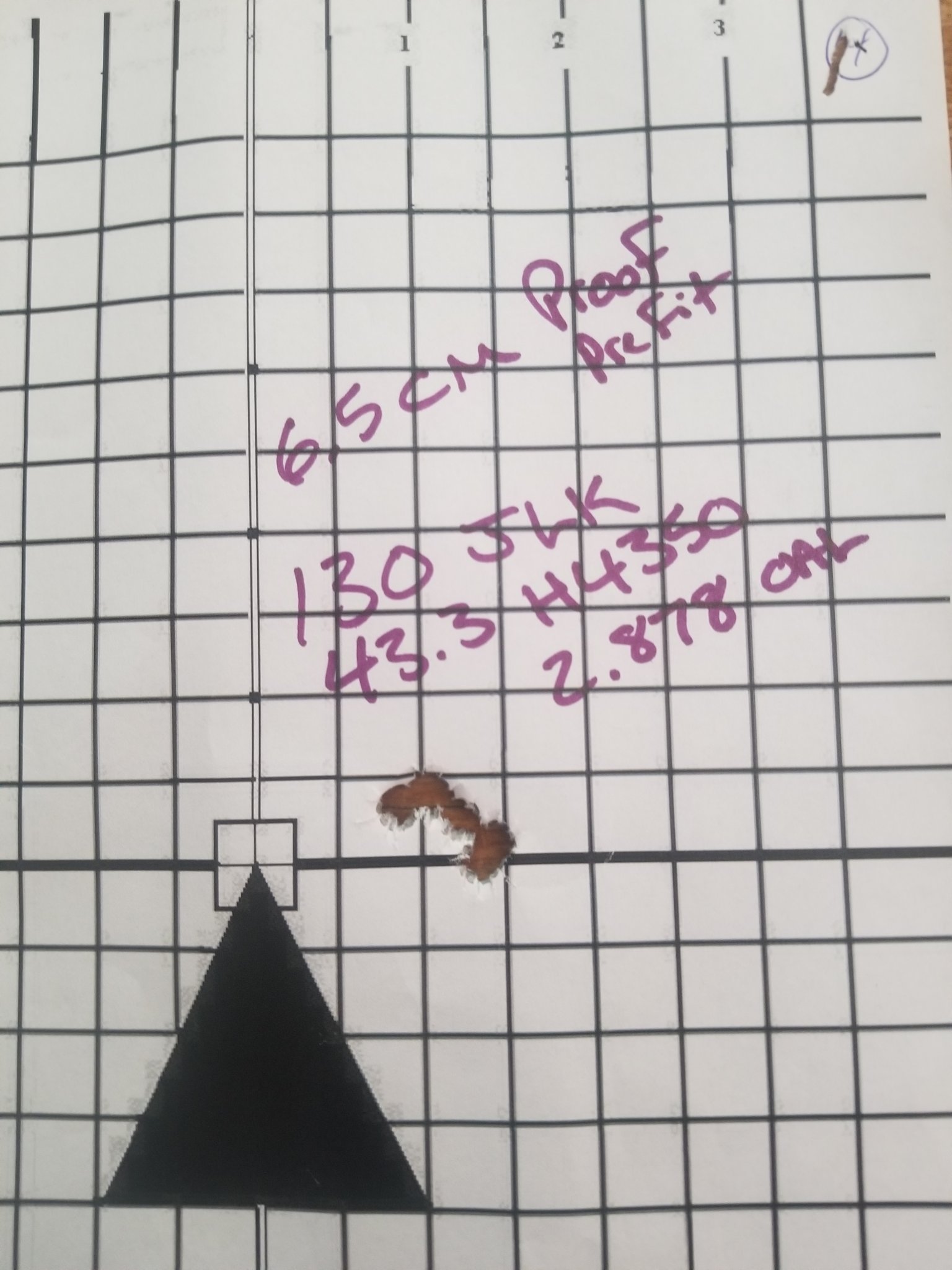

Wyfox, what was the range on that group? Assuming 100 yards, that looks to be about 0.75 MOA? In the world of custom barrels and chambers, that's pretty average. Am I missing something? Please don't take this as an affront, I am just curious.
Looking at the grid and assuming they are 1/2 inch squares. It looks like .5 MOA to me.
Brand new barrel first group shot after zero. Haven't even done an OCW test yet. That was a load recipe from my AI. By the way it's .61 center to center and I had a stiff crosswind. All my Proofs shoot less than .5" after load developement. I dont get to serious on load developement until I have over 100rds through the barrel.
The barrel hasn't even sped up, I'd say impressive/promising right off the bat.
