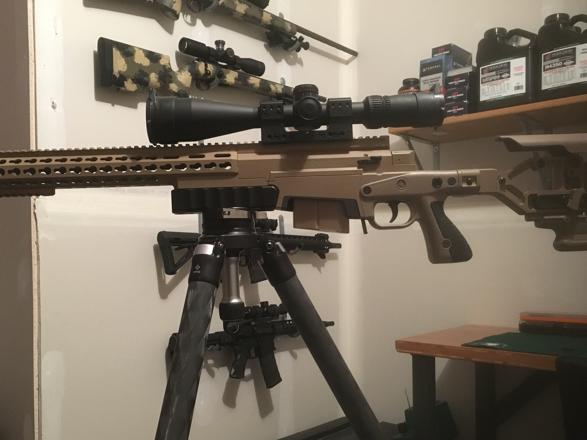

I have a Razor HD AMG on order, and I am trying to determine the correct height Spuhr mount to order. For the 30mm tube, Picatinny rail, there are two height choices: 30mm and 38mm. The AMG has a 50mm objective, so with Vortex lens caps I think it would be pretty close for a 30mm height. Does anyone have this combo that can confirm which one will work best?
I believe 30mm will work for that setup depending on barrel contour and MOA of pic. rail. The link above me I use all the time for reference. I would plug in your numbers there for certainty.
This is a 3006 spuhr
https://www.milehighshooting.com/spuhr-sp-3006-30mm-picatinny-mount-0mil-0moa-1-35/
Hey in that picture is that mythical beast called H-4350 - wow been a while since I have seen that in the wilds.
Ha sitting on like 37 lbs of it right now... gotta snag it up before it sees its shadow! Sent you a link....
