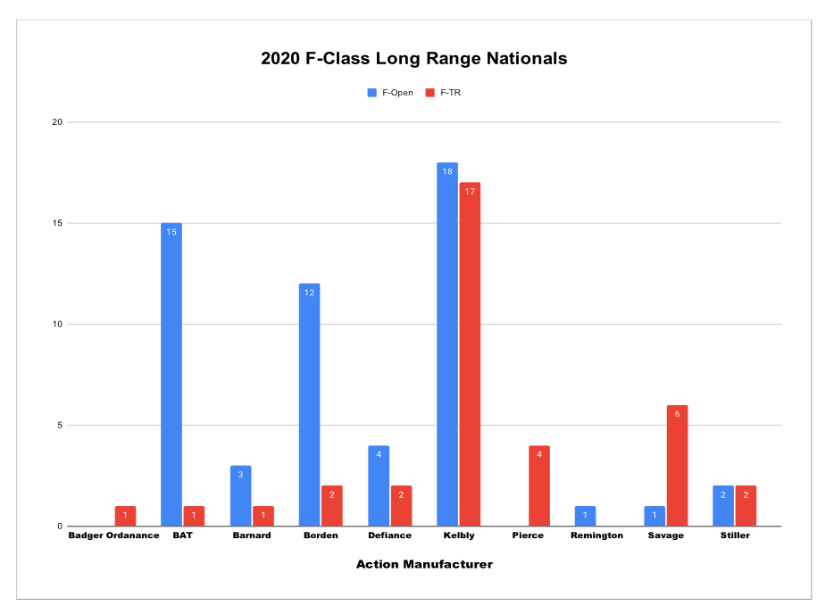

I'd be interested to have @Rio Precision Gunwerks expand (if you have time) on the Alex Borden as to what the differences were (again, I don't doubt it--just trying to learn more).
And the OG data that prompted this--I saw Defiance and was thinking I should see more "Action" style actions like Impact, Bighorn, ARC like you see in PRS "What the pro's use":
P.S. Yes that is Savage as #2 in FT-R. That oughta cause some wailing and gnashing of teethm along with some poors going "told ya".
