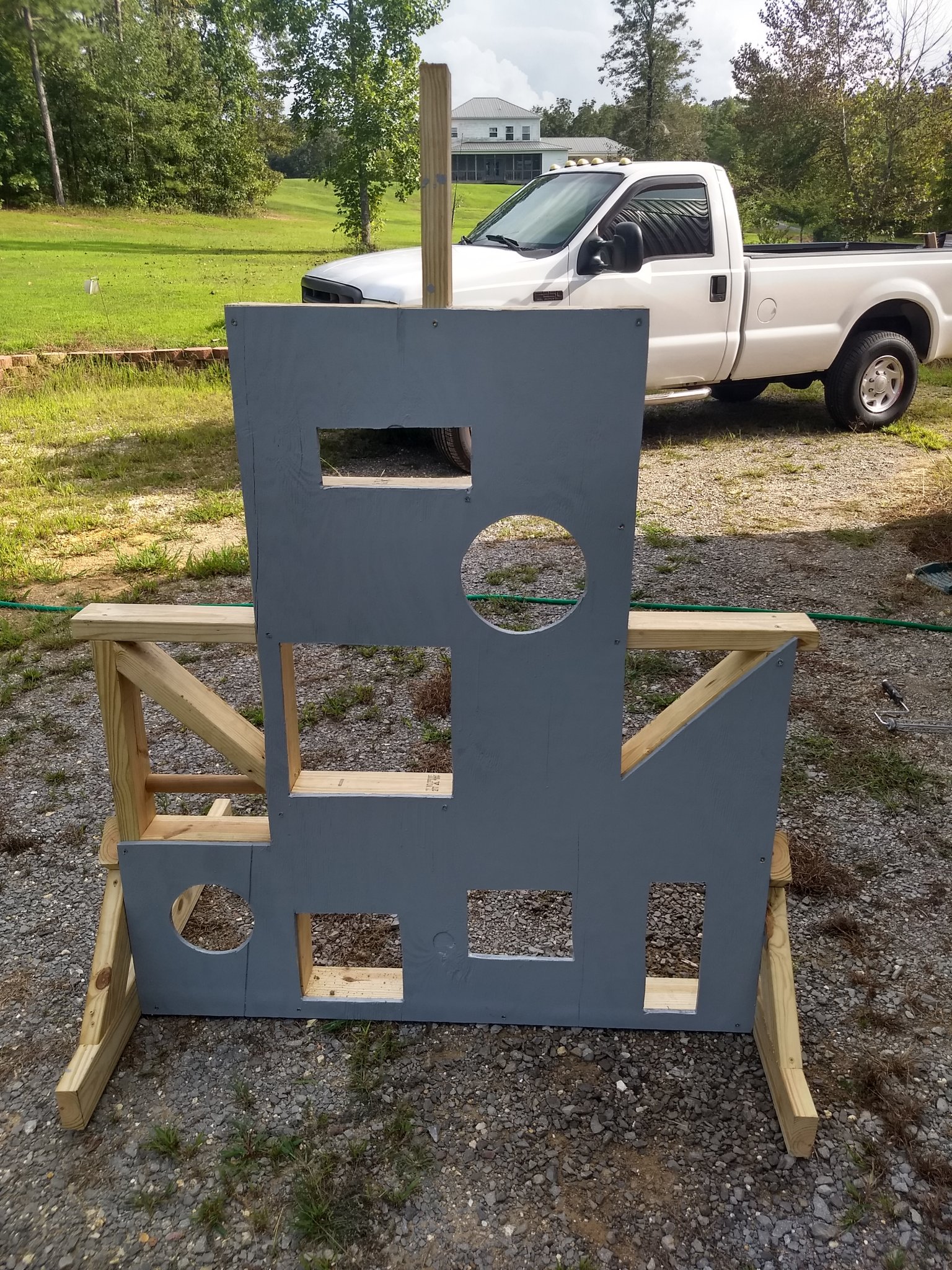

I believe about 72 inches. I’ve built another that is smaller in width. Only 2 sections that are PRS barricade in height, and 30 inches of cattle gate. The gate comes from tractor supply and I believe are less than $50. I’ve got a few buddies that split the gate in half and built 2 units from 1 gate. Theirs are only 48” wide.

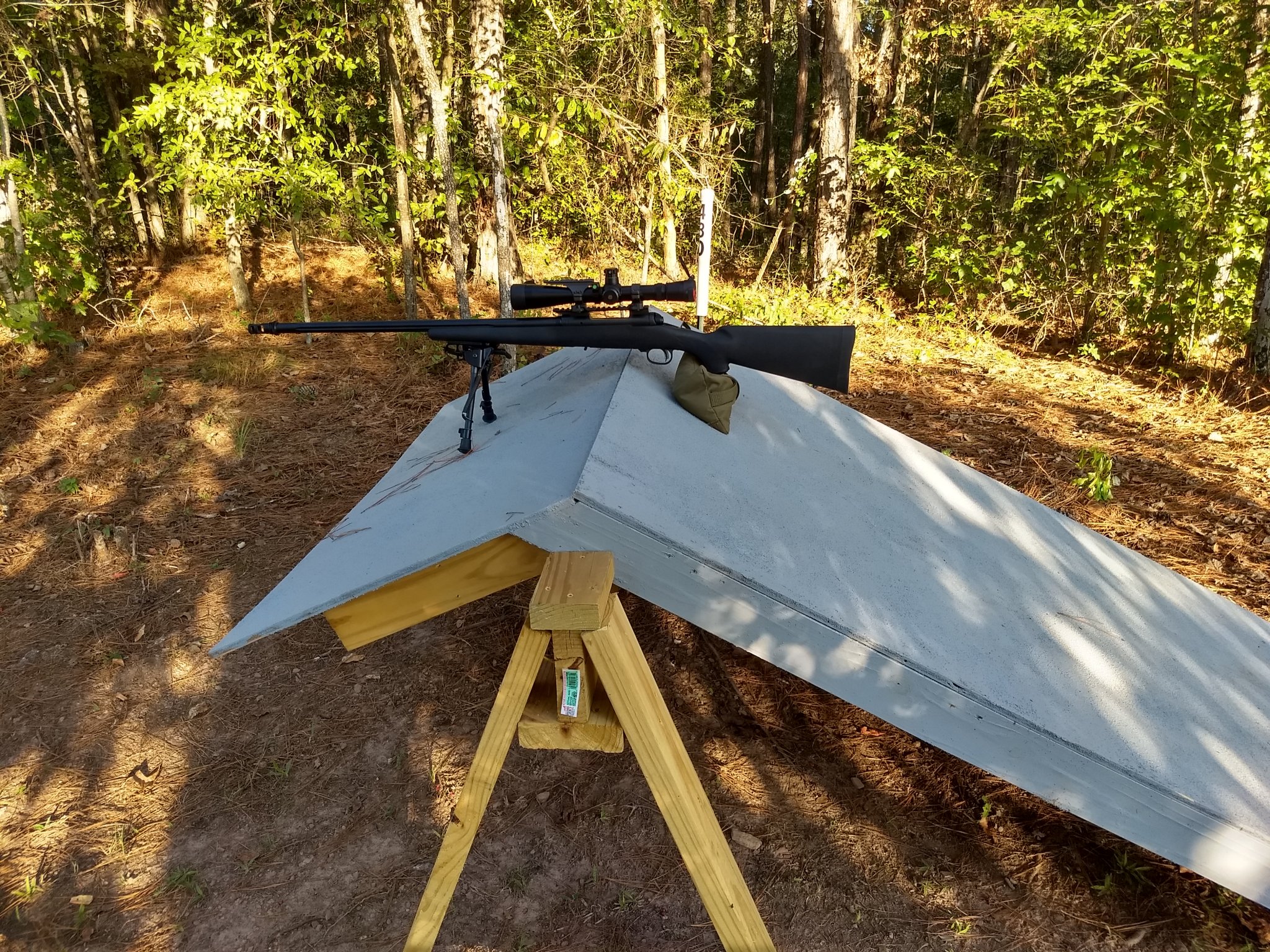

Consider adding a roof-top barricade, me and my brother-in-law built a 7/12 pitch complete with shingles on it.. In hindsight tho, a shallower roof pitch (4/12 or 5/12) might give you more practice on how not to jam a mag into the shingles causing feeding issues? nice barricade Rugster
I’ll try to get a photo of my roof top, it’s adjustable in pitch from VERY steep all the way to barely pitched. Also consider a tank trap, those seem to be at every 2 day match.

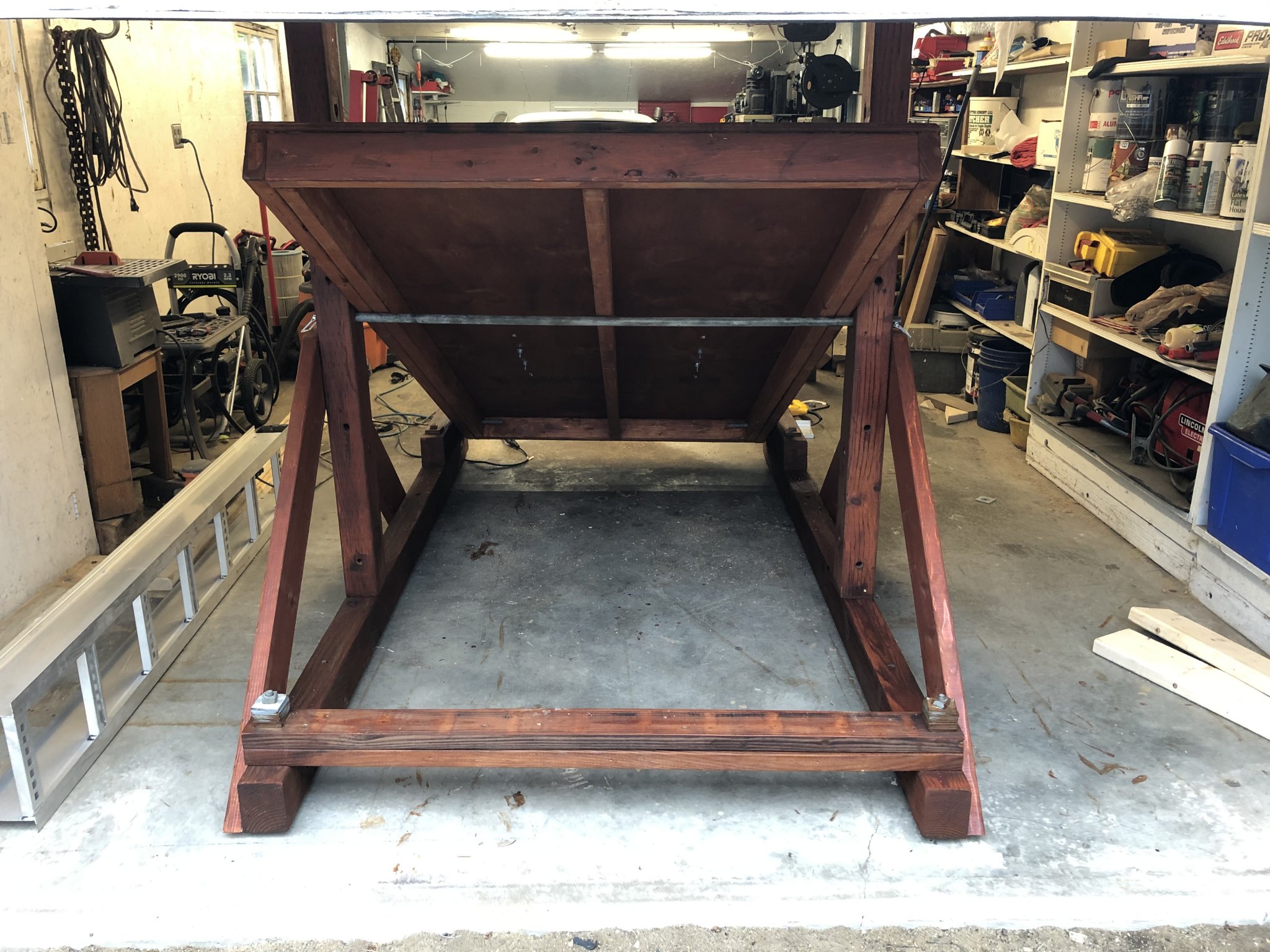

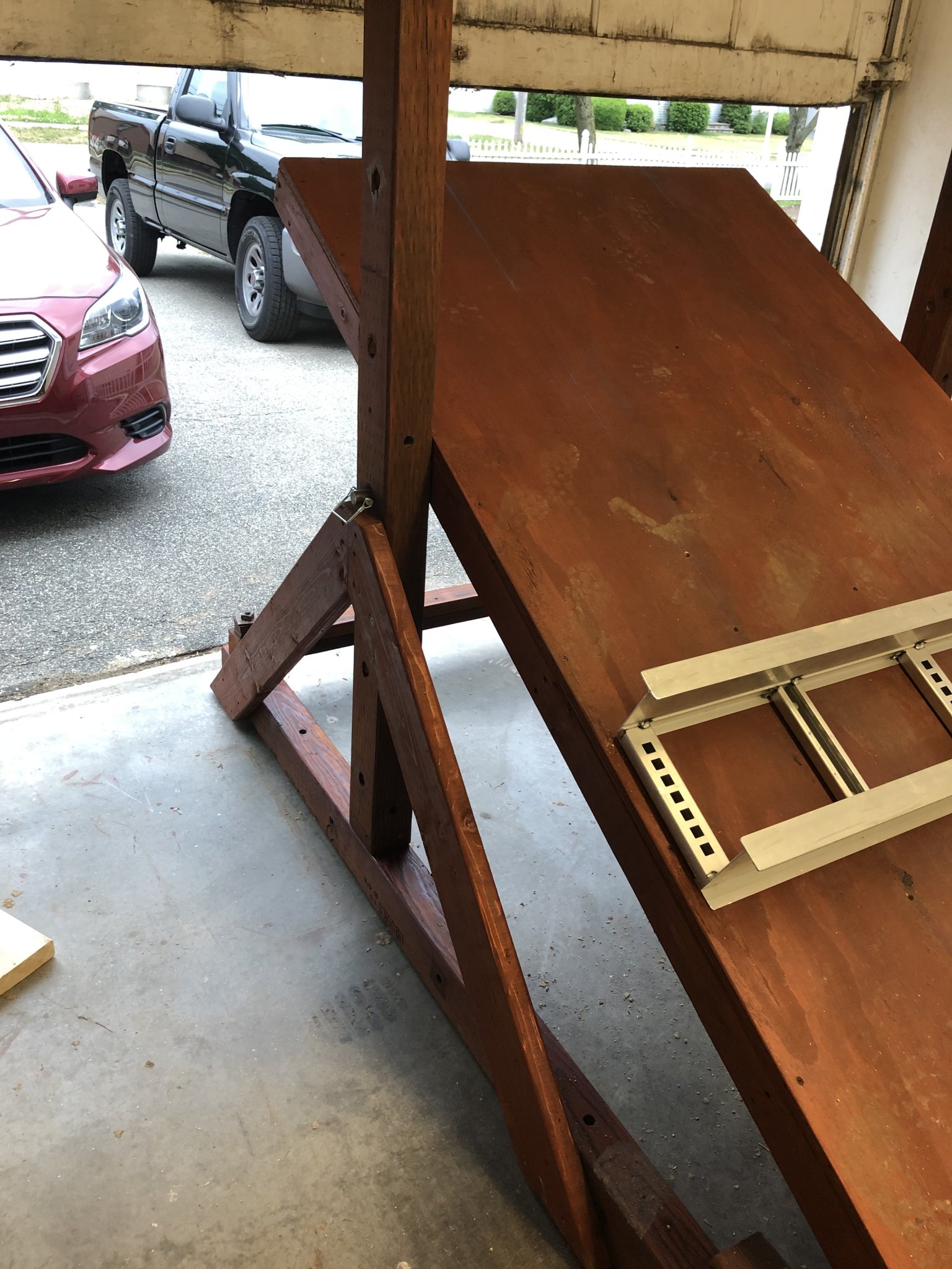

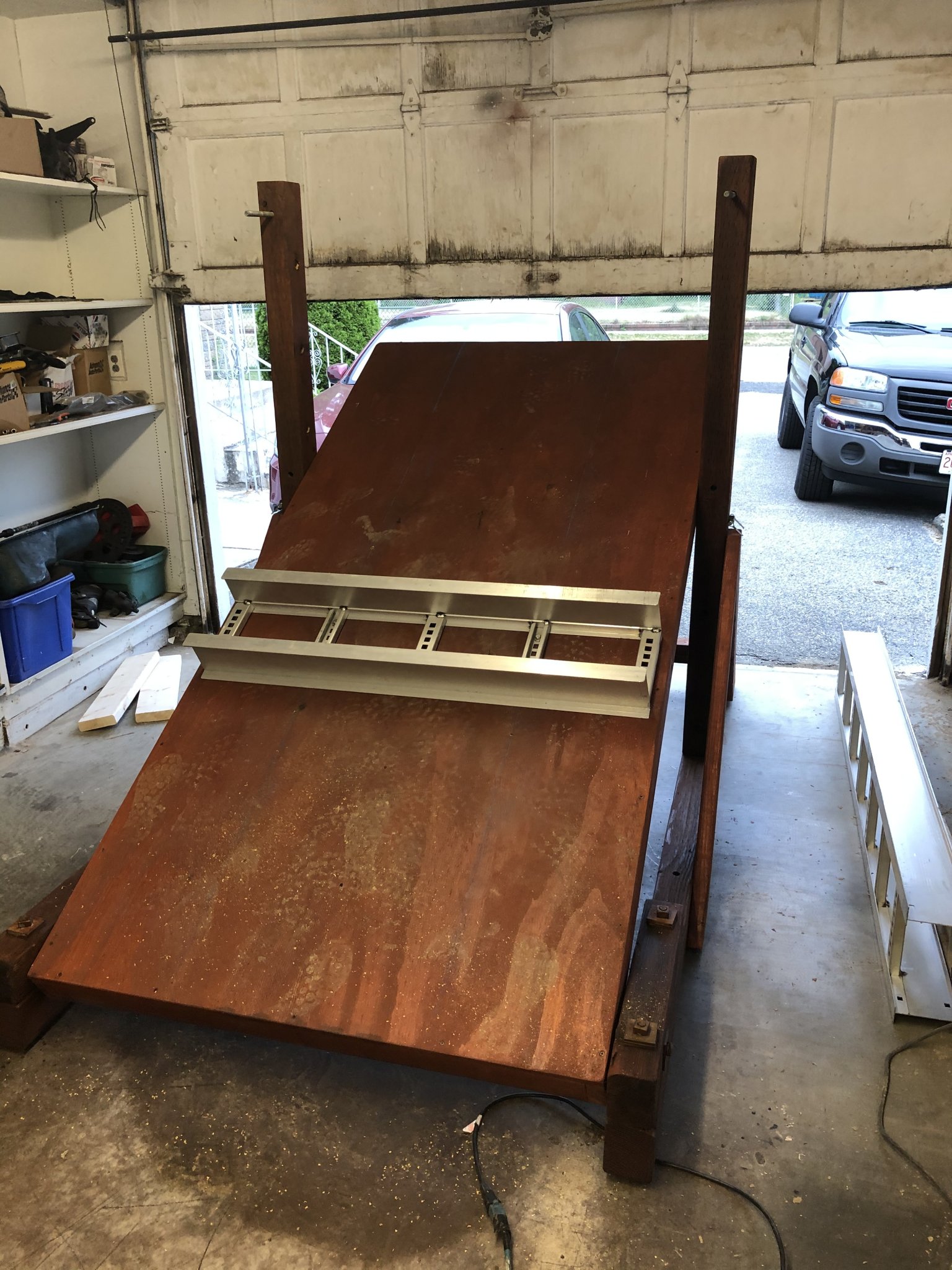

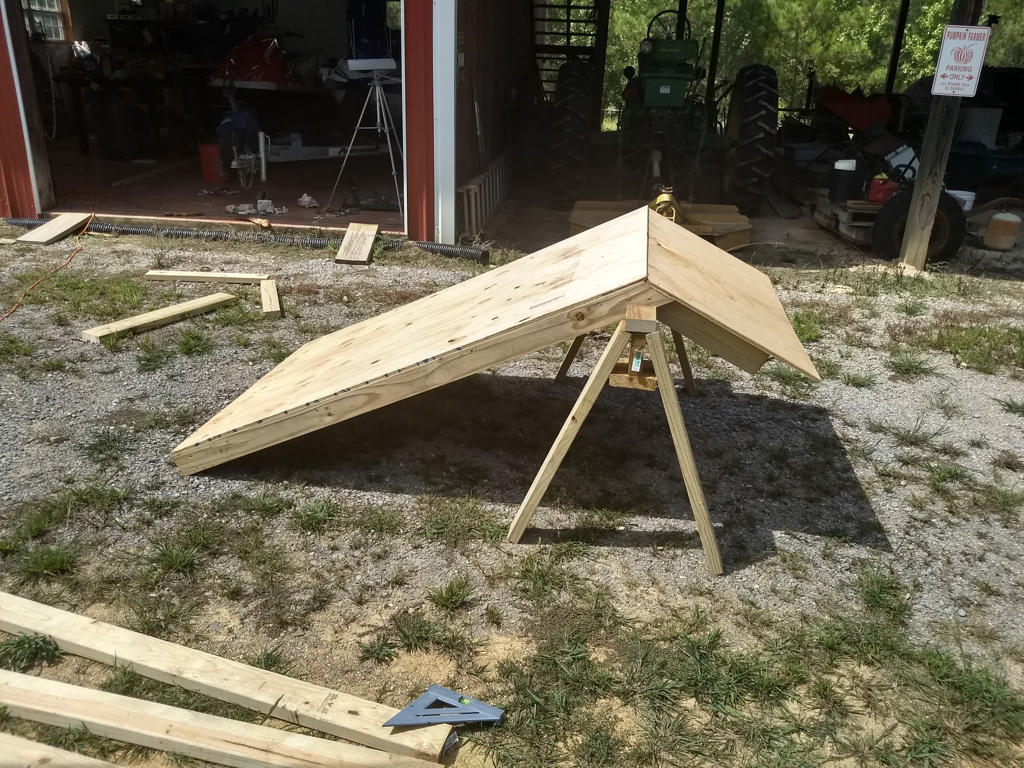

Photo of a buddy on the rooftop I built. You can see it rests of a piece of piping that goes through the holes on the stanchion posts. You can choose the height you want based on the holes you use, which also induces more/less angle. Cotter pins fit through holes I drilled in the ends of the pipe to keep them from sliding themselves out.

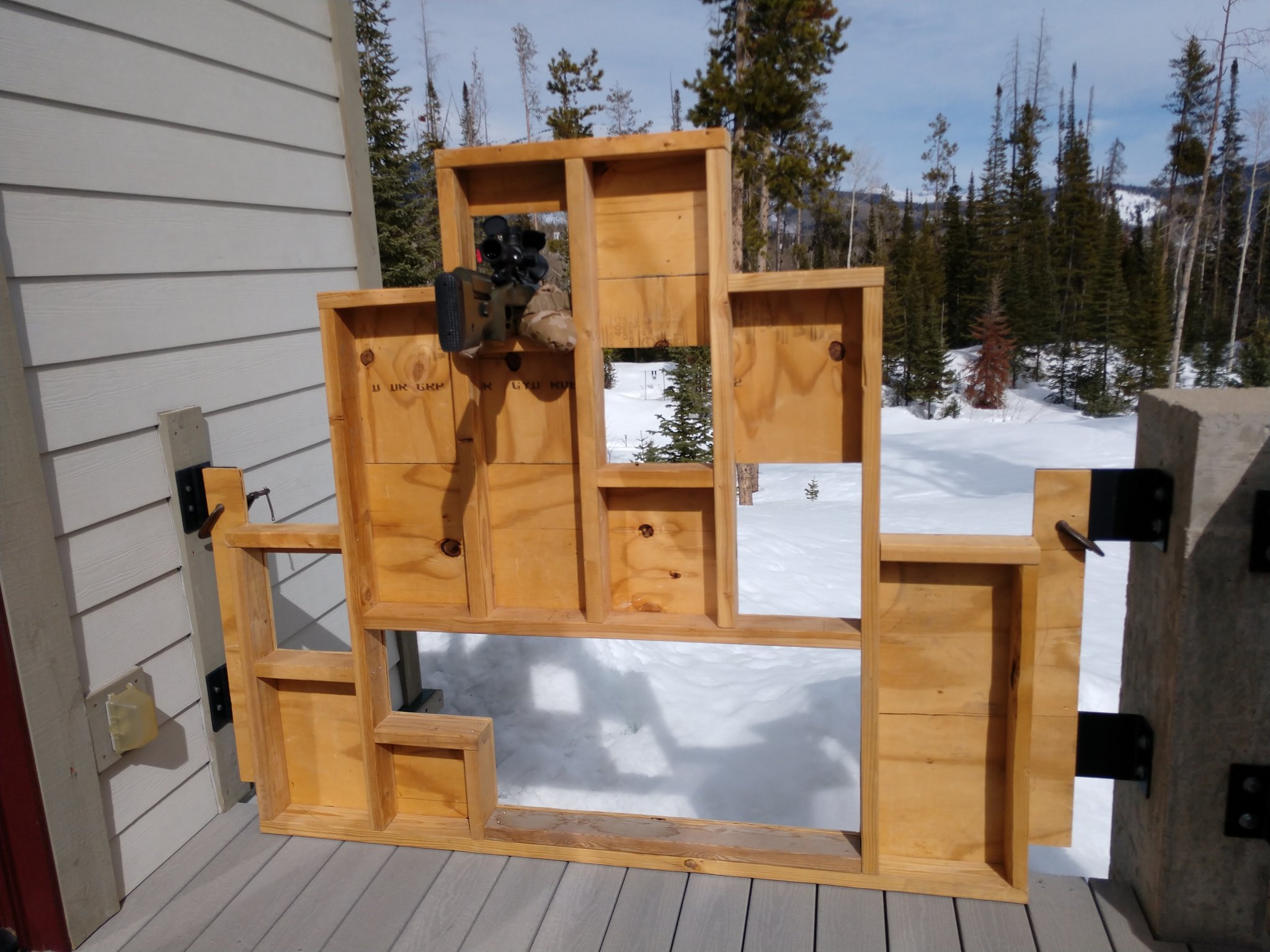

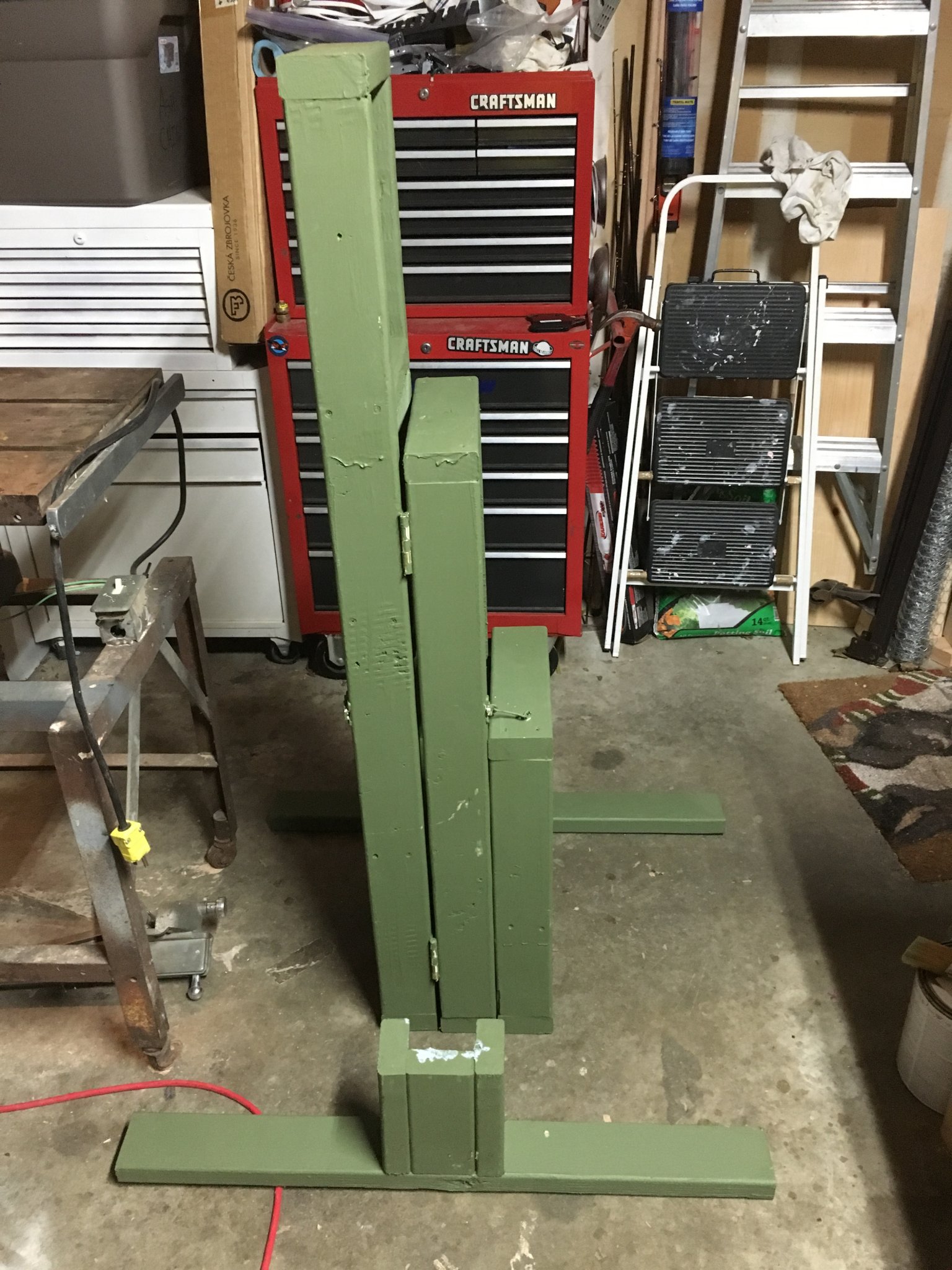

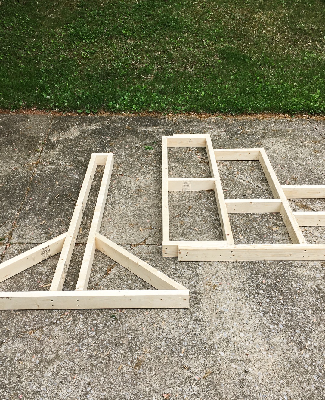

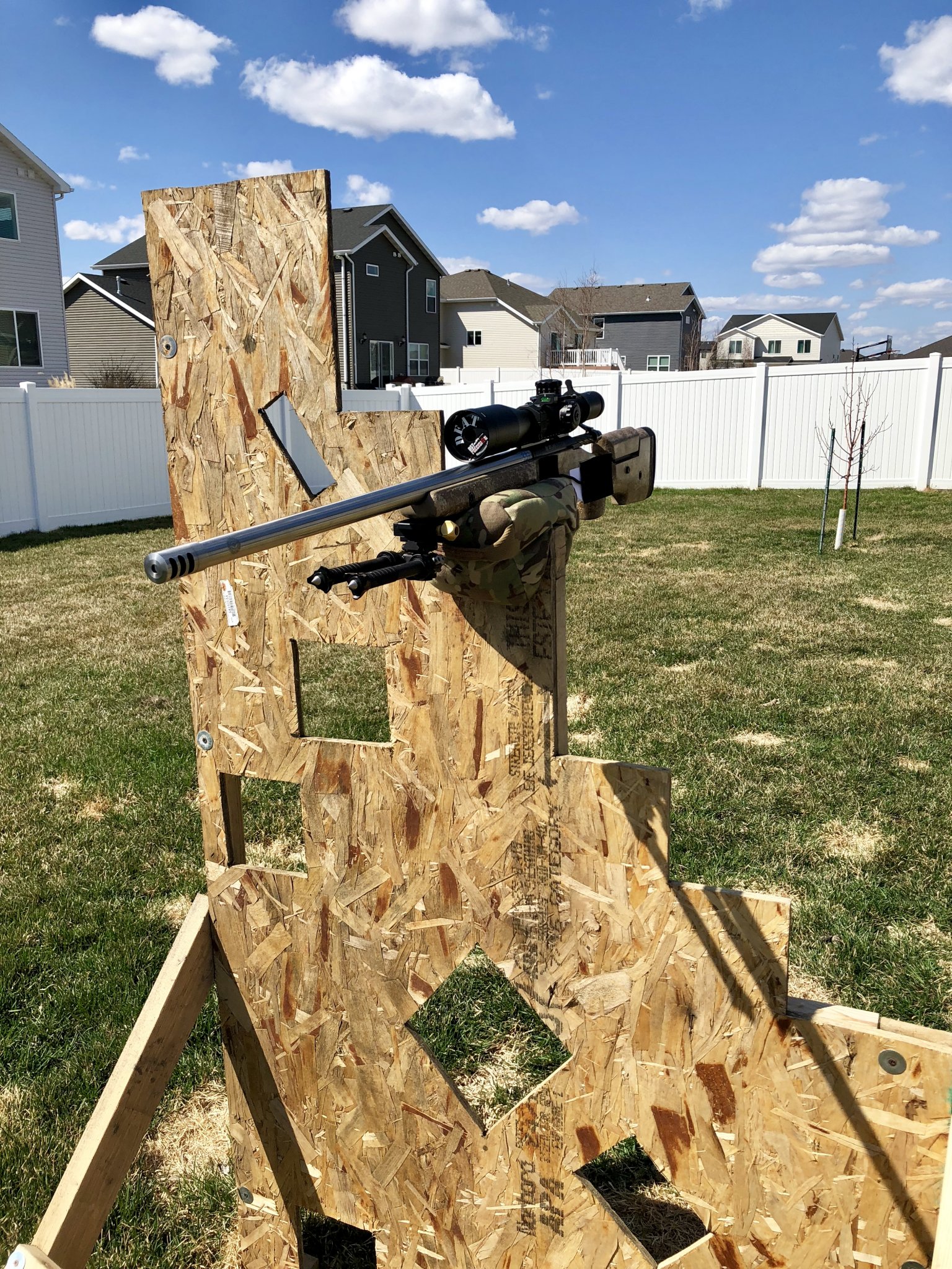

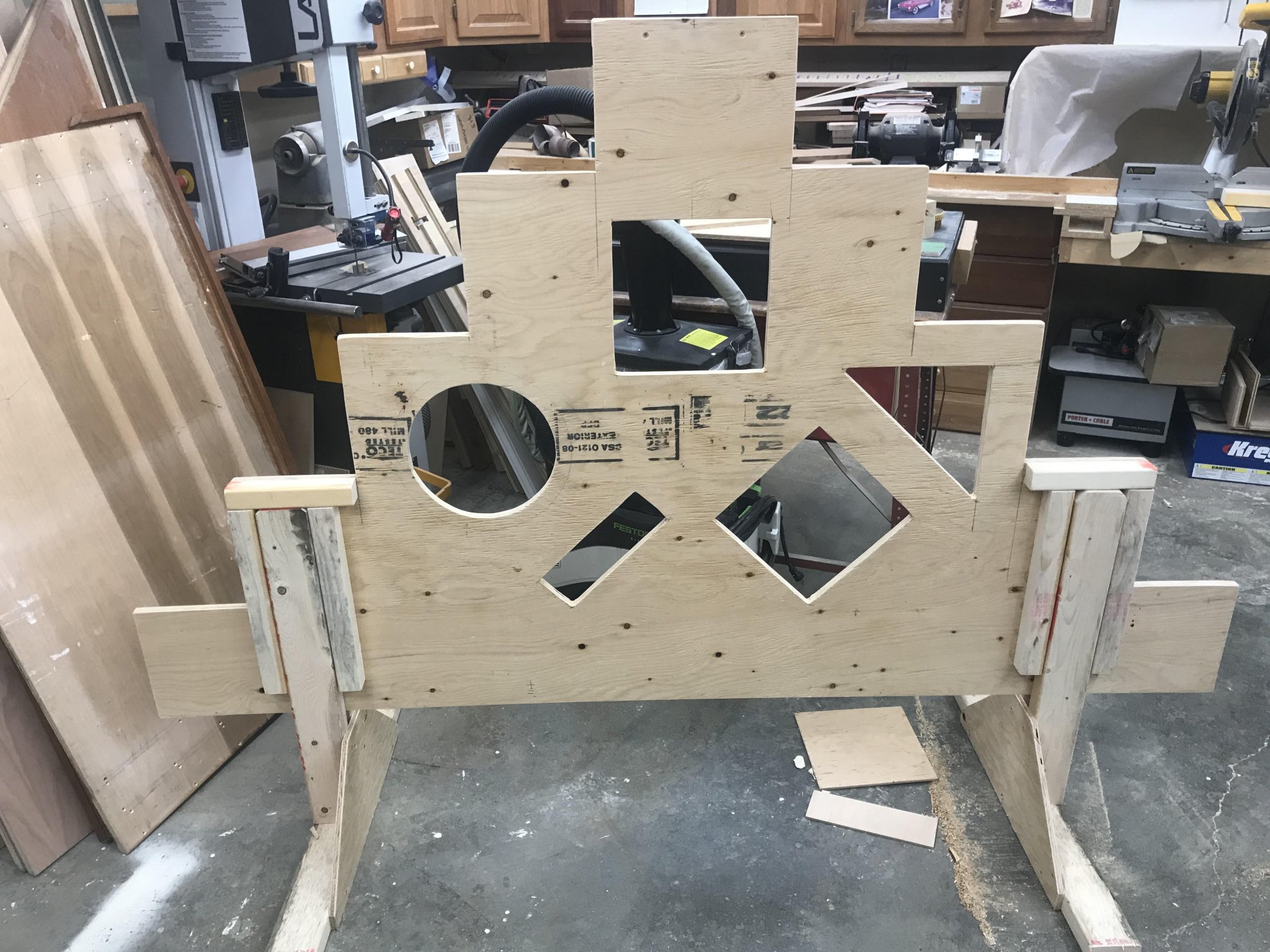

I saw these plans awhile ago on another page and decided to make one. I really like it. It’s easy to fold down and throw in the back of a car or truck. It works great.
That's a really cool idea with the hinges. I copied the vtac barricade, and have to just toss it in the truck bed however it fits. Add to that, steel, hangers, other wooden stands, rifle cases, the list goes on. Kudos on the compact transport.
Thanks. It does make it pretty portable. I’m trying to build a few other props that I can either fold up or take down and put together at the range with very little trouble.

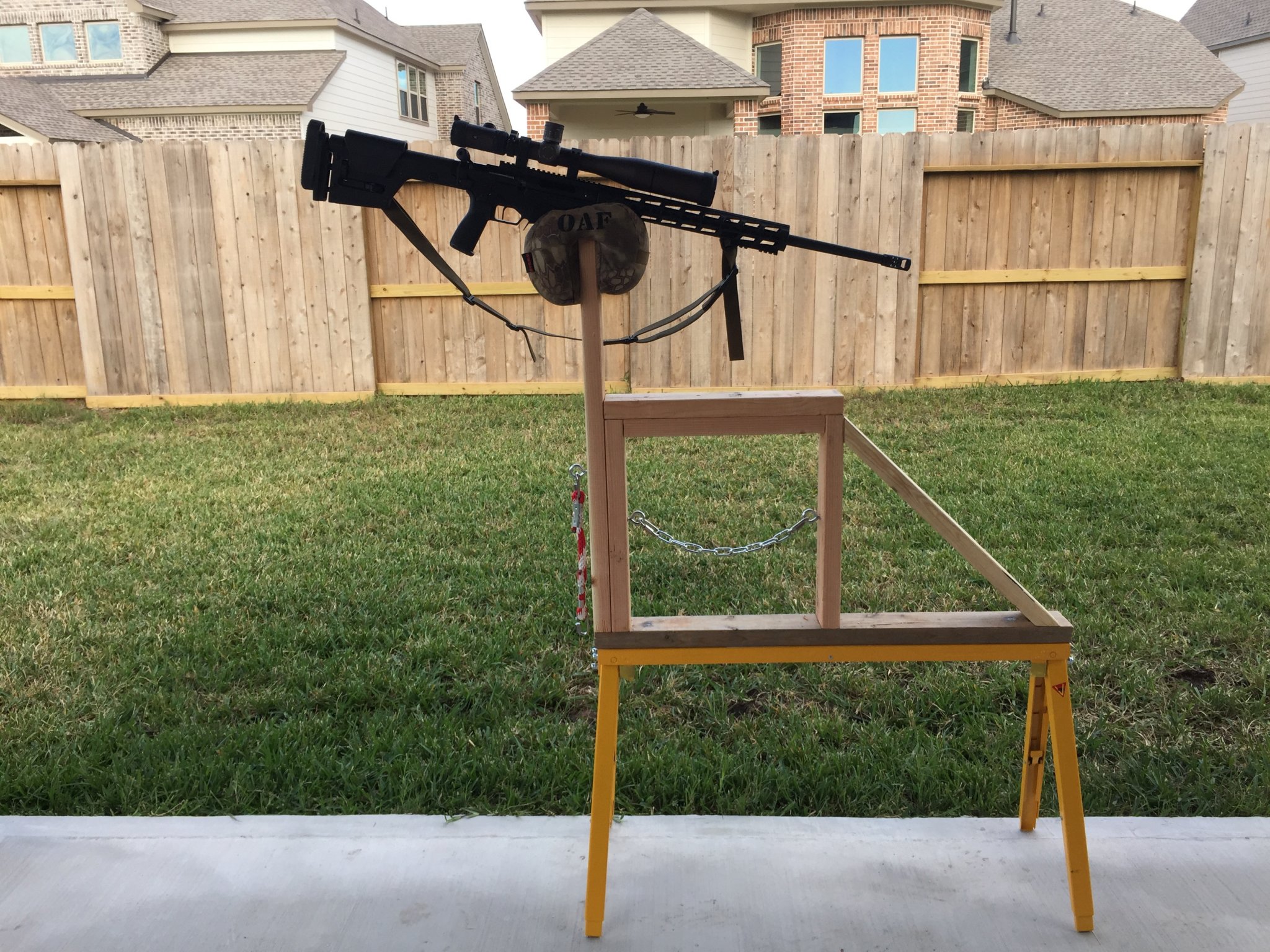

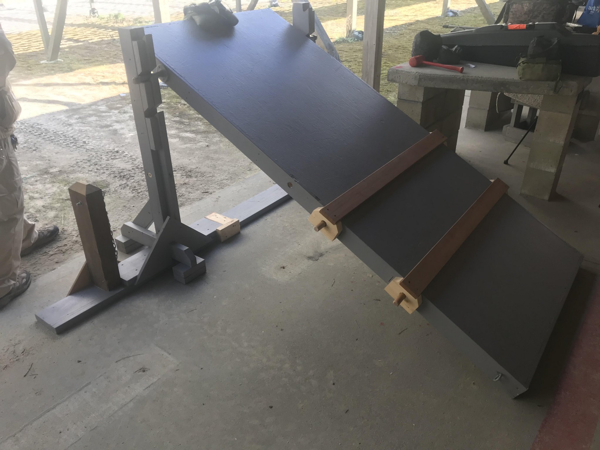

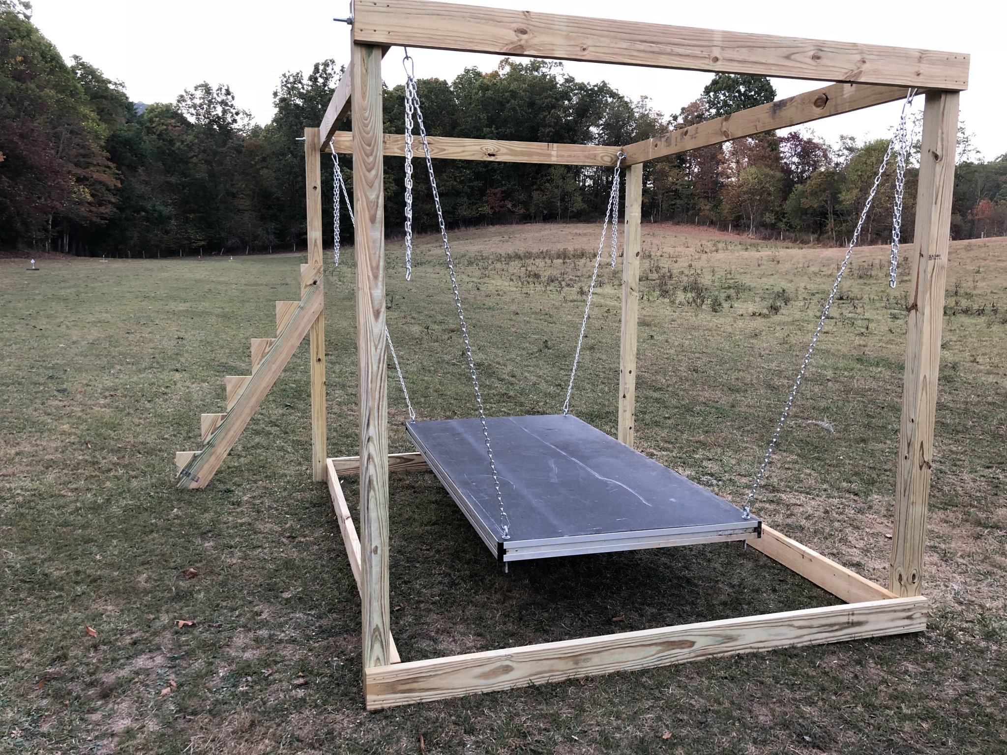

I made some practice props also. A simple barricade that breaks down off of the 2 stands. A rooftop that converts to a floating platform as well. I used gas pipe fittings to support the roof in notches in the 2x6 uprights for 3 different roof pitches. I added a front peak section since this picture was taken. The recoil actually makes the platform sway.

That floating platform pal.... Looks awesome!!!! Do you have any diagrams for it by any chance? Cheers!
Reactions: goneballistic
Floating platform is awesome and difficult. Whatever you build make it difficult. Rooftop is not so tough unless they make you shoot weakside

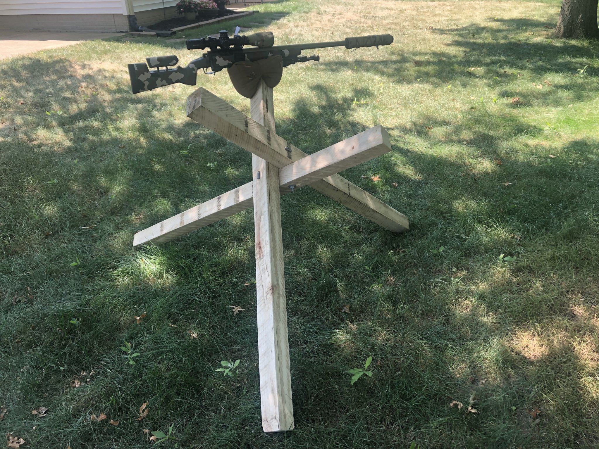

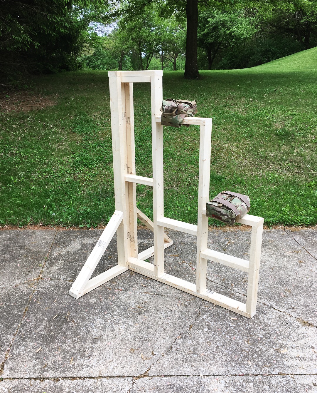

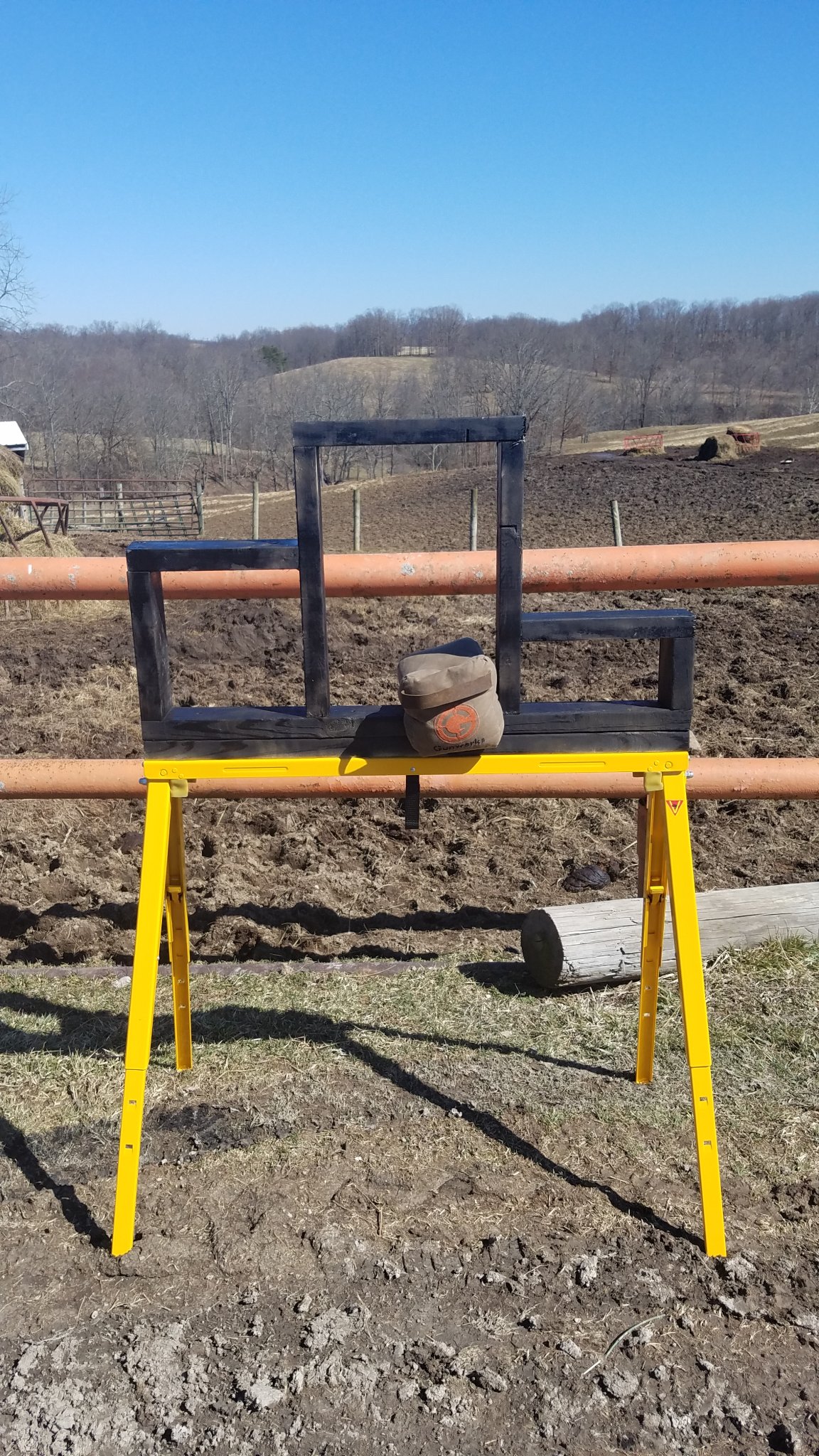

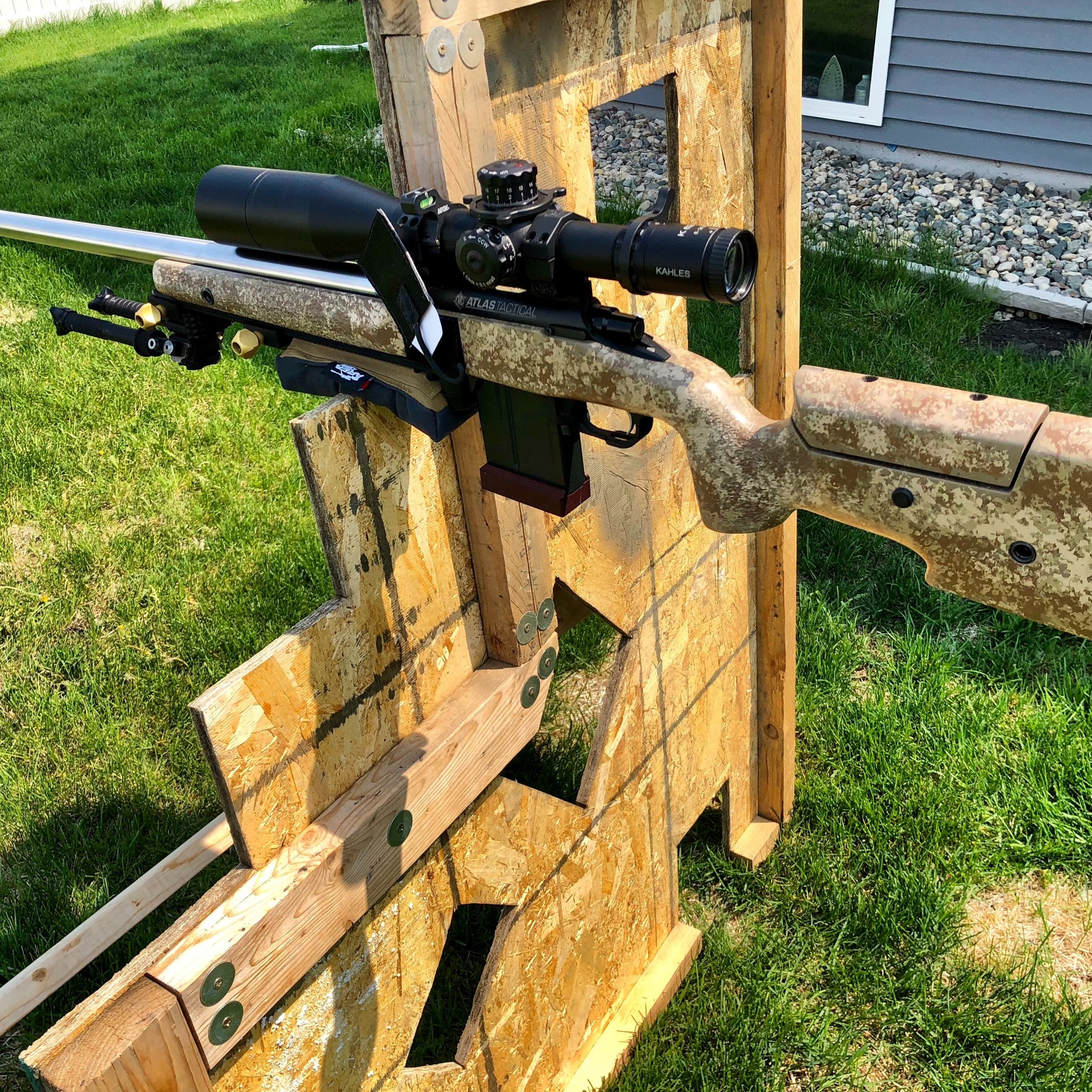

I copied the VTAC barricade and slightly changed some of it to my liking. Works well and it’s wobbly. Just like the barricades I shoot off in competition. If most of the matches you shoot have wobbly ones make yours wobbly also. I practice in my backyard doing dry fire with a DFAT

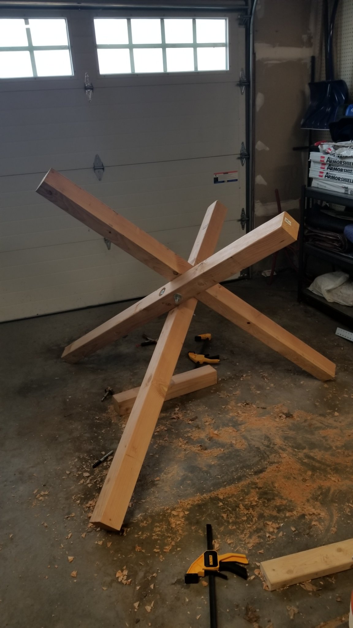

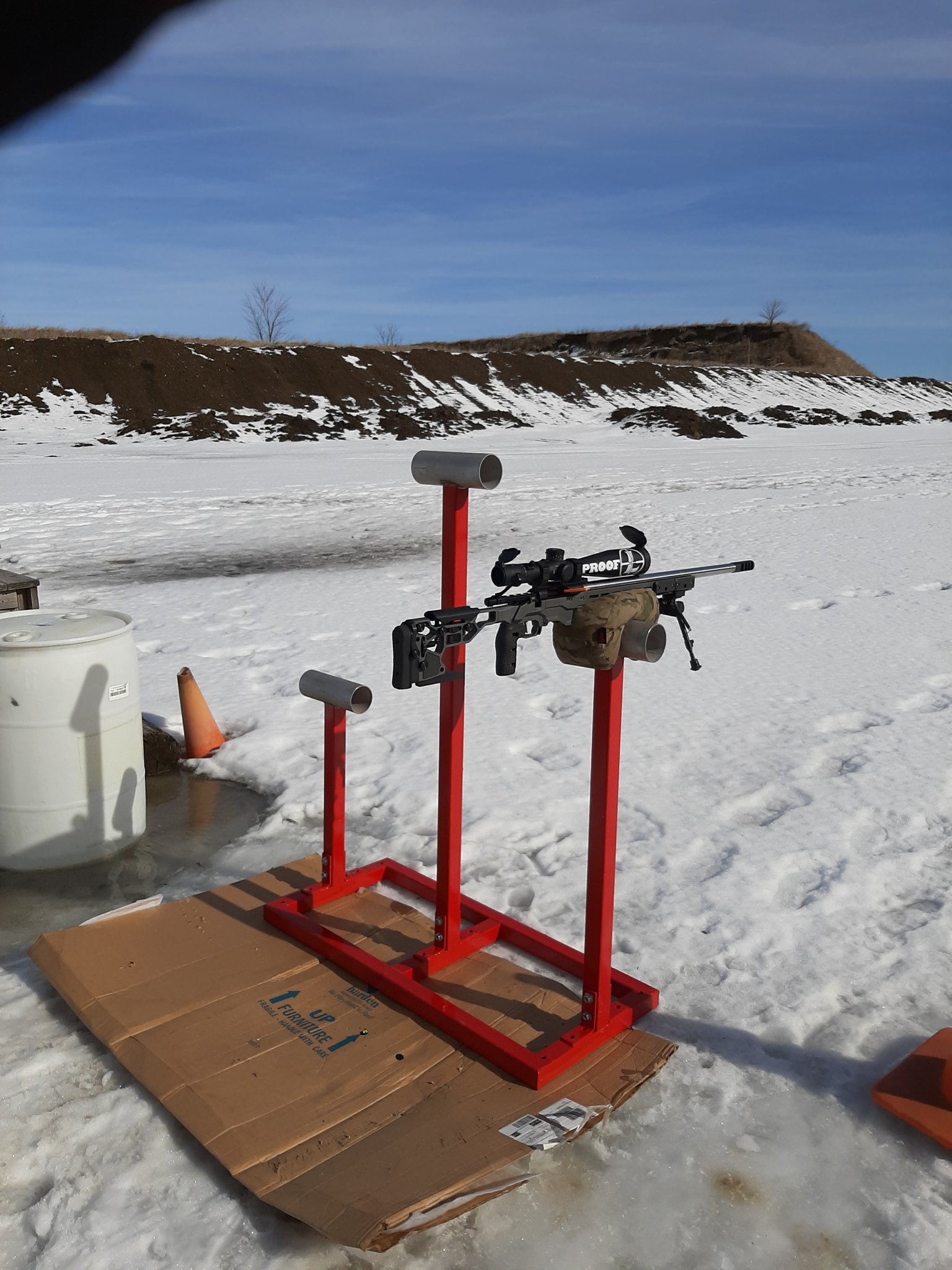

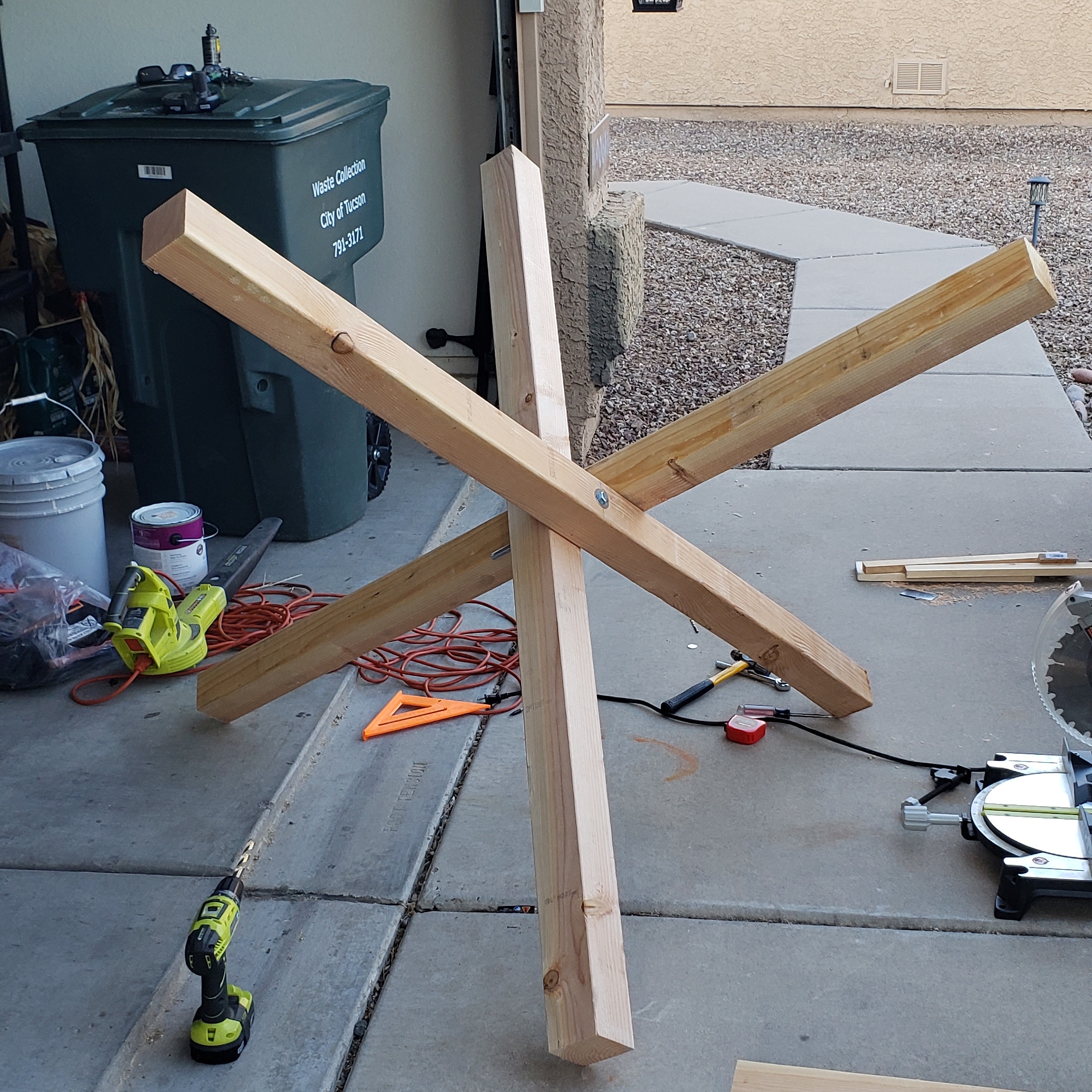

Finally had time to get my tank trap together. Will be working on a roof top attachment for it and one other barrier.

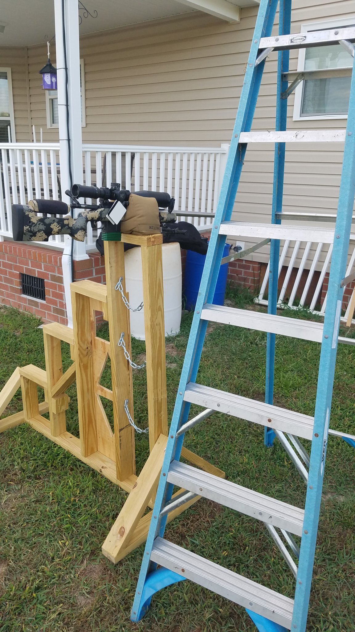

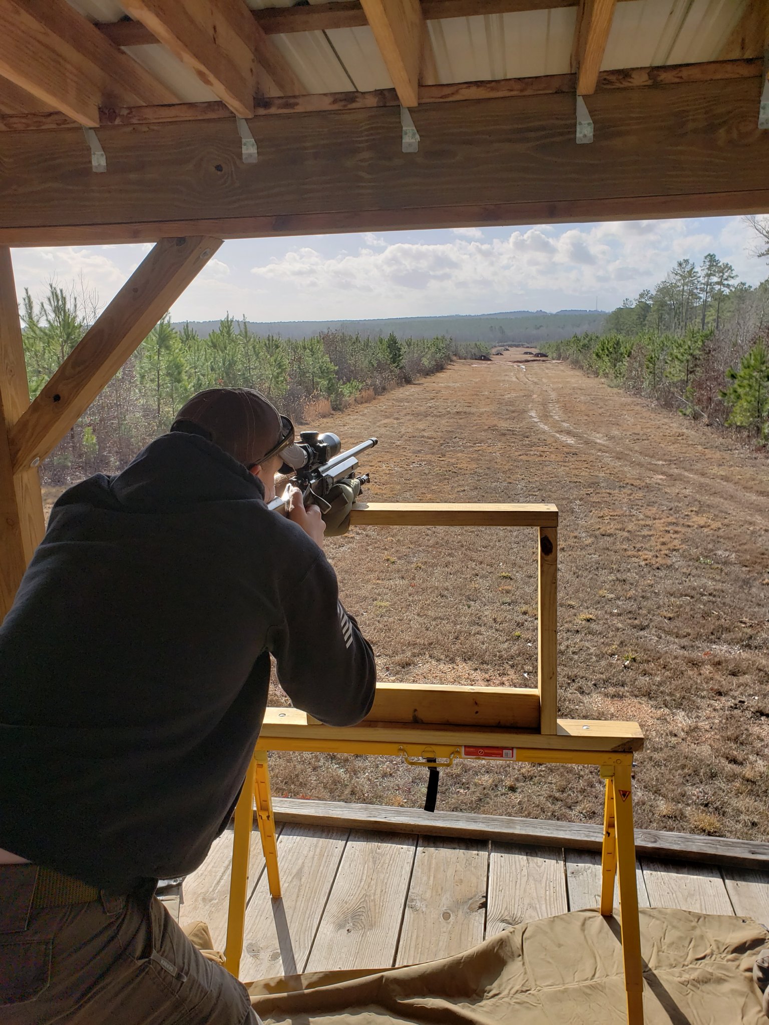

I used to use a fancy wooden gig, all cut up with ledges and holes. Then I stepped up to this. Its foldable, super lightweight, easy to pack up, and quite honestly, works about the same.
Edit; Oh! And I forgot to add... it doubles as a ladder. ;)

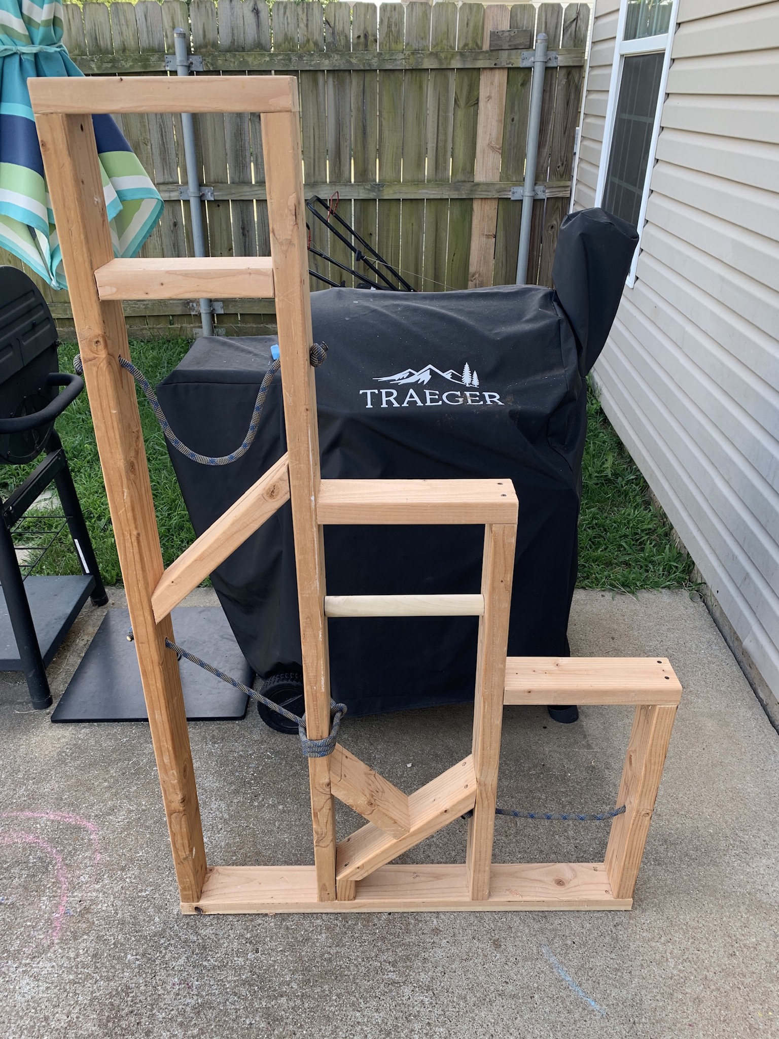

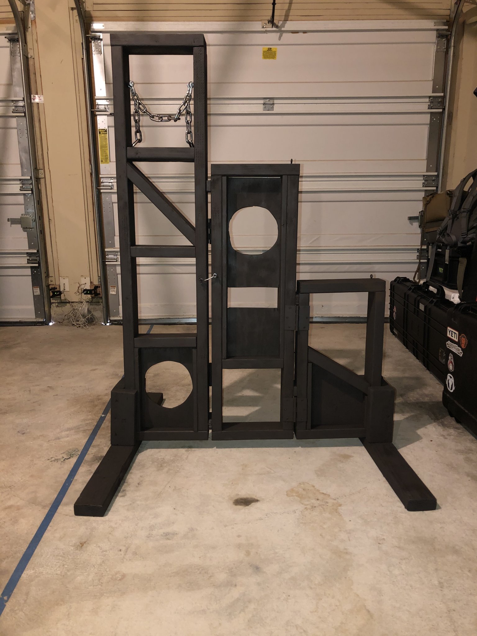

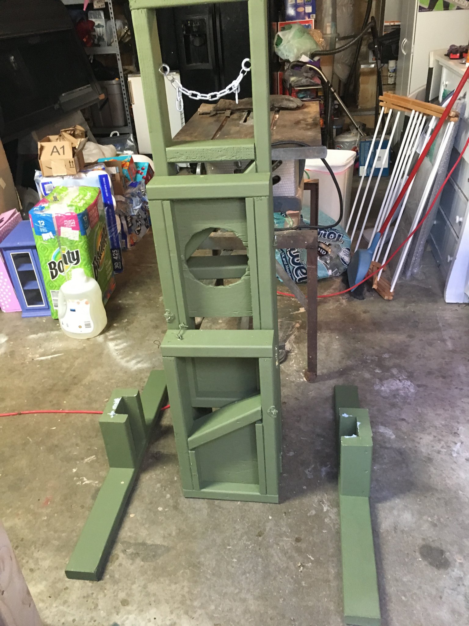

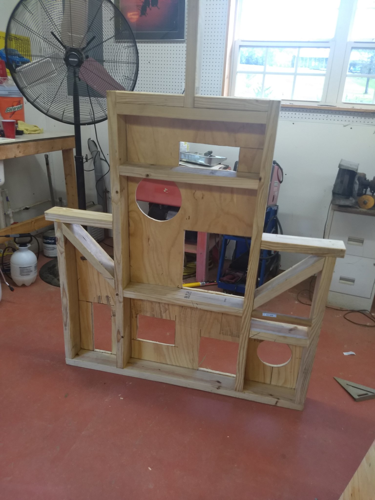

Here’s one I made two weeks ago. 4x6 crossarms for base and stand, 2x6 for support, everything bolts together, even the 4x8 top to the back. Allows it to swing easily to adjust and keeps everything supported.
