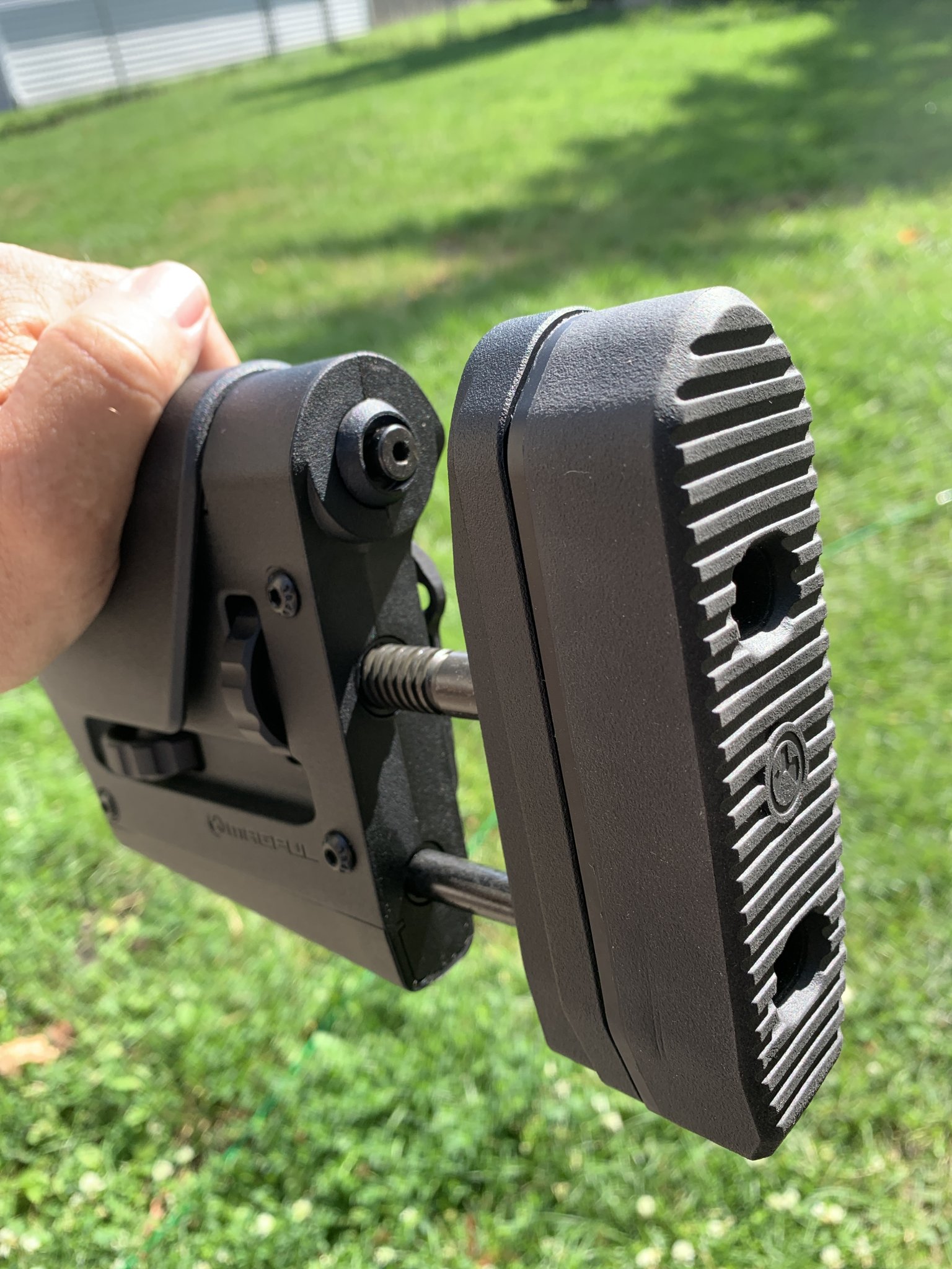

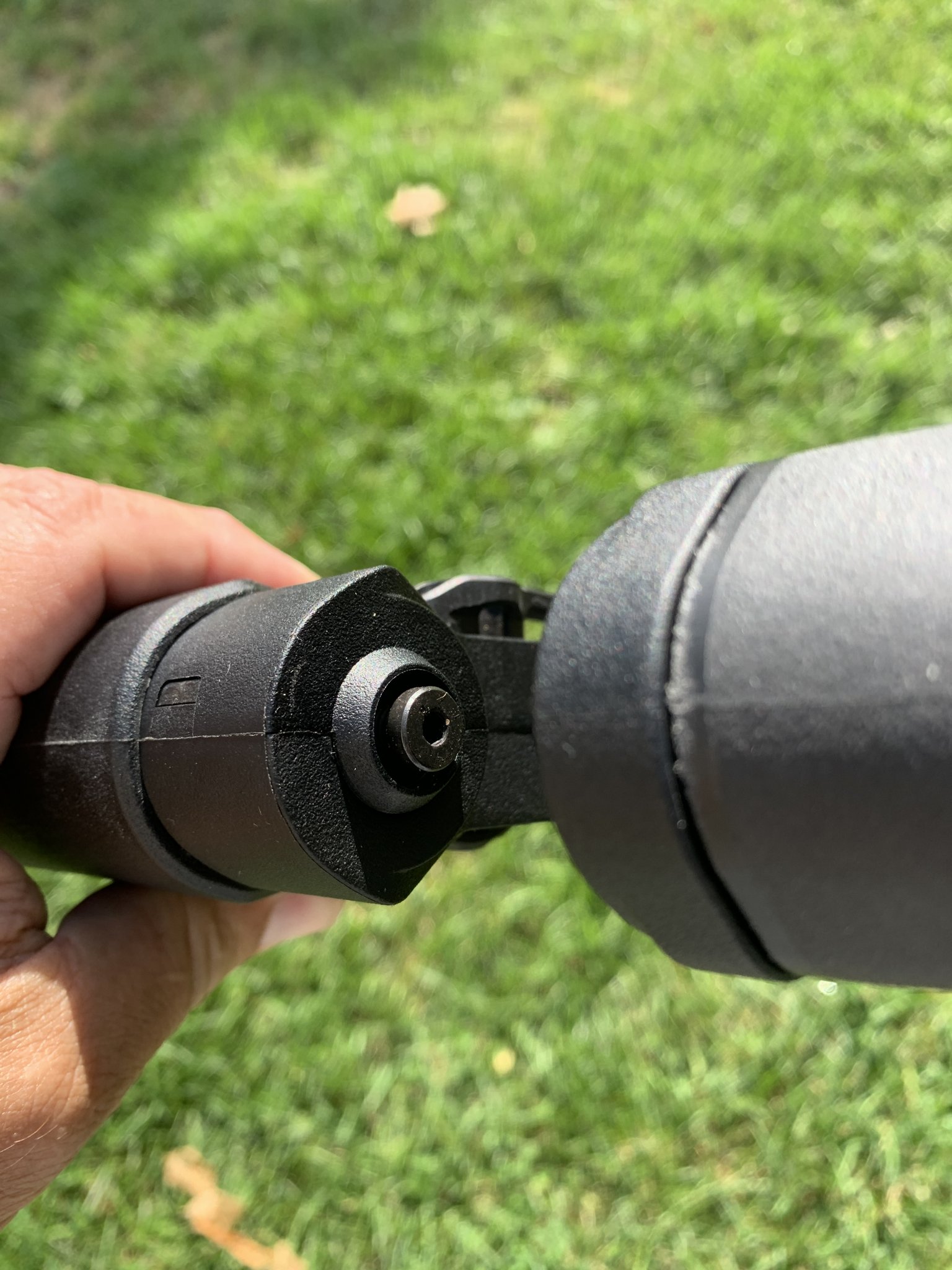

    Weird problem I wasn't expecting, after installing lots of these with no trouble at all. Here's the story ...
    I have a LWRCI REPR MKII Elite in 6.5 Creedmoor that I shoot suppressed, and even on the lowest gas setting, it's a bit over-gassed and ejecting around 2-o'clock (out in front of my bench). Since it's such a high-end rifle, I decided to splurge and get the heavy JP Enterprises AR10 Silent Capture Spring to get my ejections tuned correctly. This setup recommends removal of the buffer retainer plunger and spring.
    The rifle comes from the factory with a Magpul PRS Gen3 stock. Removing it (like installing it) is supposed to be simple. (1) Remove the forward QD screw and mount, (2) Remove the nearby stock keeper screw, (3) Slide the stock off the buffer tube. Um ... NO! After removing both these screws, the stock doesn't budge, even under heavy pressure and some encouragement from a hammer. I've installed several of these on other rifles, and I checked my memory by de-installing the exact same stock from a different rifle, which worked just fine.
    Any bright ideas on why this particular Magpul PRS Gen3 won't slide off the buffer tube like it's supposed to? I guess it's possible that some factory "genius" might have thought gluing it in place might be a great idea ... but that's hard to imagine.
    Reactions: lash and Steel head
    Photos deleted ...
    Bless you my friend ... that was the missing clue. I lowered the rubber butt-pad, loosened that screw, and the whole thing slid off smoother than a Nun at at her first Crisco Party. THANK YOU !!! I've never installed anything other than Carbine stocks. Totally didn't know about that screw required for rifle length tubes.
