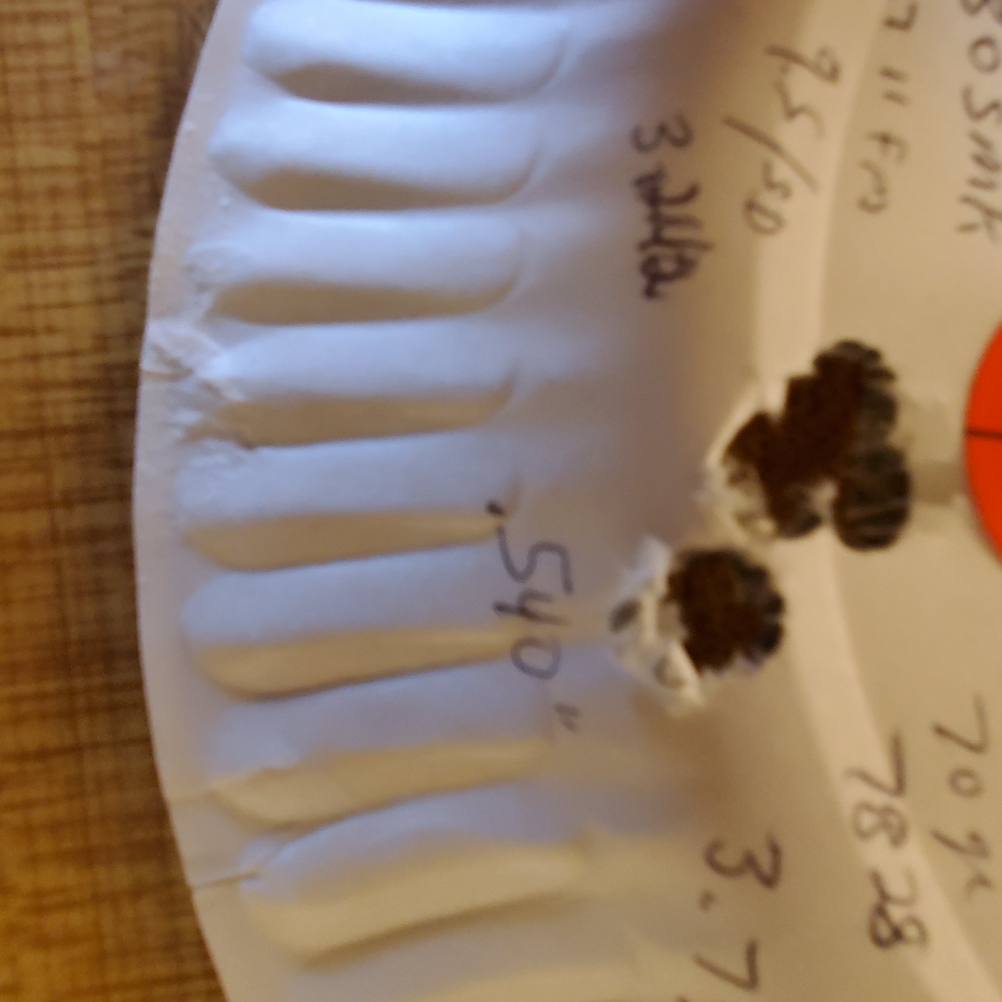

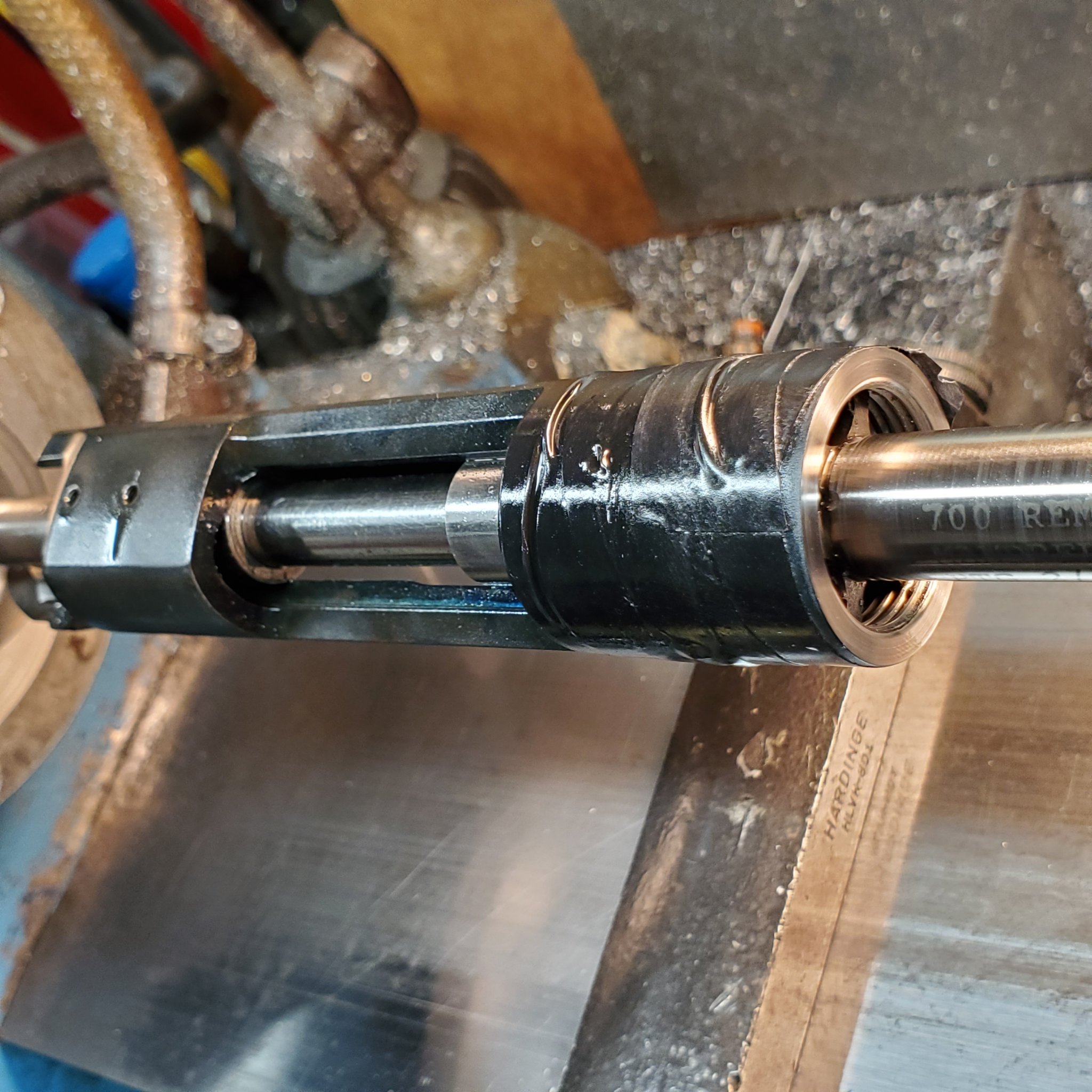

I purchased a new Remington 700 300 win mag for $540 total cost.
I wanted it just for the action .
But before I took off the barrel of the new rifle.
I decided to shoot it, with some handloads to see what a cheap rifle was capable of.
It was surprisingly accurate.
Not that I really cared because it's a doner action for another project.
It really liked IMR 7828 and 200 gr SMK, putting the first 3 or 4 in one ragged hole, with the another one close, which could be the shooter, or barrel heating up.
Either way it was pretty accurate for a cheap hunting rifle.
Obviously can't say they are all that way, this is just one example, of a new Remington 700.
I believe many of the new factory rifles are quite good with CNC manufacturing.
Choose whatever you like.

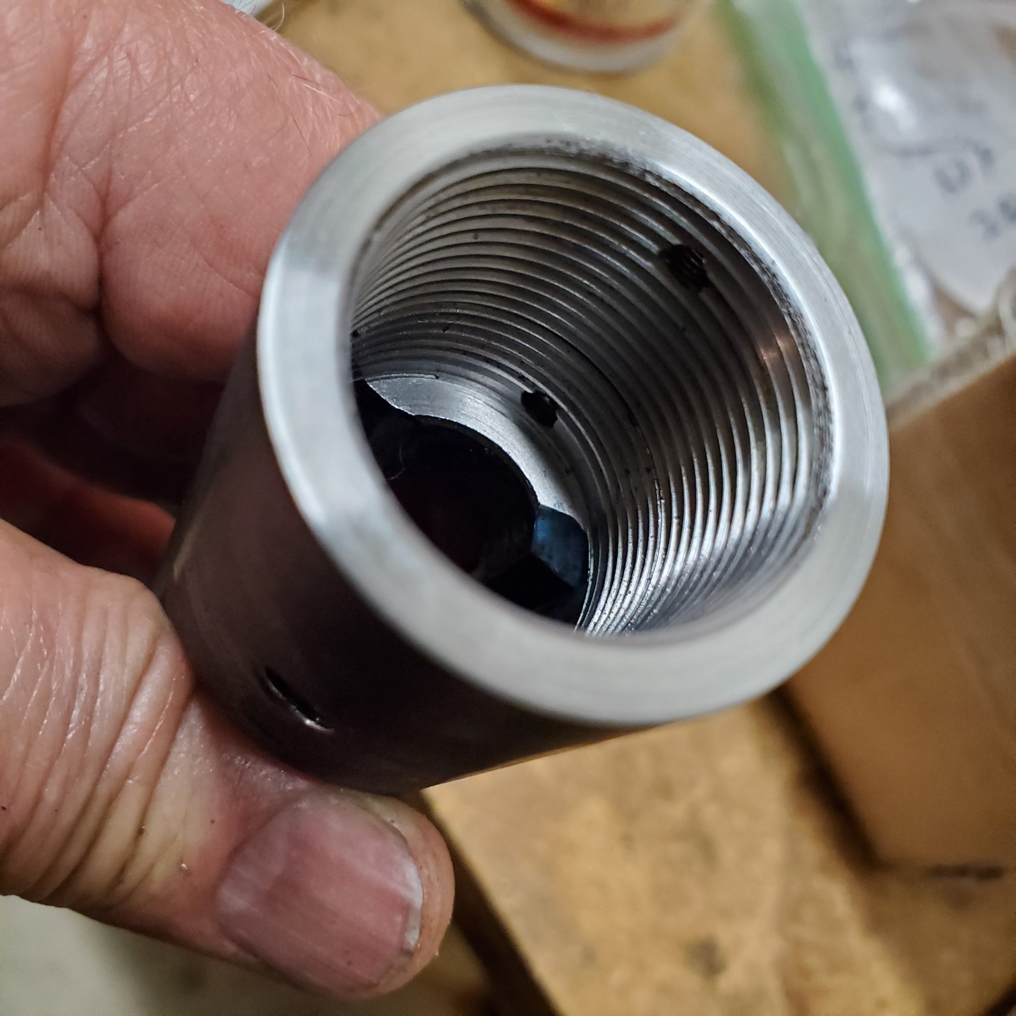

I built this Rem 700 308 for $834...not counting the scope.
The action was free, the Bartlein 5R 9 twist Rem varmint countour cut to 22".
Threaded for muzzle brake and chambered free, as I already own the reamer.
It shoots .715 BC 200 SMK at 2740 fps with Lapua cases. More velocity with hybrid cases, but that is for serious reloaders.
Good for 1700 yds depending on elevation.
You can do the same without the machine work. Get a Remington 700 Action, with 308 bolt, get a prefit 9 twist and a go gauge,
Stock HS $345 on sale, or Aluminum chassis available for $300 to $400, with detachable center feed, for long bullets.
Thread it together, and torque up the stock screws, the aluminum bedding block and alum chassis require no further attention like skim bedding according to the manufacturer.
Remington triggers are internationally adjustable and reliable at 2 lbs, without aftermarket triggers to buy and you are competitive...with lots of practice.
The lighter calibers have less recoil for those who prefer little recoil the 6 mms are good.

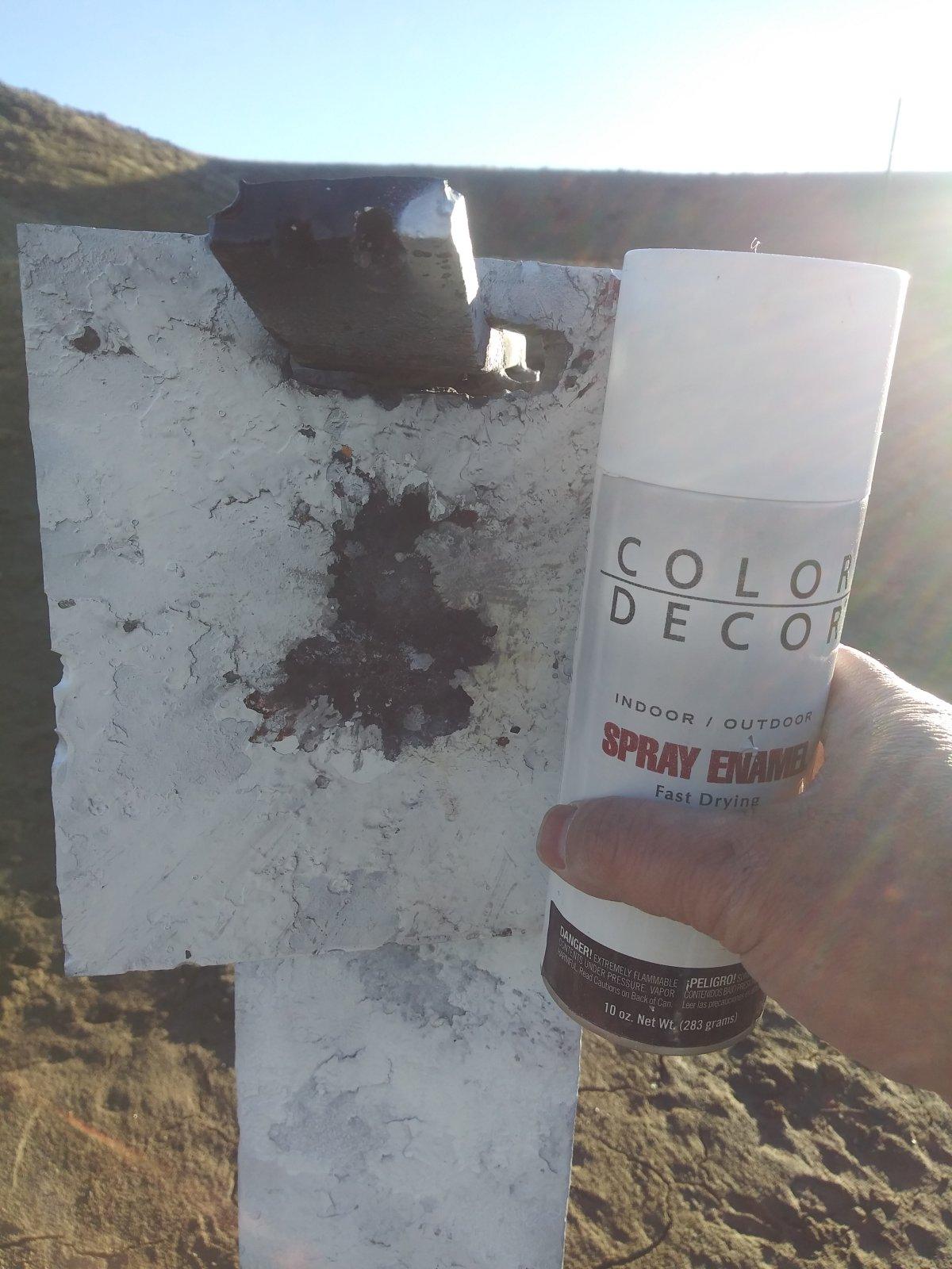

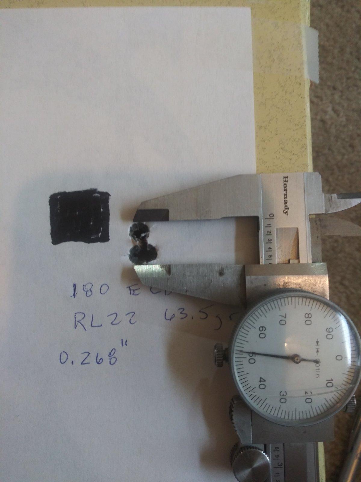

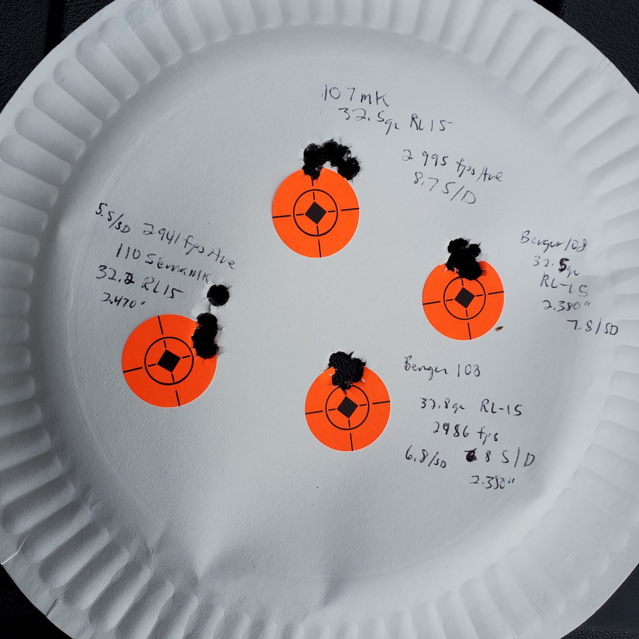

I happen to like Remington 700 actions, and true them with ease.
They are just as accurate as any other action...shown 5 shot groups with different powders and bullets the average of 13, 5 shot groups that day was .313" trued Remington 700.
A better shooter could do better, but this 700 action was off a factory varmint made in 1972 $199 for the whole rifle. Truing free. Built the whole rifle, from a Bartlein blank, trued the action after barrel take off and loaded ammo in 12 hrs, and out shooting groups the next day.
The barrel is much more important than the action...unless you plan to run those 100,000 plus psi loads, talked about.
Cost nothing, but my time, cause I already own the machine tools, inspection tools, and tooling.
For me the Rem 700 rocks, one can build a very accurate rifle, for very little...
And I can't help it that you never became a machinist, "the best job in the world."

It takes a good metal lathe and the ability to use it. Some carbide tooling is available, but expensive. I use it to get excellent finishes.
There are videos on it, but it's probably not something the average guy will do without some machining background.
Chase, or recut reciever threads, reface, cut square bolt seat, on boly cut back of bolt lugs square. Blue die is applied so the cuts are only to clean up ... no more.
Too much off anywhere takes away from caming action of the bolt handle caming the round out of the chamber.
I also chamber the barrels. So all that work is free, for me.

Picture of facing the Rem 700 reciever to just clean up. With threaded carbide centering mandrel in place.
The next picture is a new Rem 700 in 300 Win Mag $540, but put in an aluminum chassis, with 200 gr Sierra MK .715 BC...
Nothing else done to this stock new Rem 700, the barrel likes the bullet and the bedding is fixed with the chassis.
Remember the 3 Bs. Barrel, bullets, and bedded.
If you new rifle shoots like this new Rem 700, time to go shooting, and stretch it out.
8000 rds of 308 learning experience is now available, no further investment needed, for now...so how ya like it and tons of money can be spent later, looking for improvement.
