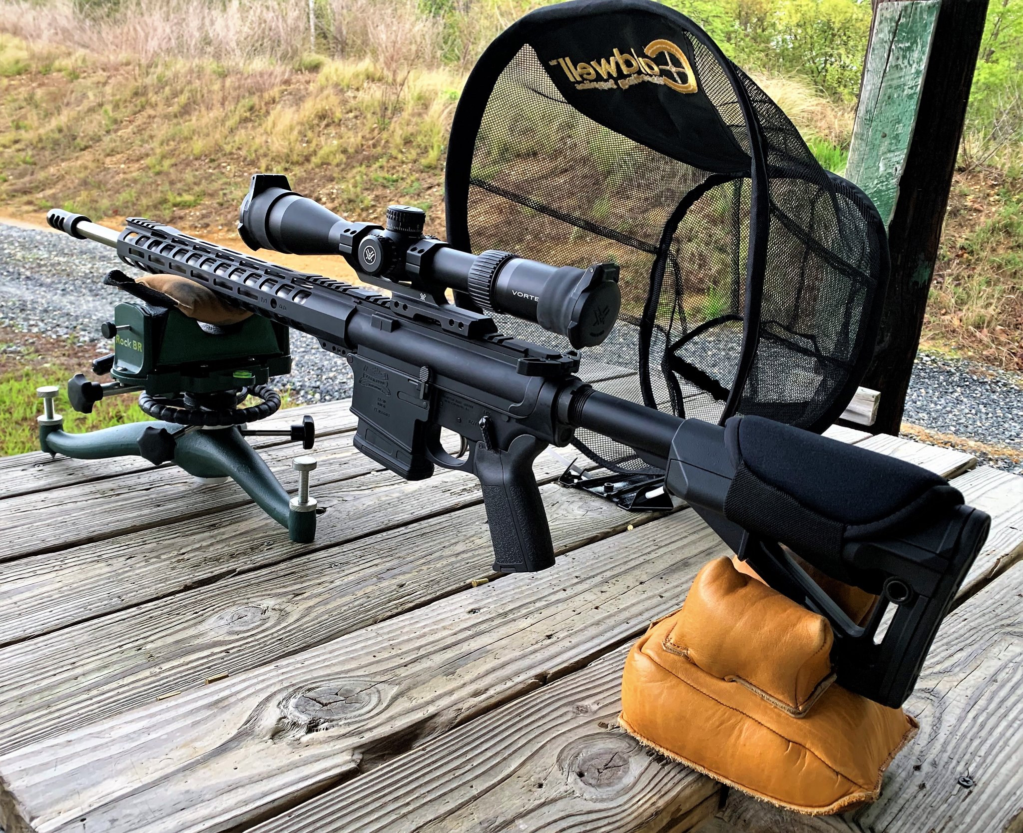

I also have a Gen 2 308 PSA, 5-25x50 Vortex, swapped out trigger to a Hiperfire Hipertouch Elite, 419 brake.
Same results as Rob01. Likes 178 eld, 175 FGMM, 168 FGMM.
No compalints whatsoever. Traded my Glock 20 10mm for it.

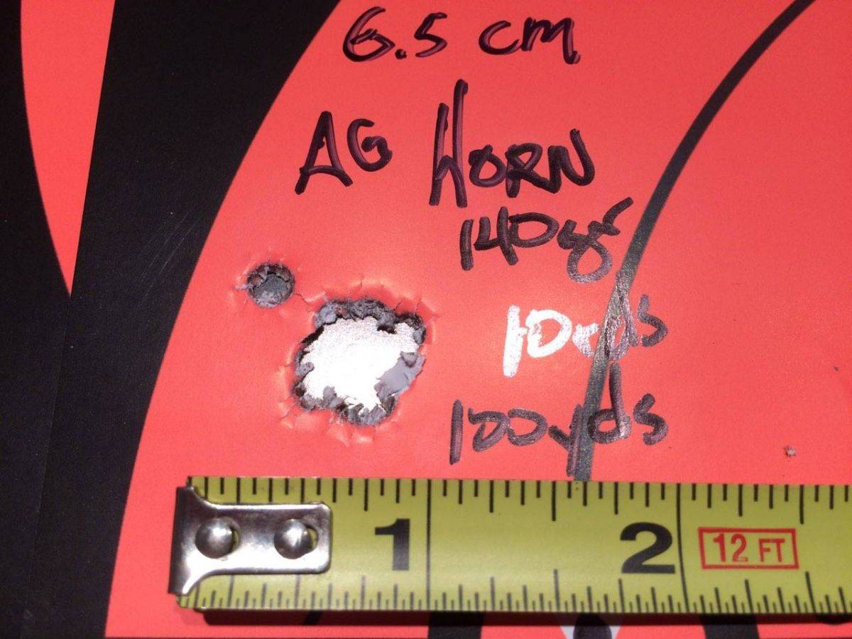

Changing the PSA barrel over to a Criterion 22" produced this 10rd / 100yd group.. I routinely use that rifle to 1200yds

And I have a PSA 308 upper that can do this.. 10rds , 100yds
Both those groups were after I added the Adj. GB's ( SLR ), lapped the upper receiver face flat and Loctited the barrel in place, snugged up upper to lower fit, heavy buffer setups, and Lantac muzzle brakes. Various triggers.
So... IMHO, the PSA's can be darned good rifles.
