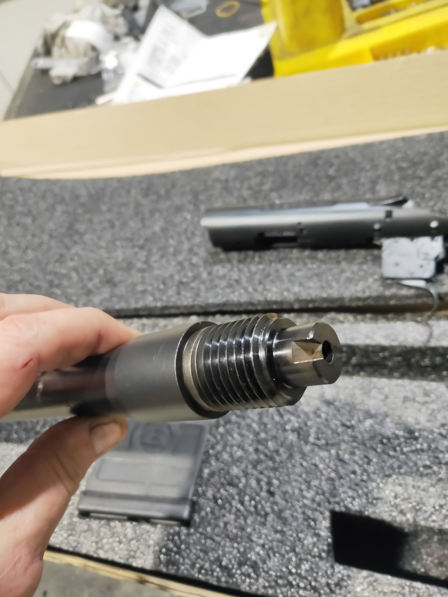

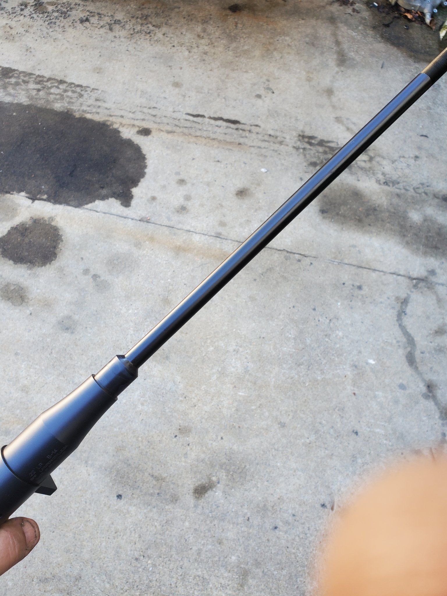

First in my quest to figure out why the cold bore shot was so far off and as the day got hotter the groups were opening up to look like a shotgun blast. Tried all types of ammo and some helped but still had problems. So in getting the barrel ready for a suppressor i started checking runout and such. the barrel nut [not thread protector] had some runout so wanting to do the best job and min poi shift with suppressor off and on,started checking other areas. barrel trunon was .005 then i cked muzzle threads for runout .050. then cked with centerline of bore and was perfect.
So i started thinking maybe something with cf barrel so i made a a tool to unscrew the nut behind the barrel thread protector and to my surprise here is what i found!!!
As you can see the barrel is NOT wrapped in carbon fiber but it is a cover and the barrel is .500. So i bought a pencil barrel with a cover for 100 bucks more and shots worse than the steel version. So those of you who are thinking about a cf version think again. i went a trued up the mating surfaces and am hoping this helps if not berg is going to hear from me!! thanks Stan

I thought it was common knowledge most of the cheap carbon barrels were sleeves and not real wraps.
Might be able to make it shoot with torque on the muzzle nut to essentially tension the barrel.
I didn't know they were sleeved... IMO a $300-450 barrel should be solid carbon, no excuse not to be.
But I just tapped on my Valquartsen CF barrel, and the barrel on my Christensen Arms Ranger 22, and they both sound like a hollow tube, as well. Not impressed... 😠

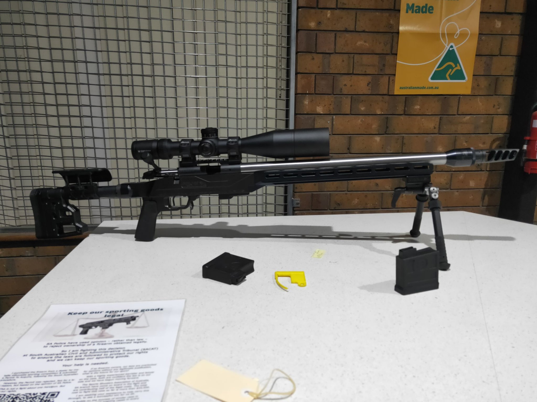

Either way, I did some reading and the CA Ranger 22 has a 416R blank with a Bentz Match chamber, and I finally went and shot it today. It shot a 0.438" 3-shot @ 100, and a 1.2" 3-shot group @ 200 yards with bulk CCI ammo. I'm pretty damn happy with that.
Checkout my thread on it for pics of the groups and stuff... I'll keep it updated as I go along.

Some are missing a point that i pointed out. WHY a pencil barrel? They could of left alot more material on the barrel than the .500 that they did. the inside of the cover is close to .875. why not make the barrel .750. this thing when it is hot outside 90+ degrees shoots like a shotgun with 00 buck. i wonder it the barrels for the CF version are screw up machining of the outside of the steel barrels?
wrong on that! i had to remachine the nuts shoulders that located the sleeve. they were out of centerling to the boreline more than .015. So I spent 4 hours getting things trued to centerline that should of been done at the factory,I feel it the barrel was thicker also those tolerances or i should say LACK of would not stack up as bad.

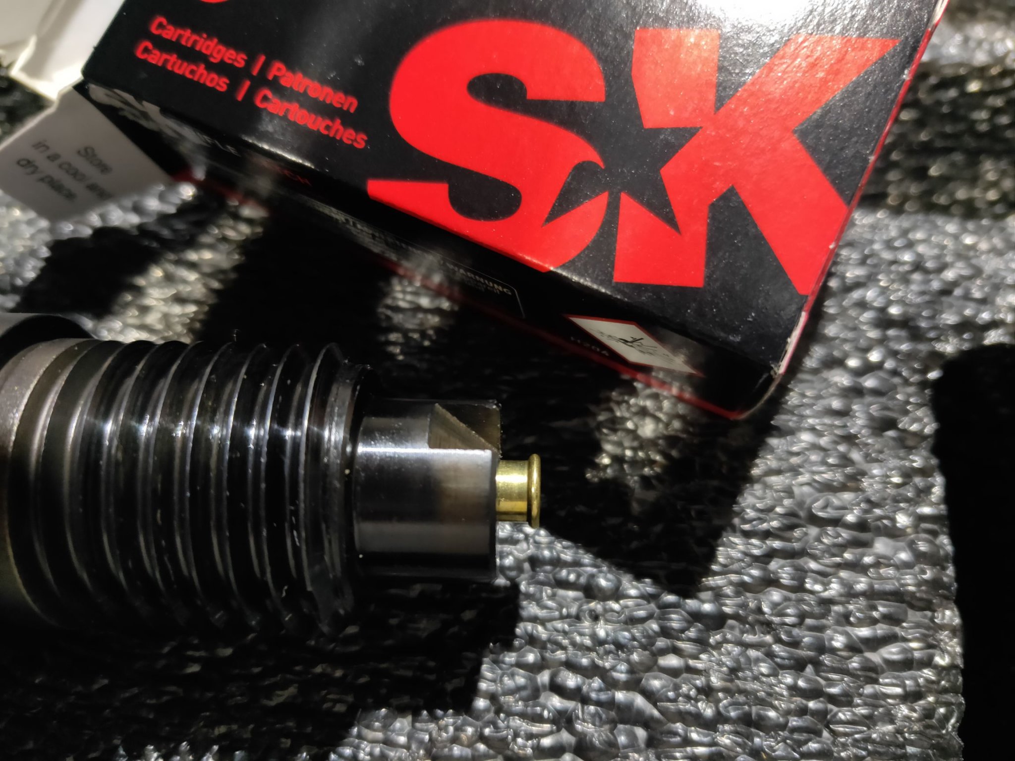

The SK rifle match are touching the lands on th factory carbon barrel. That's where it begins to "jam on lands". Also the thread was 1.14" * 12 tpi from memory, don't quote me on that.

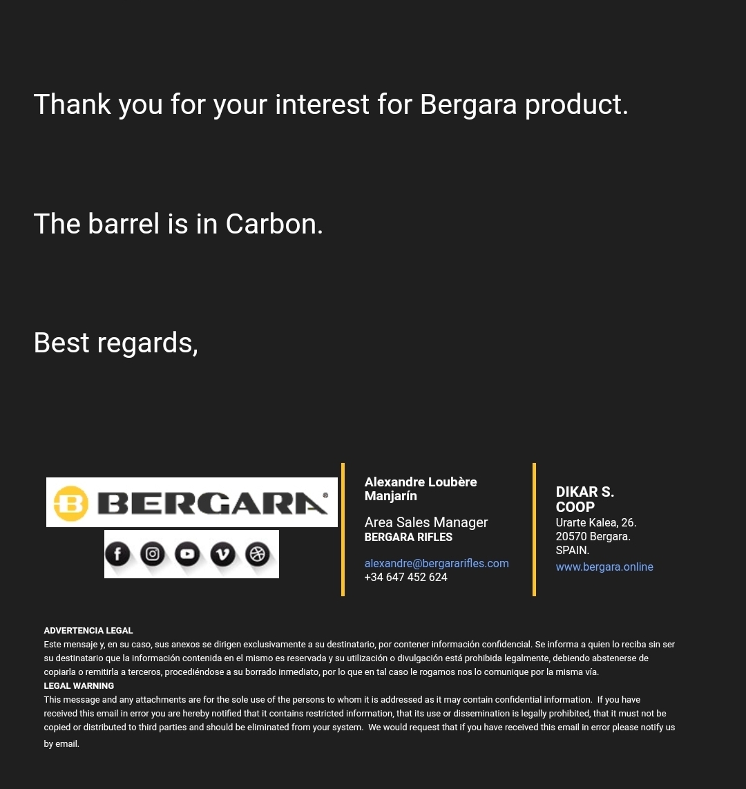

Well, it didn't help you went to the Spanish site, instead of Bergara USA. The language barrier probably didn't help it, either. 😂
Well, on the german Bergara website it says "Carbonmantel" - which roughly translates into "carbon sleeve"... I never considered the carbon version, because I have trust issues with composite materials. :LOL:

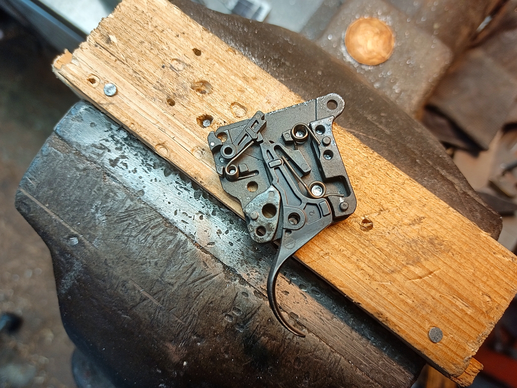

I just did some work on my factory B14R trigger and it's now breaking at 11 ounce's and has an adjustable sear stop. For me that
was a puzzle to solve and not a solution to the factory unit's short comings. It also kept me in the factory class at the LGC.
How to alter the trigger without grinding off the 7 rivets that contain the unit. Someone else posted their trigger shown in photo
#5 and the solution became painfully obvious.
Nothing about my Bergara will ever be as Cool as my Vudoo but it shoots nearly the same even when I sent it off to Lapua.
Though I did put a Vudoo bolt knob on my B14R and that made for a nice upgrade. It's bigger, longer and no sharp
knurling to scratch up my fingers. fyi... the targets were shot with the factory trigger set to its minimum #2, 4 oz. prior
to my trigger mod.

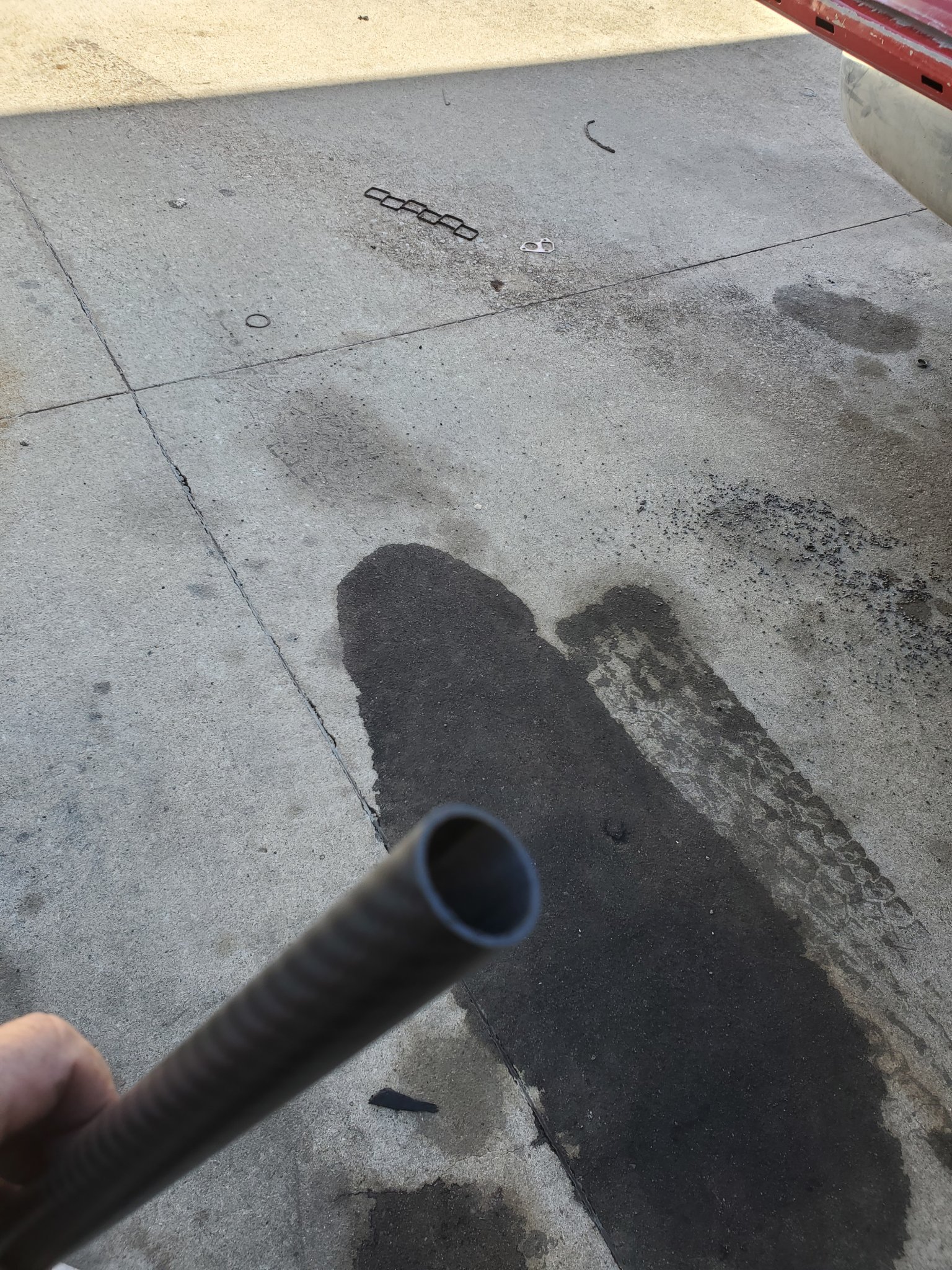

Now after a second look of the OPs photos, the barrel doesn't even touch the CF tube except for the extreme ends
and then only on some secondary fittings. People have been hood-winked by the lure of high tech CF !! LoL
