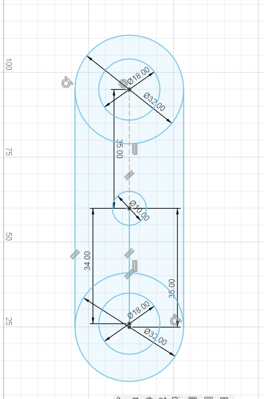

I'm working on some much needed in community aftermarket PSL extended buttpads and cheek rests. I do want all the modifications to be reversible, but only have 2 stock samples, so wanted to see if any of you with PSL could verify my measurements. It seems that at least on my samples the holes for springs (18mm in diameter) in the buttpad are not symmetrical (one on the bottom being 1mm closer to the central "hole").
