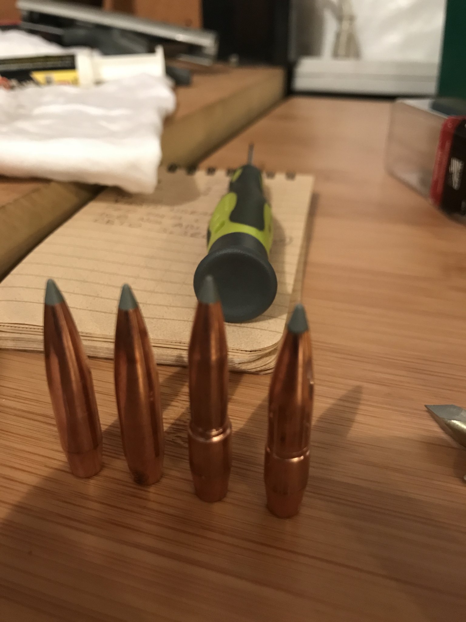

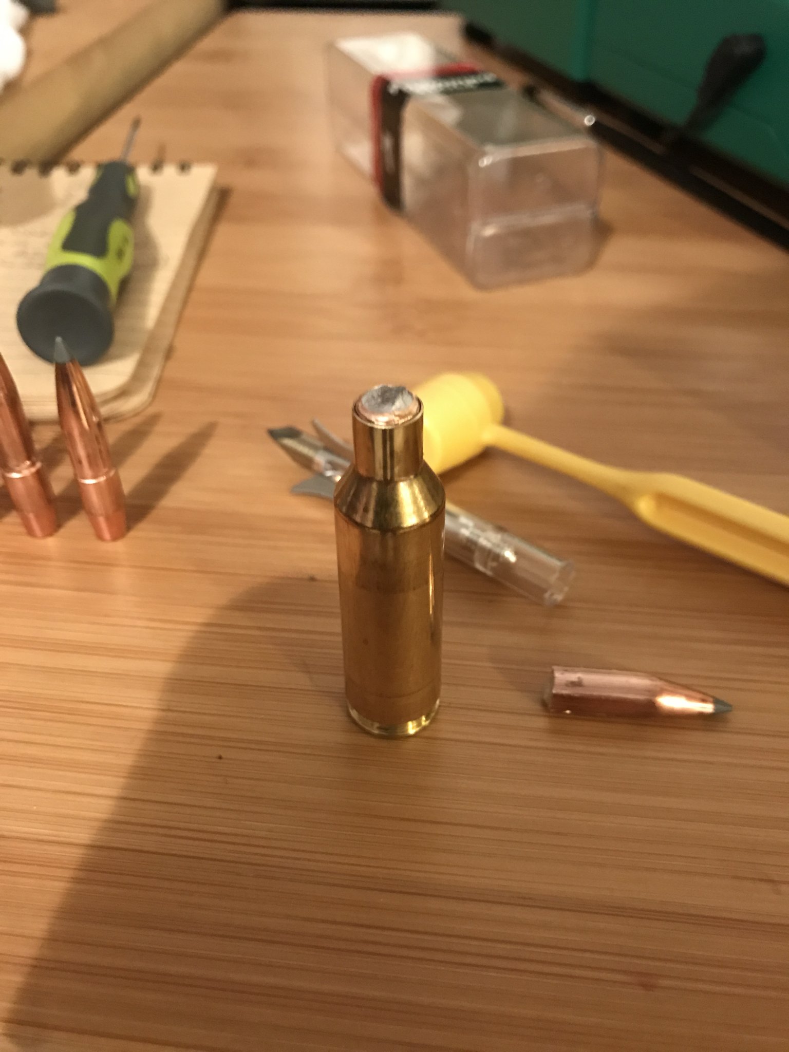

So long as they dont come out looking like these...LOL
